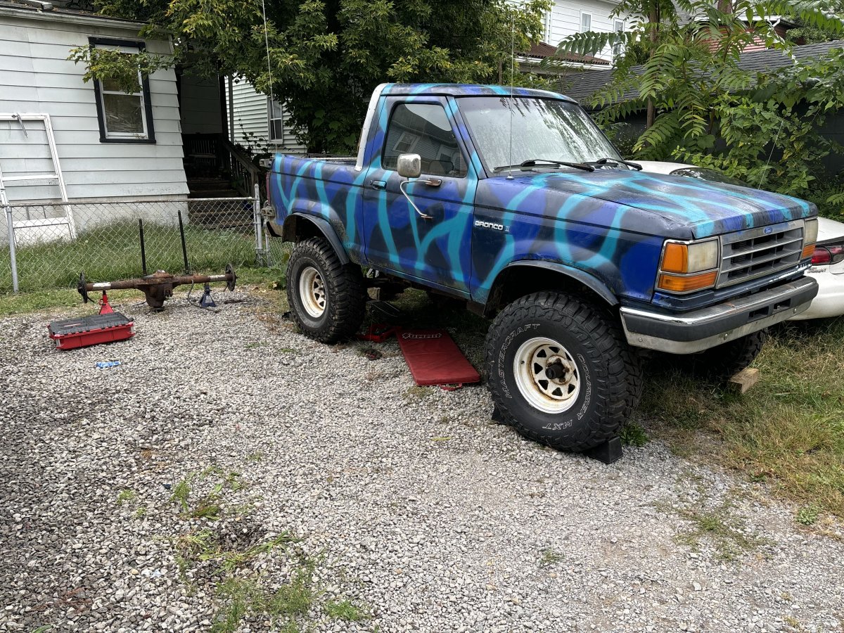

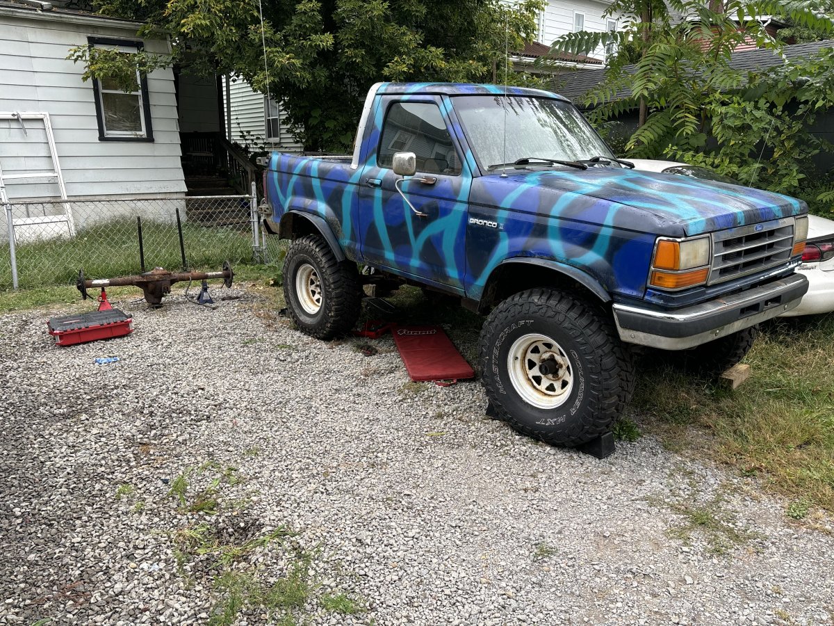

Now, it has 5” of suspension lift and a 2” body lift. So kind of similar to what a 6” suspension lift will get you. I’m probably lighter than a Ranger, but I do have the 4.0 in mine since I did the swap so we are equal motor-wise. I have to run the tires at about 10-12 psi on the street to wear 80-90% across the tread. 32-35 psi would rattle your teeth out with the ride and I was only making about a dime sized contact patch with the road. If you want to check how you’re wearing, draw a chalk line across your tread and drive across a parking lot. You will see where the chalk wears off and where it doesn’t. Adjust your tire pressure until you’re wiping most of the line off the tread. I should do a video on this one of these days.
Anyway, so now that I’ve explained all of that, guess where one of those tires needs to be in terms of tire pressure on a 7” wide rim? 5-7 psi. I’m not sure I’m comfortable driving on the street with those numbers. Maybe. I know I wasn’t happy with that number and I was originally not super excited about the 10-12 psi either, but I liked it a lot more than 5-7 psi. I really didn’t want to go to a 10” wide rim on a truck that does get driven off-road and a lot of aftermarket sizing at the time ran either 8” or 10” wide. Your results may vary. But I’d probably consider aftermarket rims and change the backspace to get where you want over spacers.
The reason I’m going spacers on my green Ranger to use a stock Explorer rim is because I’m trying for a bit of a sleeper vibe. It’s lowered, 5.0 v8, AWD. The exhaust is a little louder than it should really be for a sleeper, but with aftermarket rims it would really start to stick out. 18” Explorer rims and smaller sidewall tires give me a little performance boost in cornering but make the truck appear like I straight piped it and put Explorer rims on, not turned it into a beast.
Oh, and here is the Choptop…

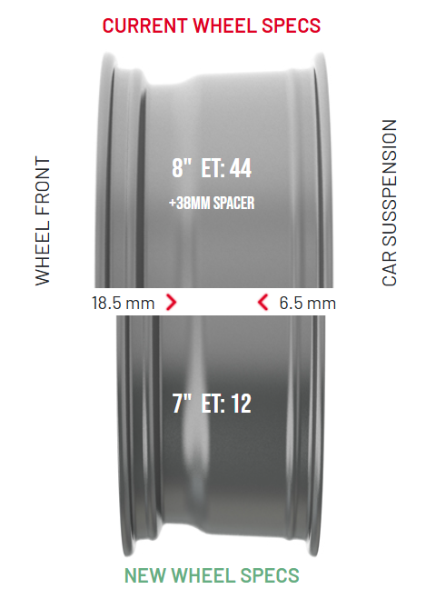

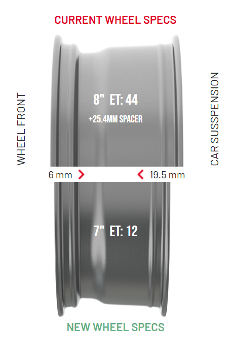

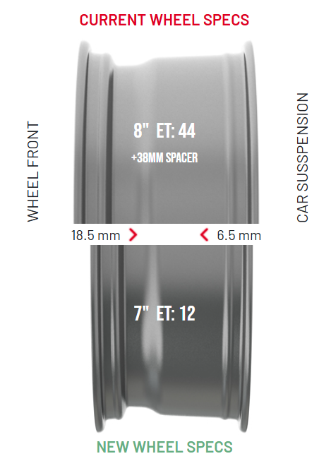

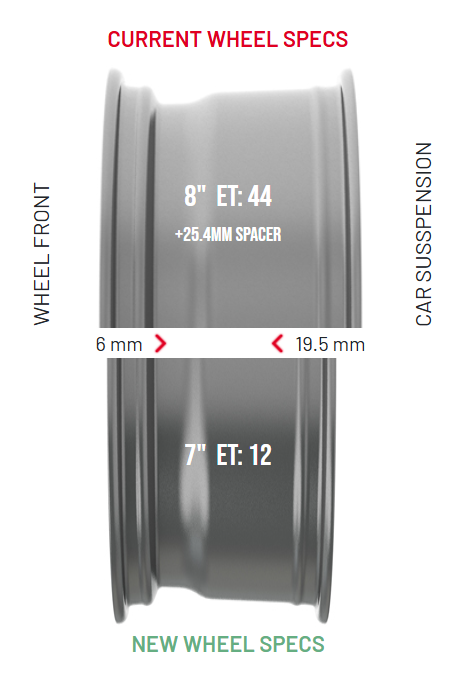

Are you trying to achieve the same outside edge position or the same center line position? If you want the face of the wheel to sit in the same spot, you probably want a 1" spacer. If you want the center line in the same spot, the 1.5" might be about right.
This link can help visualize offsets and spacer sizes. https://jr-wheels.com/et-calculator
stock vs Ex 18x8 w/ 1" spacer
stock vs Ex 18x8 w/ ~1.5" spacer
Actually a 32mm spacer would have the center lines of the wheels match, that converts to about 1.25 inch.
A 20mm spacer would make the faces match, that converts to about to 3/4 inch, but may be too thin for a bolt on spacer. They do sell them, but would probably require trimming the wheel studs.
