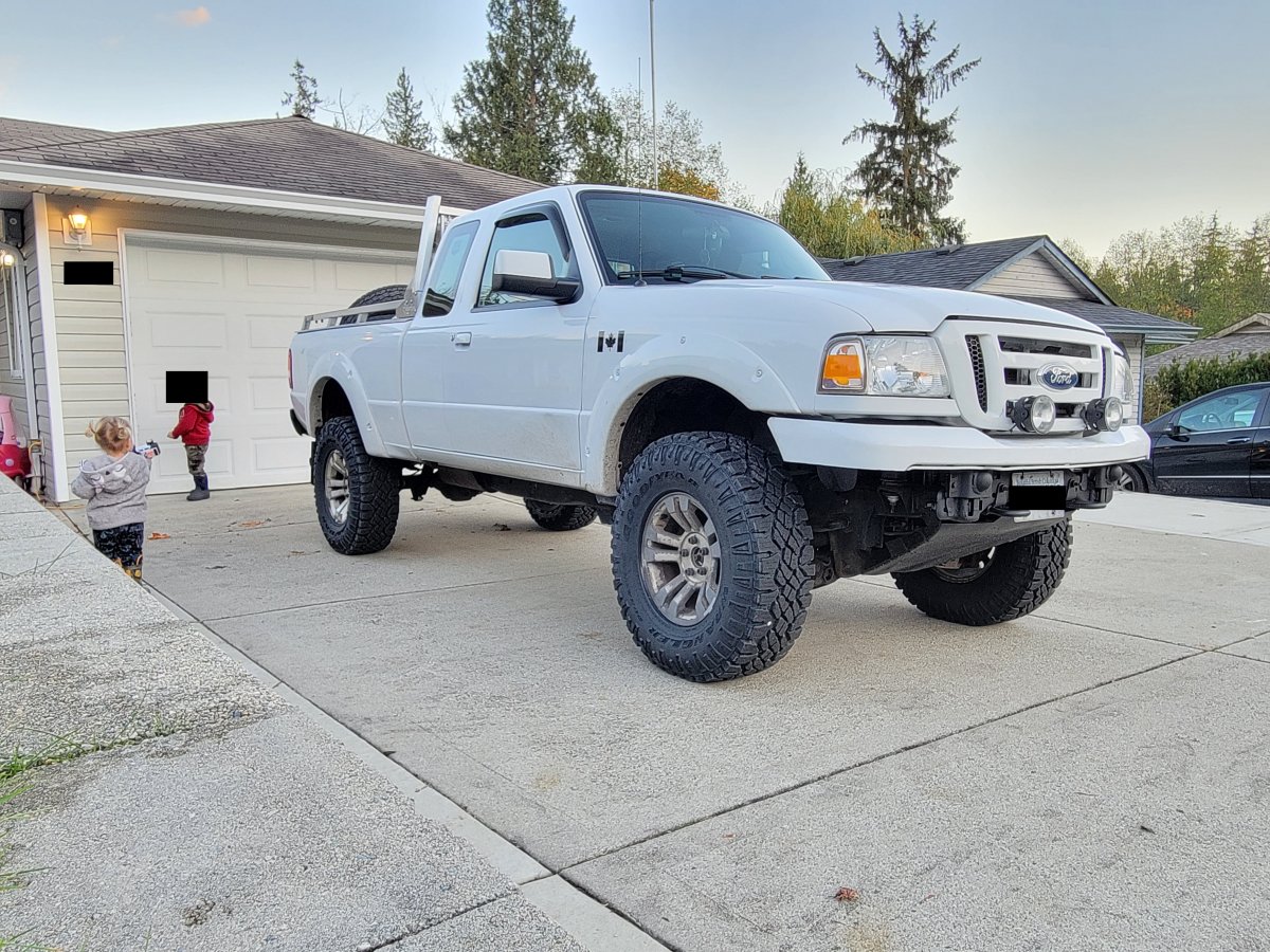

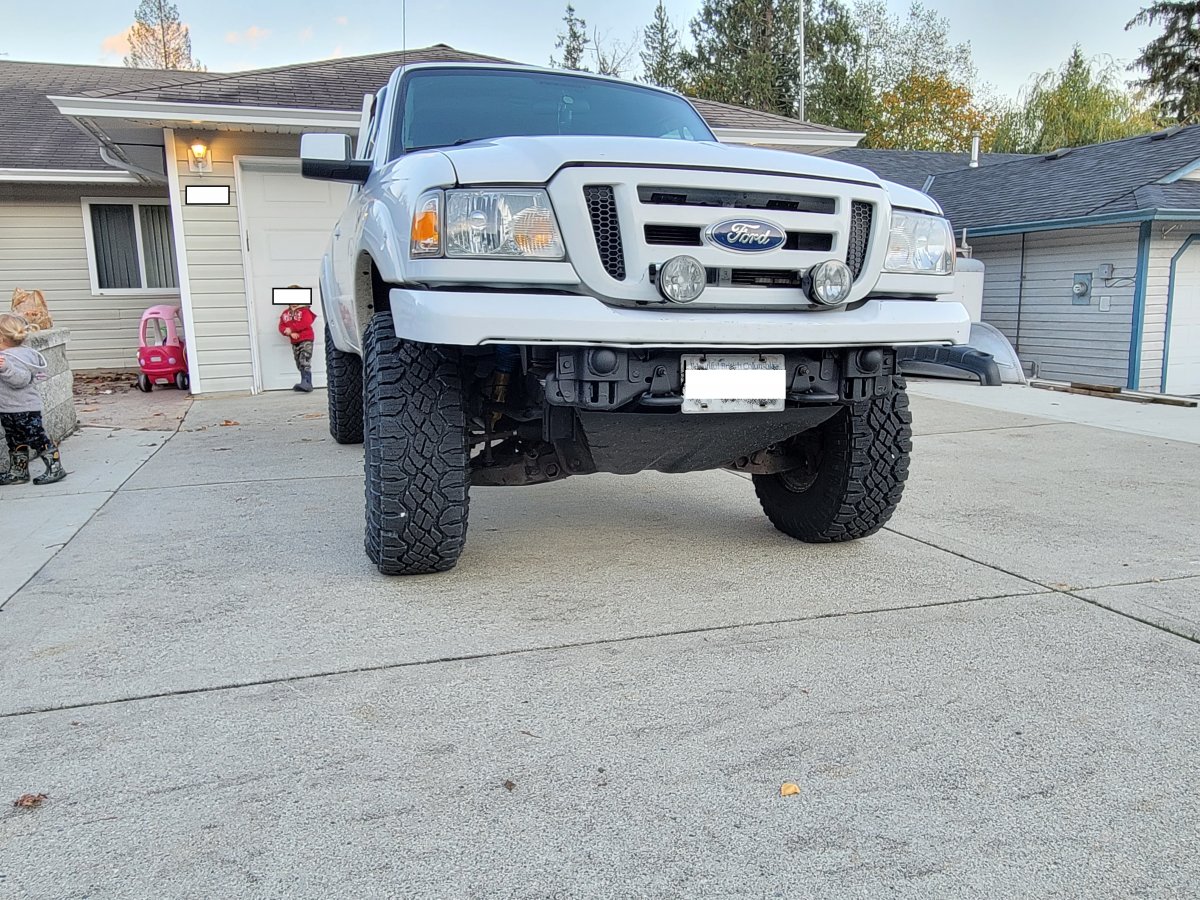

Installed 285/75/16 on the stock 16X7 rims of my 2011 Ranger.
They rub a bit on the sway (stabilizer) bar. I would like to put some wheel spacers on to give it a wider stance and eliminate the chafing.
I can find https://nsor.com/trail-gear-tg140002-2-kit.html or
The difference is 5x4.5 and the other is 5x5.5 ? does that represent distance between lugs?

The 4.5 v. 5.5 refers to the diameter of the bolt circle. So, the short answer is those spacers will not work for you. You need 5x4.5 - 5x4.5. I would also suggest not as thick as 1.5" but if you go less you will likely need to shorten the lug bolts.
