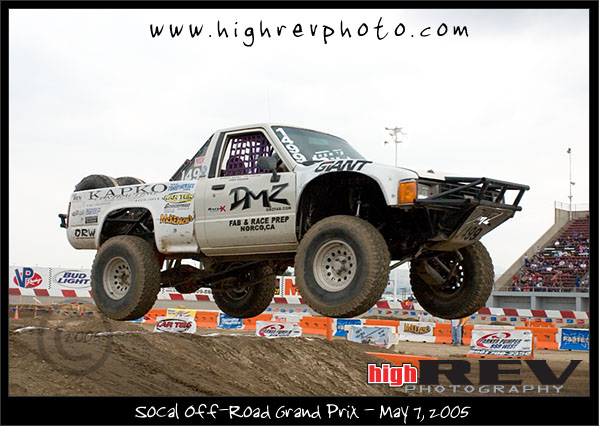

Agreed on frequent tourquing. Ran a 1-1/2" spacer on the front of my truck for over 2 years of racing. Checked tourqe often, never had a issue.
