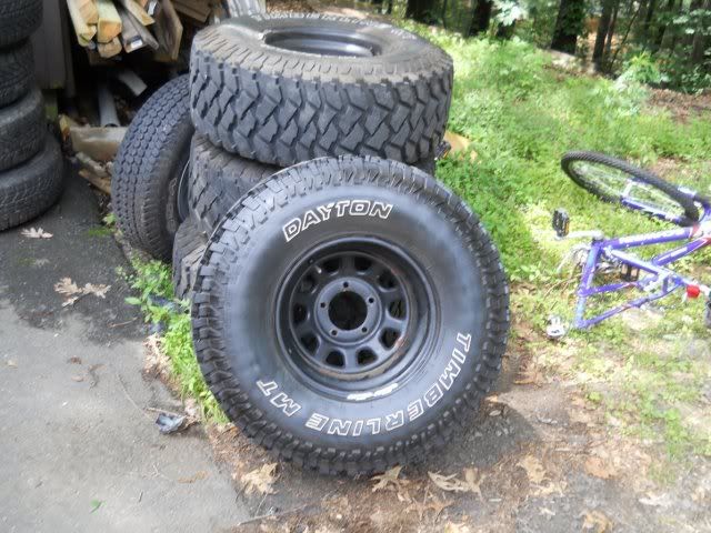

Okay found a pretty good deal i think, dayton timberline M/Ts, i know they are discontinued,
4 33x12.5x15 tires with about 70% tread left mounted on black 15x10 d window type wheels.
The wheels are 5x5.5 but come with adapters that are 5x4.5. is it okay to run these adapters, will it do any damage?
Also are these decent tires? I will only be spending 400 on the 4 tires, wheels and adapters. Does this sound like a decent deal?
by the way these are the tires and wheels
They look to be in good tread. Only problem I know of with adapters/spacers is extra bearing wear.
sas time lol j.k i dont see a problem running adapters just check them and make sure they are tight after 50 miles or so

how thick are the adaptors? and whats the offset and width of the rim. further out will kill bearings a lot quicker.
