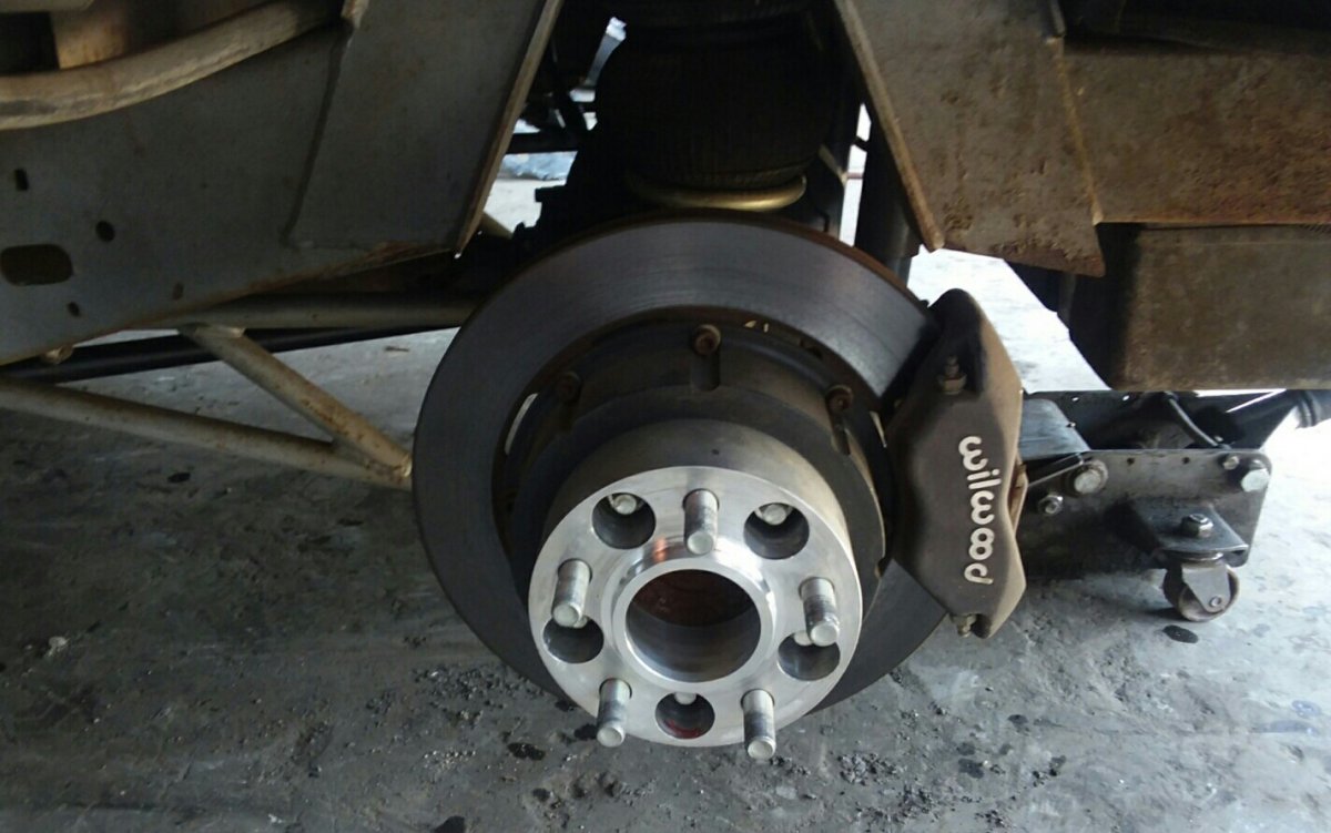

Spacers can be perfectly safe, but if you run spacers, don't buy a set of cast or $30 fleabay or Amazon specials. I had a cheaper set of machined 2" spacers on my narrowed 9" reared and they eventually broke into pieces. A couple years ago I finally invested in a set of billet rotary forged hub centric spacers for the rear. They were expensive, but are incredibly strong & I'm not worried about them falling apart.

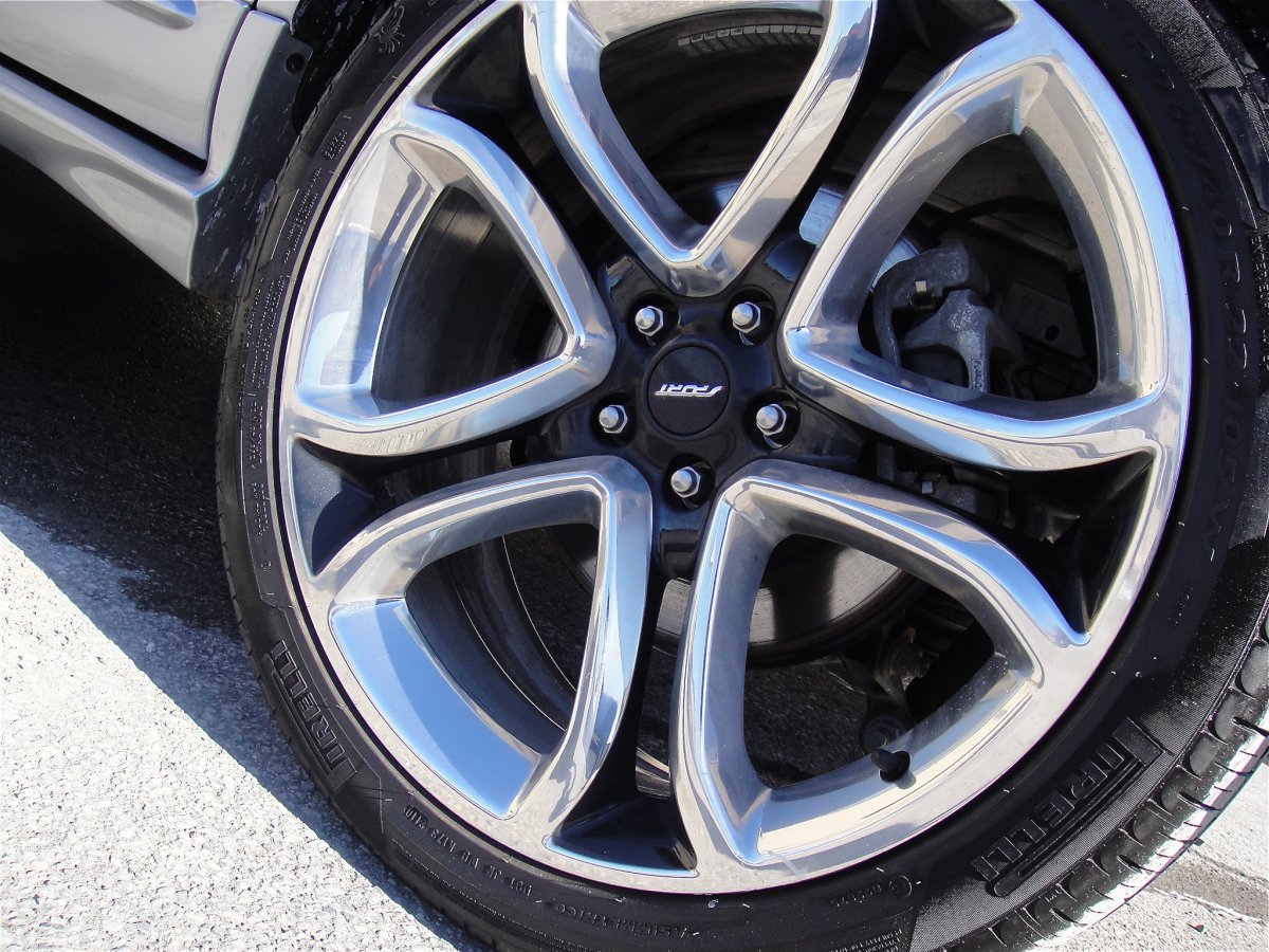

Got any pics of these Edge GT wheels on your Ranger? I really like the Edge Sport wheels and want these or something very similar when I get to that point.
These
I ment new edge as in new edge mustang wheels 1999-2004 body style,
