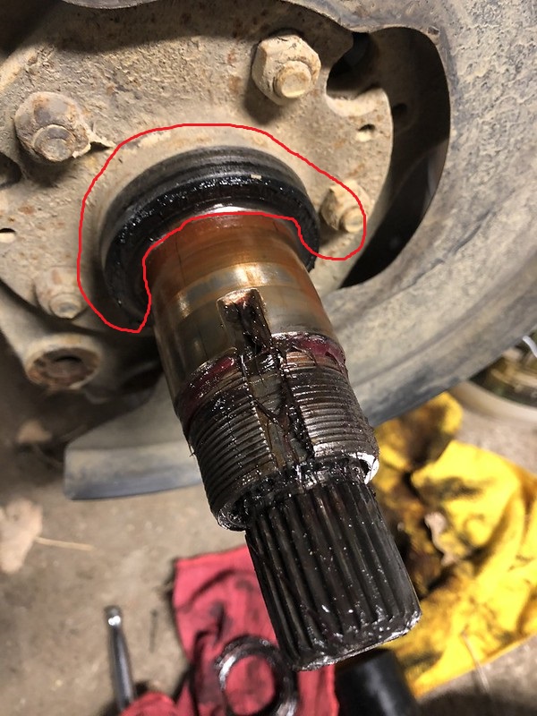

Kinda new to wheeling with water. My first time out (in Ohio) I got water in both hubs and really I don't think I was in that much of water for that long to do this. The weird muddy brown goo is only in the wheel bearing area so i suspect it was the seals on the rotors that leaked.
Any tricks to help this or just par for the course? I am wondering if a speedi sleeve would probably be the way to go...

The wheel seal appears to be doing it's job well... the spindle shows no sign of leakage.
My vote is for it coming through the hub...
Is it common for a leak at the hub to gravitate towards the inner bearing? The other side was worse but the inner bearing also had a lot more of the funny red colored mud/grease than the outer too. Bearing nuts/locknuts and the lockouts are spotless on both sides.
I used the best o-rings from my hub stash, they are round so figured they would be ok... I will probably try to get new o-rings now as a precaution.
This is the area your wheel seal rides on... I always clean that up really well, make sure the seal hasn't worn a groove in it and grease the lip of the seal. I'm betting this is where water came in... it looks a little rough.

One would think if the wheel seals were allowing water into the bearings... it would also leak grease onto the spindle. Yours look really clean.

That is kinda what I was thinking on the seal area, if a speedi sleeve would help. I emery clothed the seal area when I put all together. It holds grease fine which is kinda all I really intended for it to hold at first.
