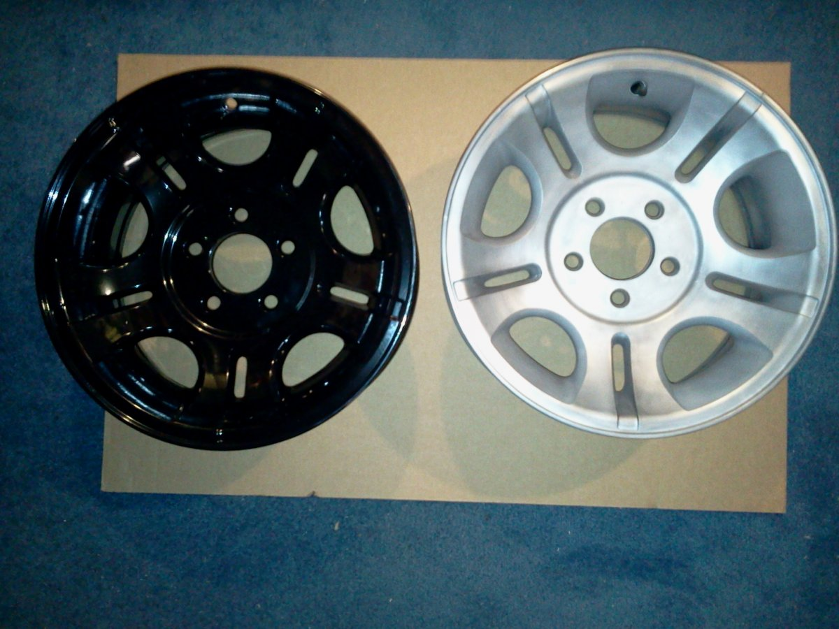

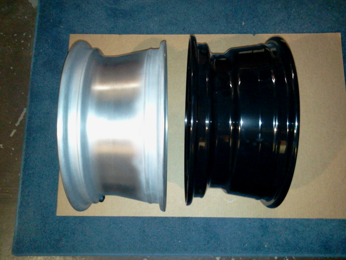

Not al 15 inch wheels will fit... maybe even some 16 inch. Ford went to 12 inch rotors I believe in 2002 and some wheels would have enough clearance for the caliper.
Example of 15 inch wheels... one is a bell shape while the other has a step. The one with the step will clear the rotor... the other not so much.
Did you repaint this wheel?
powder coated, it was stripped to bare metal and glass blasted first.
the silver one was stripped, then only the bead sections were blasted.
it's still uncoated bare metal.
