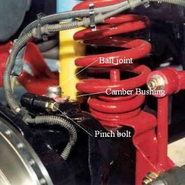

It could. It depends what he was adjusting. Caster and Camber adjustments are (mostly) independent of each other from side to side. One side may have already been within the range (in spec) before he started. So, only the side that was out needed adjustment. The Toe adjustment is much more related from side to side, but not entirely.
Check out these articles in our tech library. They apply to both Rwd and 4x4 trucks for the model year of yours.
