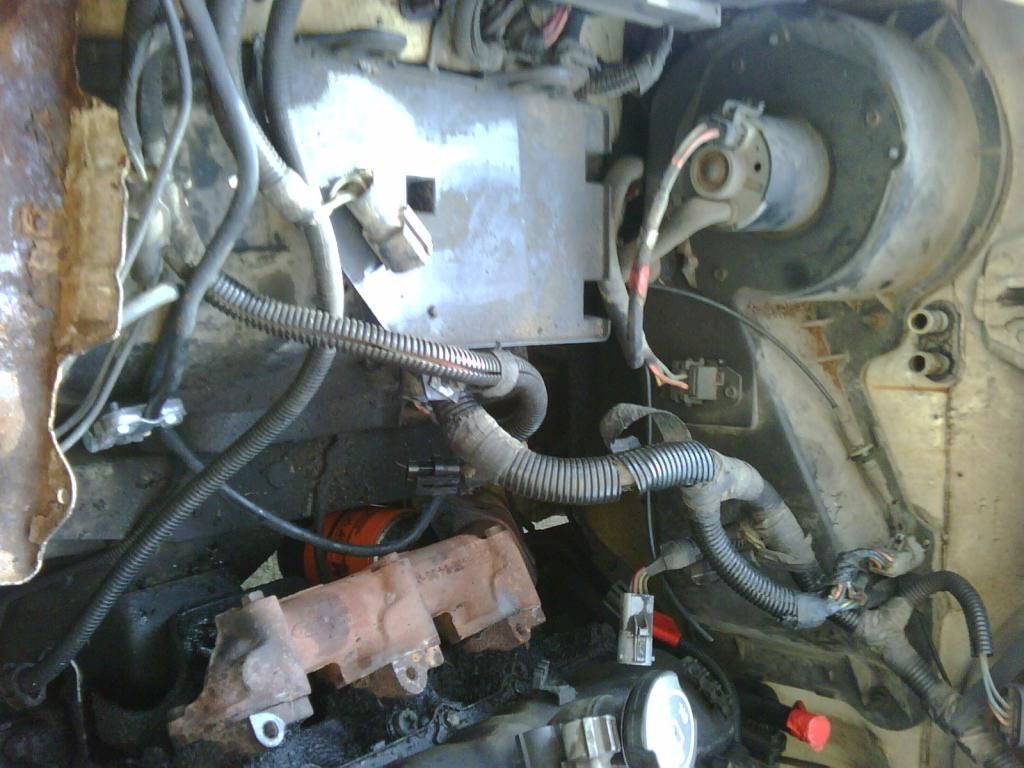

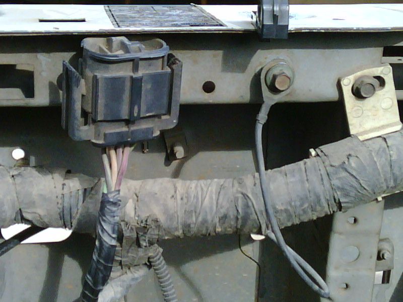

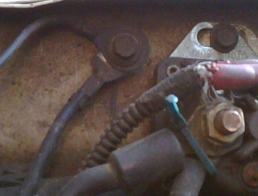

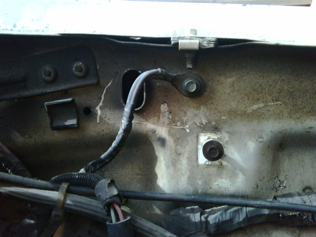

Sorry, got my driver side grounds/years all mixed up.
Pass side
Driver side
Rad support
Blower
To me, a big clue is you have power back-feeding the blower, key off, brakes on, turn signal selected. For anything to back feed like that, the ground terminals have to be touching or joined, like the driver side shows, AND not grounded to the chassis. I wonder if the blower runs backward when it backfeeds.
There are also probably grounds by the parking brake, and by the inside the cab fusebox (I can't remember if the 90 has one).
Pass side
Driver side
Rad support
Blower
Your pictures showing the grounding locations, are the grounds that I cleaned up, by taking them off and using abrasive emery cloth to sand the contact surfaces down to shiny bare metal, behind the terminals..
Then, I sanded the ground terminal connections on both sides with abrasive emery cloth, and put oil on the bolt threads, before bolting them back on, again, very tight..
Being the blower motor is enclosed, I don't know if the blower runs backwards or not, when it backfeeds, as the blower motor only starts and stops for a split second, between each clicking sound that the turn signal relay makes..
When I held my hand over the defroster vents, before, I wasn't able to feel any air blowing out, when the blower motor was doing this..
