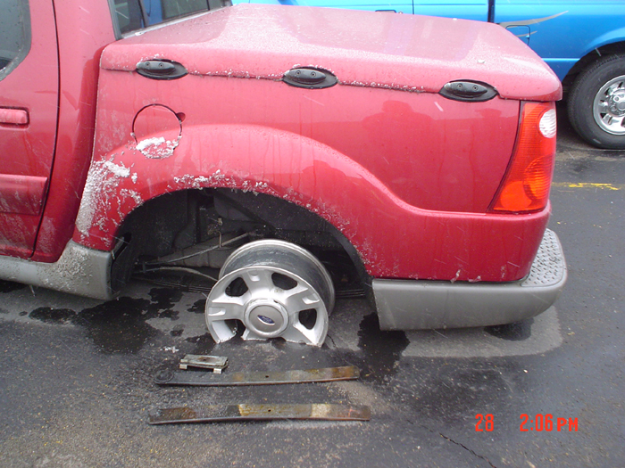

Seriously, with a manual tranny it doesn't matter much but you should do what the manual or AllanD says.
Automatics have issues being flat-towed because some of the innards are spinning but the pump isn't turning to lubricate them. This is why you should leave an automatic in Park and put the t-case in Neutral.
Park will be fine.
If you could cut a tire to fit that rim it would look really cool, like it is sunk in the pavement. :icon_twisted:
With the 5 speed I wouldnt think it would matter, if the front hubs are unlocked then T case in 2wd is fine no motion to the T case, tranny in neutral, the rearend is free rolling. I dont see any problem.
Pic is from the Sport Trac site. That actually happened the way you think. Dude tows his Sport Trac behind a large RV and forgot to take it out of Park.
