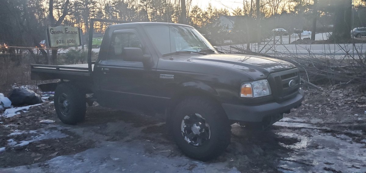

Sell ya my old truck. Just needs some stupid stuff done for a sticker.. 2010 2.3 manual 140k, new 4.10 gears & Yukon lsd, flat bed, good mud tires... you wanna drive up here and get it (just north of Portland maine) id let it go for 1250. First owner was an old man from NH that had it dealer serviced, im the second owner.. and while I didn't have it dealer serviced I drove it like the first old man and changed the oil every 5k.
Its a good truck. Had all intentions of keeping it forever, but "new" hobbys required a bigger vehicle.
