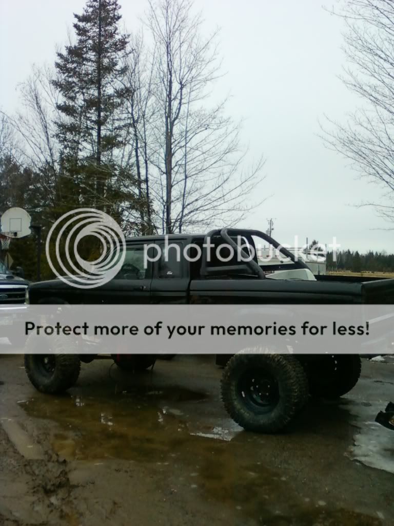

as im getting deeper in my build im doing a little of everything at once so i dont get burned out on it. im trying to decide what to do about the rear leaves, i want to keep it about an inch or 2 lower than it is now and only want to use 1 block....Suggestions?
for referance:
Chevy lift springs, its like the 63in leaf swap but with more lift
Frankenstein your own pack. More leafs=more height
ive seriously considered this but i want to find a main leaf with a pretty big arch. the bigger the arch i can get, the smaller the block i use has to be.
so what truck has a big arch stock? are there any fullsizes that has a spring under design?
google dakota leaf swap.
