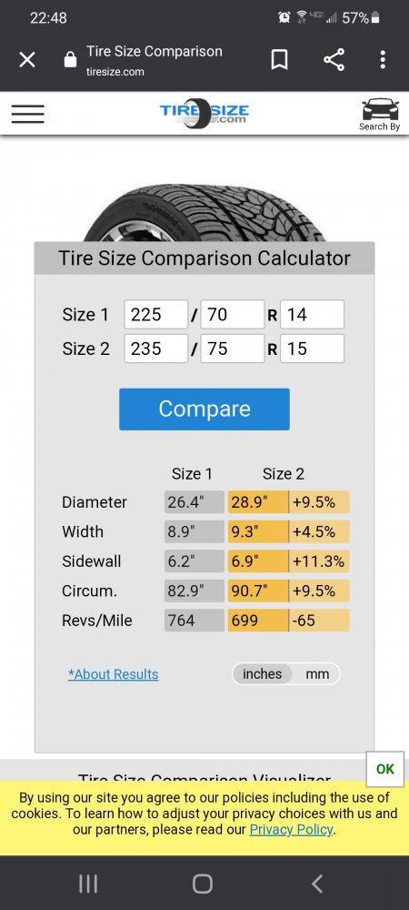

With that info, you can go to a tire size calculator online and get the diameter. For example;

To follow up on Eric's earlier post, 9.5% difference in tire diameter is a big deal, and if you want to keep that difference from stock you should re-gear the diff to get your performance back.
I would like to but doing a rear diff gear change seems like it is very particular about how its done that I probably don't have the skills to complete.
