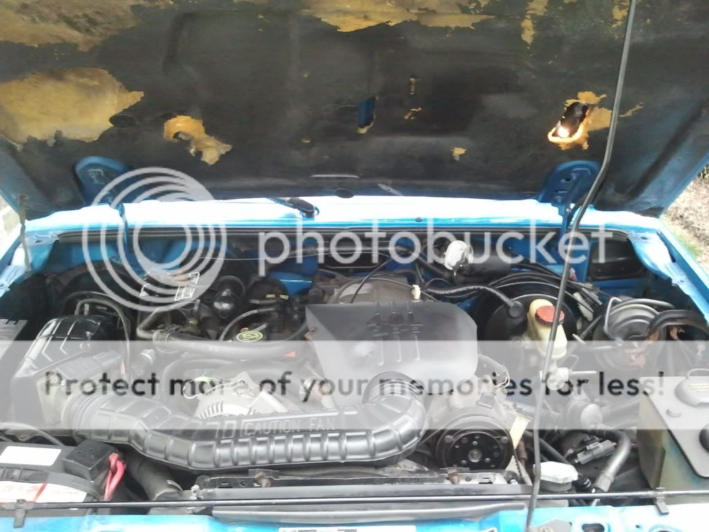

yep, your correct I just got the truck. Got it last summer. The truck has 136,000 miles on it now...
Before I got it, it sat in my granparends garage for a few years, before I got ahold of it they took it to a shop and had everything look over and replace if needed to be.
The heat works wonderfull nice and hot for the winter, blower motor runs good, every setting works defrost, floor, panel, ect. Its just that theres no cold air just whatever the air temp is outside is what blows through.

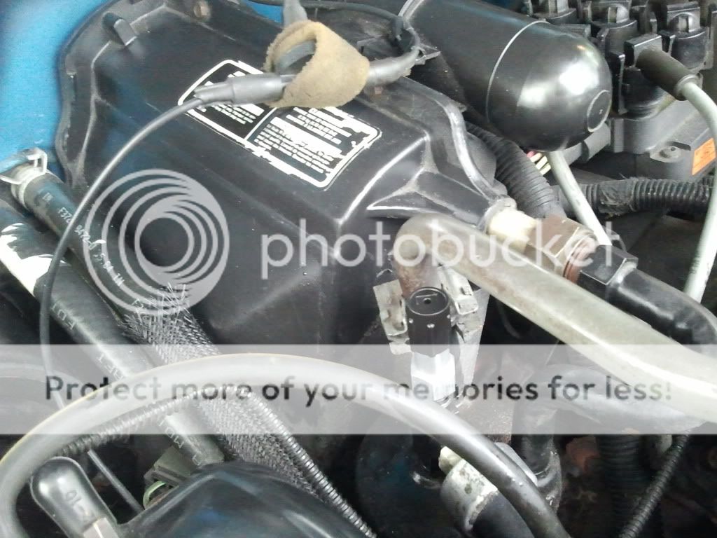

I took the little cap off the a/c receiver drier where you would put that can of R134a stuff, pressed down on the nosel and nothing came out.

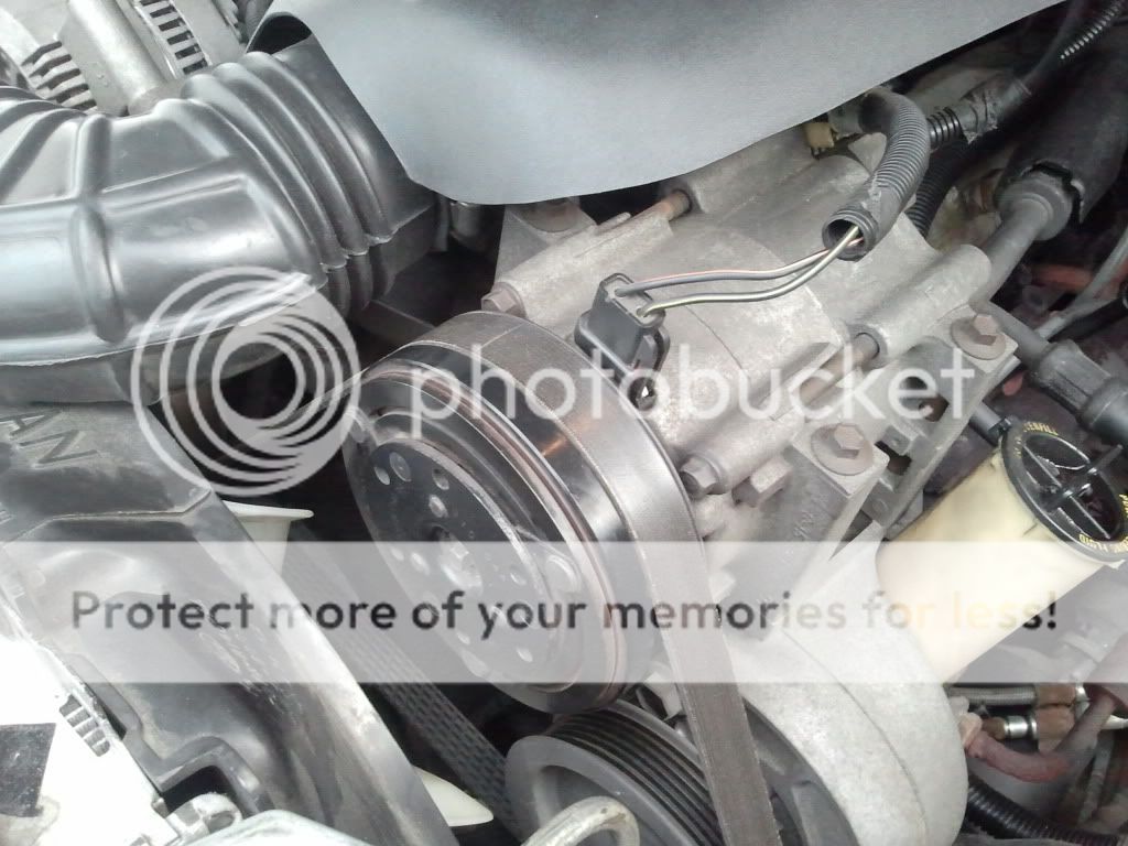

also my compresor doesn't engage when I turn the a/c on max with the button pressed on.

You're all forgetting that this truck is a 1992, which means it's an R12 system. You need to check if it's been converted to R134a already. If it hasn't you need to either convert it or start looking for some hard to find, expensive R12.

^This. If it was converted by a professional, it should have a sticker on the A/C box near the firewall, or on the radiator support. Another way to tell is by the fittings.
EDIT: The sticker will look similar to this.
R12 substitutes are available for small problems (we use "Freeze 12"), if you have to replace much you might as well convert.

everything looks to be is fine shape, also the Compressor won't turn on. Looking at buying a new compressor for $185.00. It says "its R12 - R134a compatable
It looks like the adaptor fittings are already installed, so the truck probably has been converted. If you're very low on refrigerant, the compressor is not SUPPOSED to turn on. You probably don't need a new compressor. I would replace the orifice tube. If the old one has lots of metal shavings on it, you'll probably need a compressor among other things. If it looks good, just put a new one in. Replace the accumulator (add some Ester oil to it, and wait until you're about to vacuum and recharge before instaling). Remove the compressor, drain the oil from it, and add some fresh Ester oil to it. It is a good idea to replace all the O-rings. Then vacuum and recharge.
