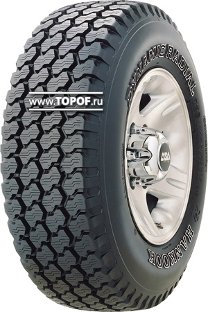

Hankook dynamic 235/75

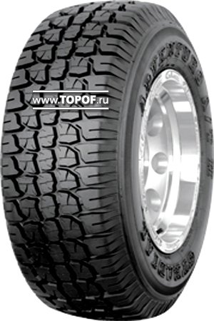

i was thinking about gt radial adventuro at II.
way cheapier, but i havent got good feedback from people using them. seems like they wear down fast. and i carry heavy stuff so thats not good, even the salesman was like... i dont think they will last with constant loads.

hankook seems like a low quality. :dunno:

I'd lean in the direction of the RVTs or the Hankooks. They look like the most suitable tires for your conditions there (lotsa mud, yes?).

I go with either the Destination A/Ts or the Hankooks. I've never ridden on the Firestones but given the abuse I've seen them take (comparing tread condition and alignment angles) they seem to be good tires.
I've been selling Hankooks for years and they always seem to to balance well and last a while. I even put a set of GeoTracks on my dad's 250.
