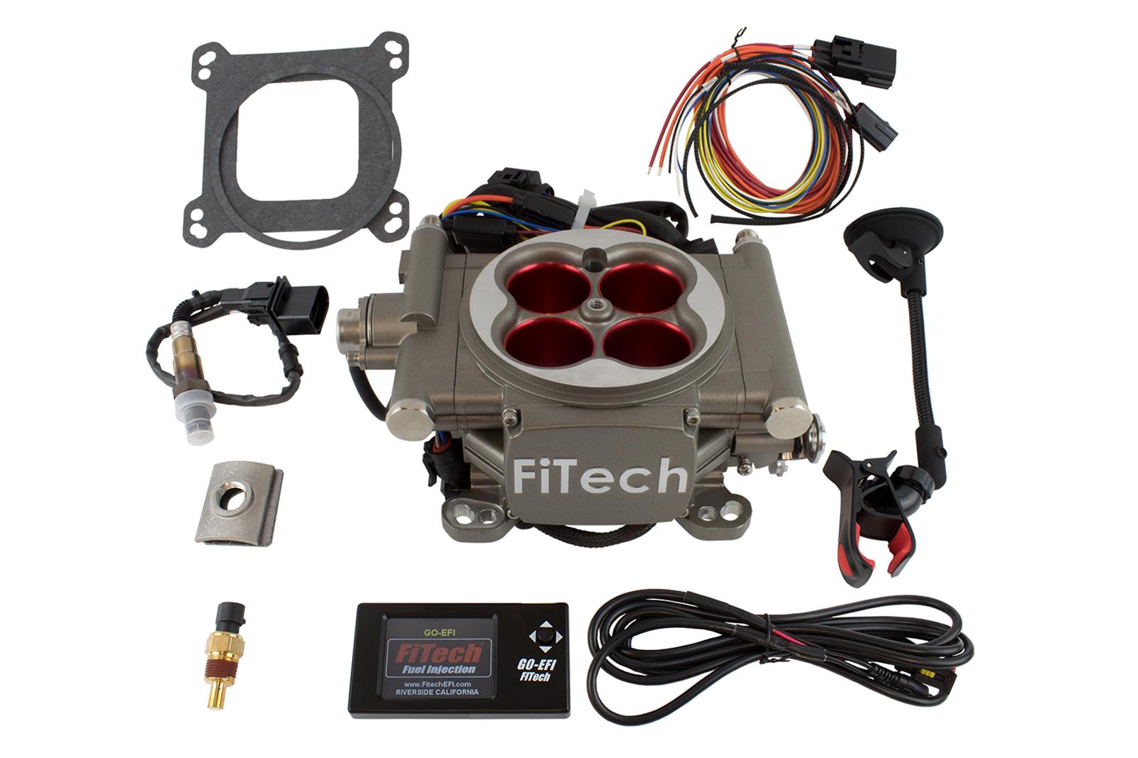

And yeah, all you need to carb an Explorer 5.0 is a dizzy, intake and electric fuel pump. You can also run one of the TBI injection kits that drop in place of a carb if you want. It would use the carb fuel supply and dizzy. If I ever have to get a different carb (and I know they don't really wear out) I would probably go this route:
