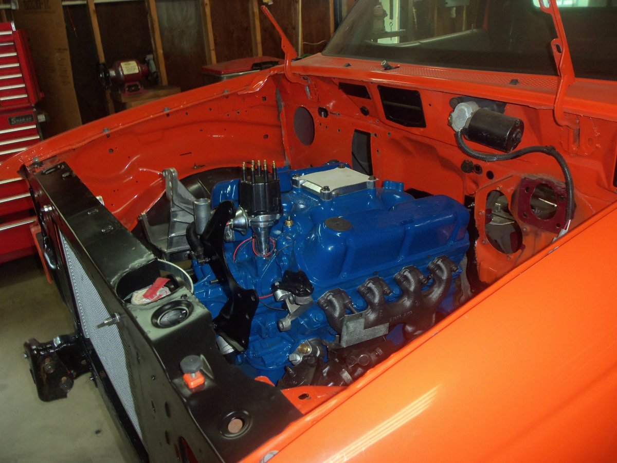

I think we all know that but if the radiator and fan are adequate the temp may stay close to the thermostats spec. My 351 uses a 15" flex fan behind a Griffin radiator mounted inside the hollowed out core support. I reused(for now) the stock temp gauge and it runs around 1/8" above the bottom of the normal zone.
