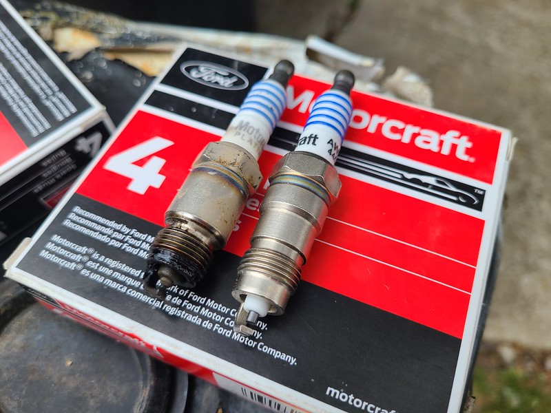

Difference in spark plugs between a '86 Mustang GT and a '87 Mustang GT... note how one seals down by the threads and one seals back by the hex. They are not even close to interchangable. The groady ones are for E7 heads which should be the same as a '94 F-150. Trucks may spec a different one so don't go by that.
Copper plugs for the '94 heads, Motorcraft if you can. :icon_thumby:
