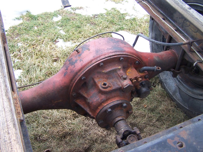

This is basically your only option

I always wondered what the ratios were with the old 2-speed axles. wish something like that was offered now, in a lighter axle
Yes. Shifting to 8.11 on the trail could be handy. Of course there are doublers to put in the drive train. But having that function self-contained in the diffs would be nice.
The problem with a lighter axle is size. There isn’t much room to spare inside an 8.8.
