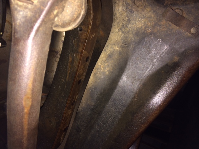

What part is this?
bbbc3
GMRS Radio License
Oct 21, 2012
251
Tulsa, OK
1985
2.8 V6
5"
265/70-17
I was looking over my engine and noticed a pretty decent oil leak. It looks to be coming from around this part or close to it. I just can't recognize what part this is. I have my magnetic wand touching the part in the picture. The picture was taken from under the truck. Its hard to get a close look in this tight area so If the oil leak isn't coming from this part where may it be coming from?
Yup, that's a fuel pump. Mechanical fuel pumps are driven by a lobe on the cam that works a lever on the pump, kinda like an old hand-pump spigot. There is a gasket between the pump and the front cover that seals the oil system, so it could be leaking oil from the fuel pump.

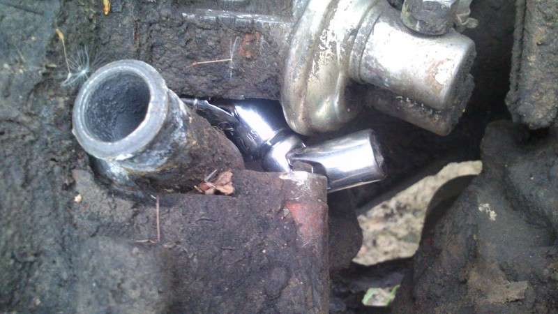

What I did on my parts b-2 to remove the fuel pump;
The other bolt is easy.

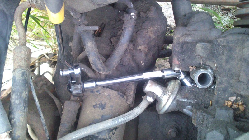

Are you running two universal joint socket adapters? Wow this is going to be fun.... :icon_confused:
Yes, two universals. I have bad knees and this was easier than from underneath for me, YMMV
