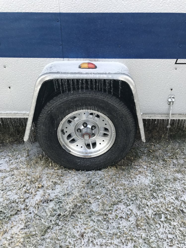

What are all those pointy things aimed at your tire, hanging off the fender?
I thought you had an extreme, like mine. Sorry, @Angry Possum, I confused your truck with another.

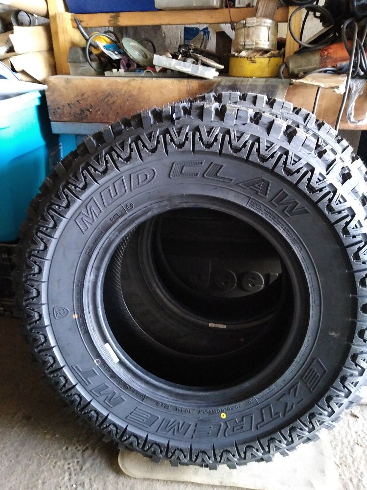

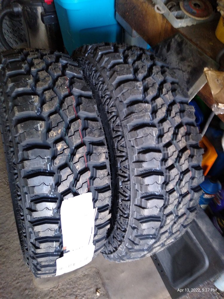

The tires I got are mudclaw extreme mt in 30x9.5r15. they were like 145 bucks each on ebay with free delivery.
Here is pics. Throw those on your truck and it should be plenty of fun off-road
I took that back when we had a ice storm here, one of many icy pictures I took. my favorite was of the windmill with ice hanging off all the blades. Proof that moving water can/will freeze.
