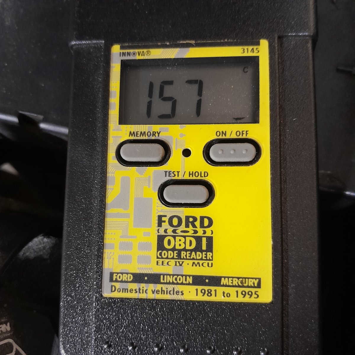

I have an ONDI scanner. It is okay. beats counting flashes.
I have one of the ones that you count flashes. Always hated that, usually had to do it at least twice. When I saw the ones that give you a digital readout, I had to have it. Makes doing all the diagnostic tests easier too, though there’s not much it does.

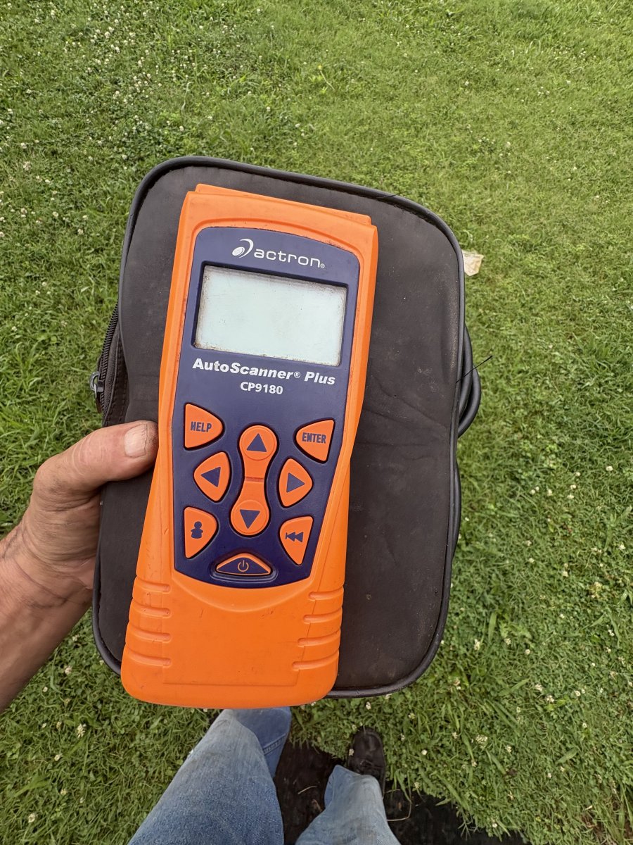

Be aware that Actron is no longer supporting their code readers. I found that out recently when I bought one on clearance and phoned into the help center. There was still real people answering the phone but no more updates of software. The one I bought was up to date enough that I kept it as something similar would have been 3-4 times the price I paid. I have no plans on buying newer vehicles.
I think Actron was bought out and shut down.
