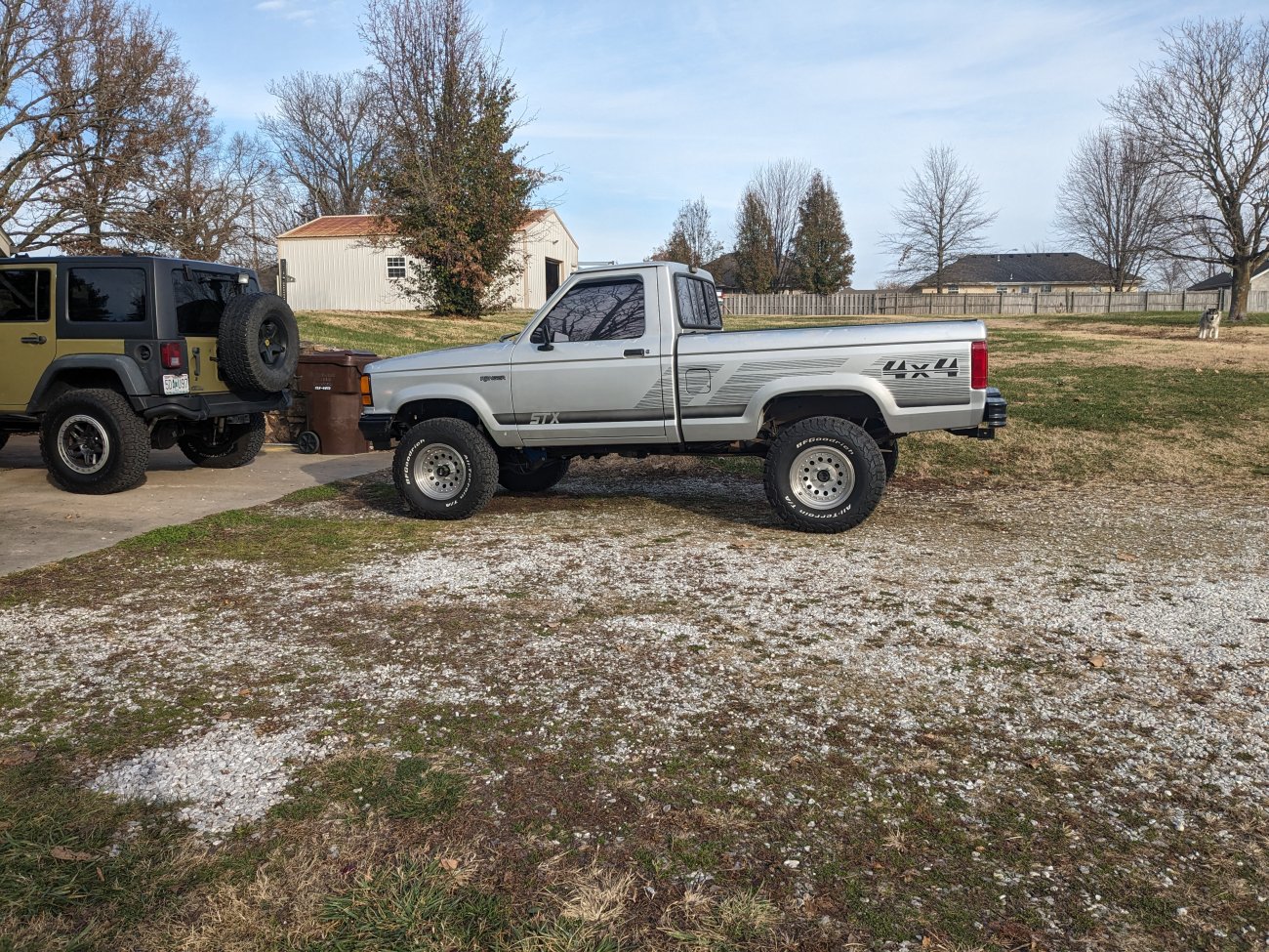

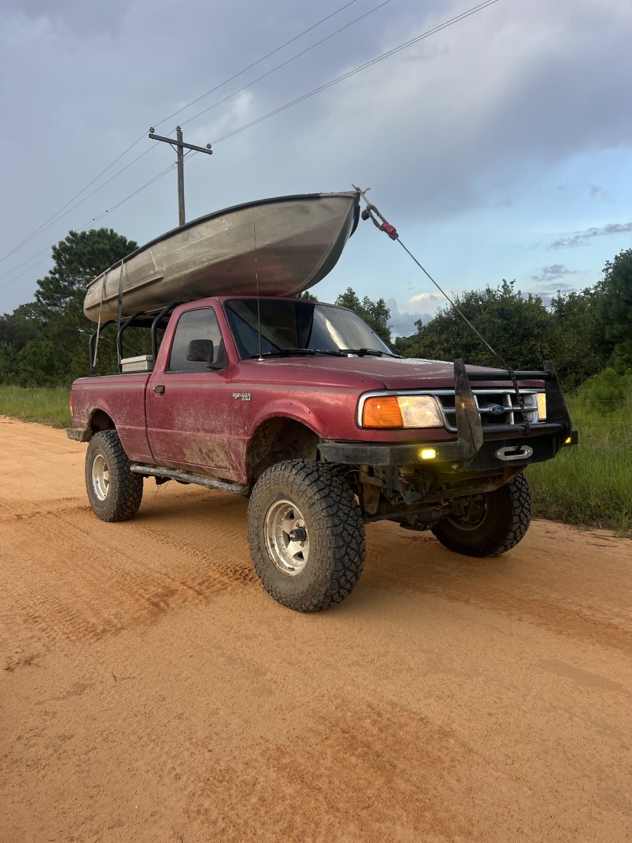

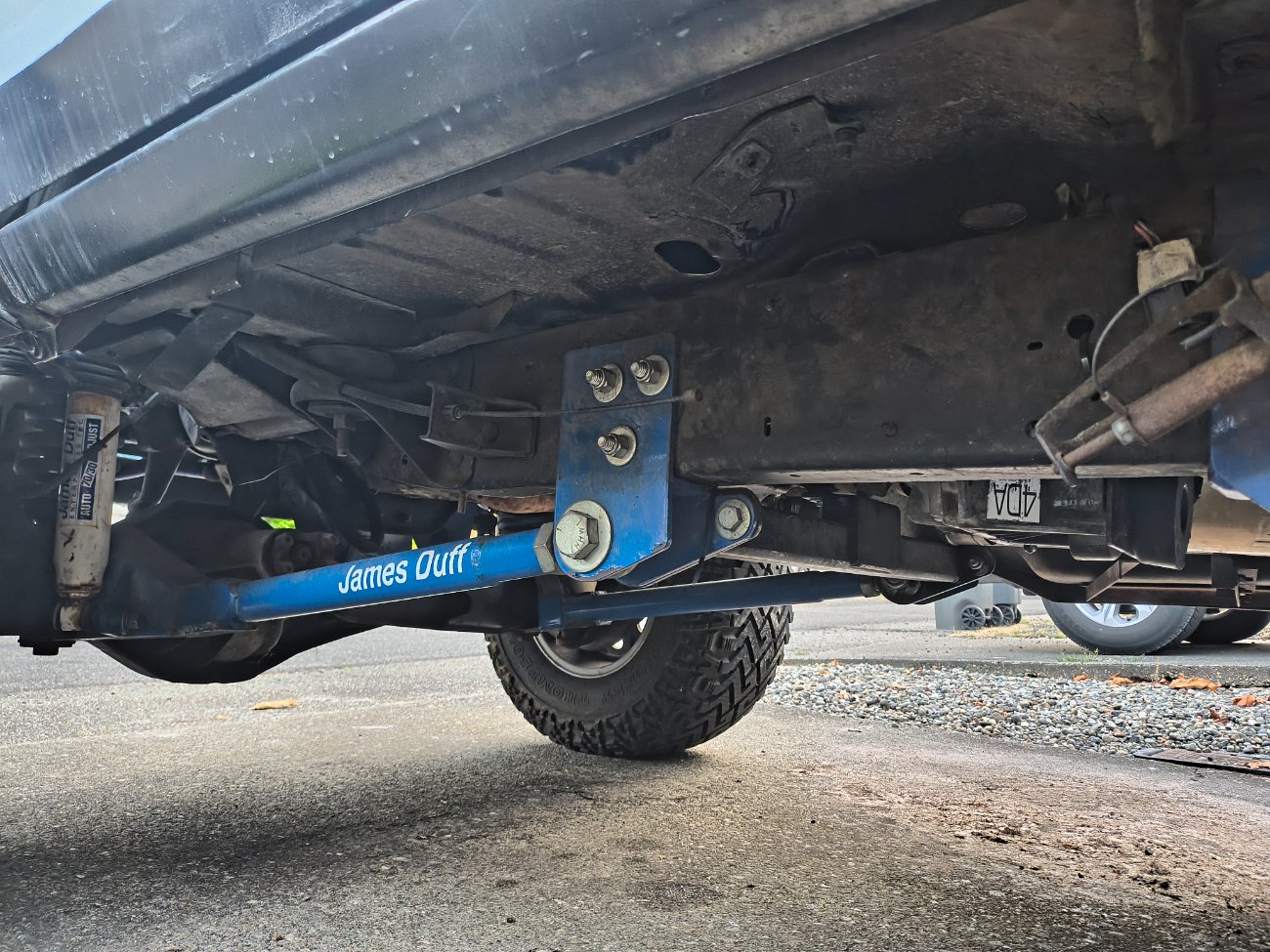

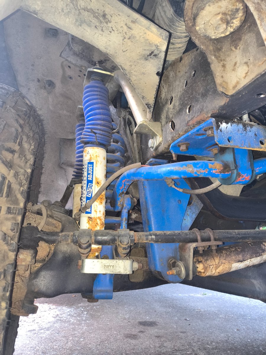

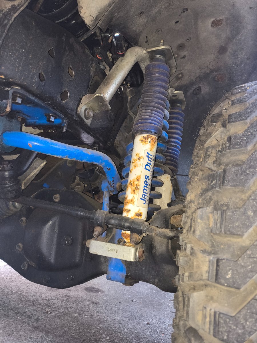

3" James Duff with add a leaf, build quality is great, want to upgrade to better shocks at some point. Sags little in from with the 302, one day get around to working on that.
What is the last suspension lift / leveling kit brand you purchased?
3" James Duff with add a leaf, build quality is great, want to upgrade to better shocks at some point. Sags little in from with the 302, one day get around to working on that.View attachment 123279
Now that is a good-looking truck! What size tires are you running? How old is the James Duff kit?
Thank you, have many hours into it. 31's Lift has been on truck 2ish years.

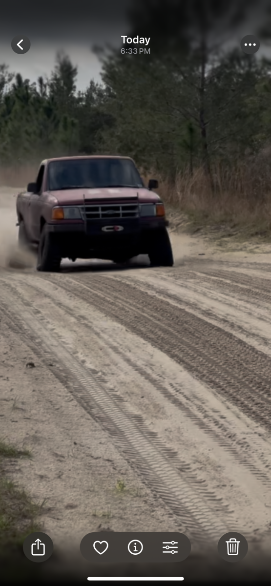

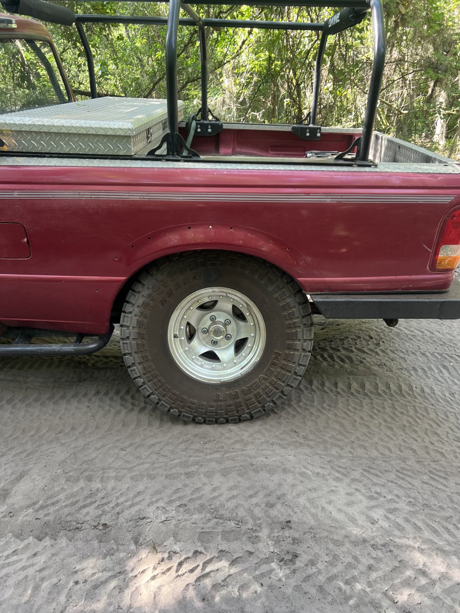

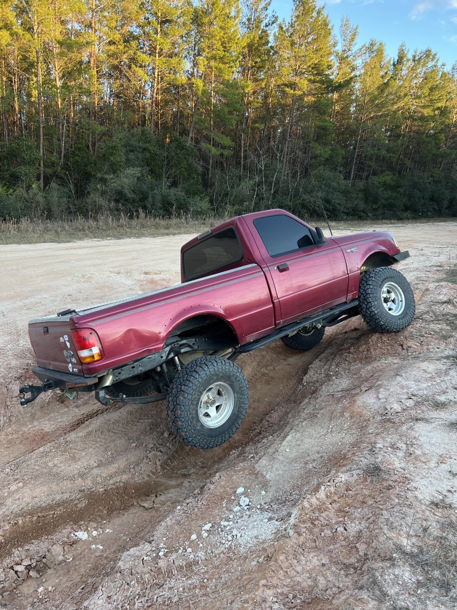

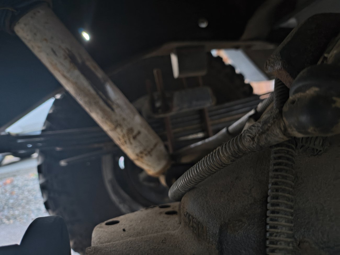

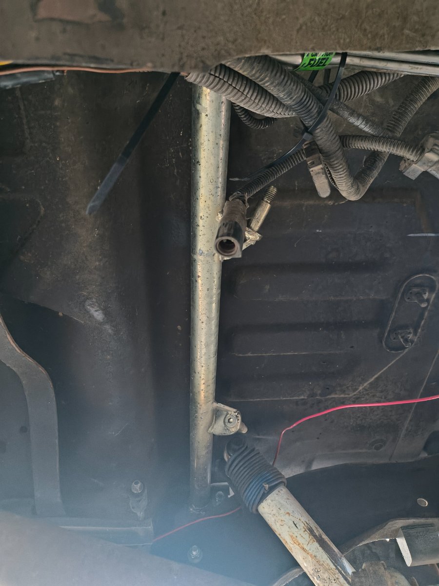

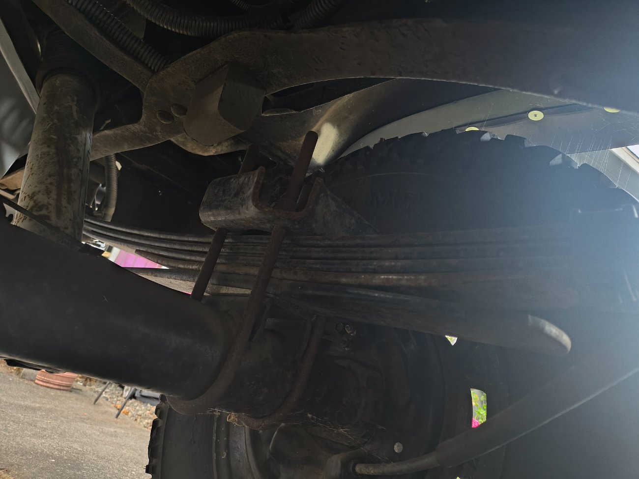

Maybe put an option for “Pieced together”

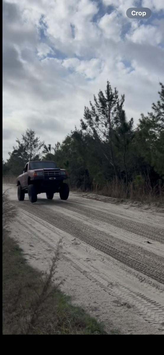

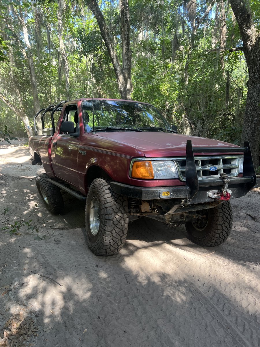

The front is Go Fast Explorers cut and turned beams, radius arms, and 5-6” coil springs which I chopped down closer to 4” I think.
Rear is a 64” Deaver leaf pack.
Front and rear has Bilstien 7100s from Wheel every weekend.
Also has a 3” body lift.
Thing works pretty well at just about everything for how simple it is.

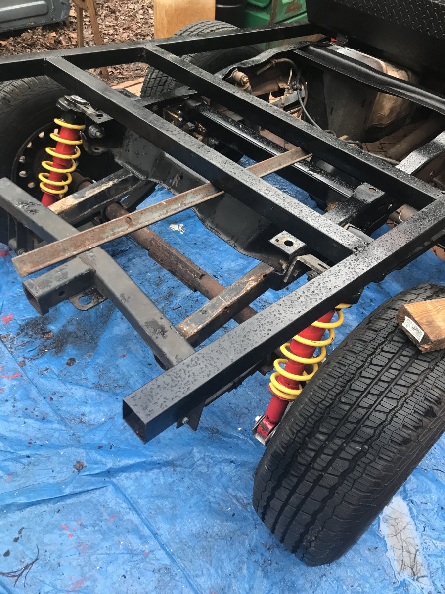

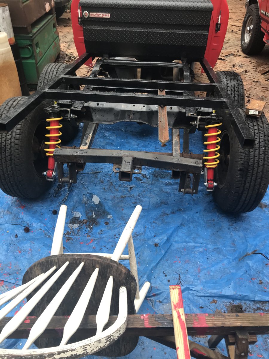

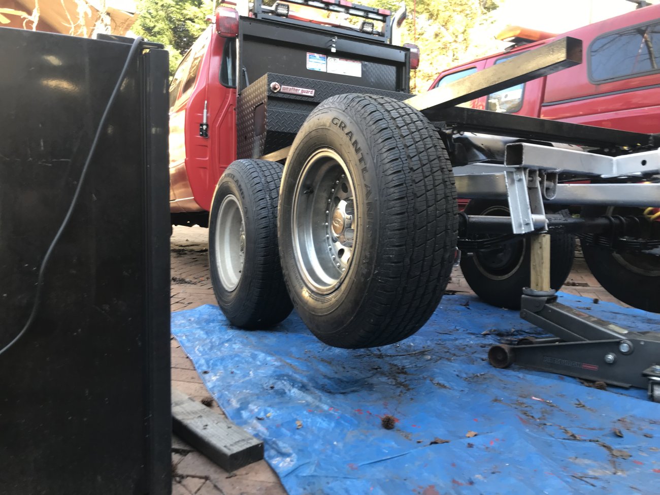

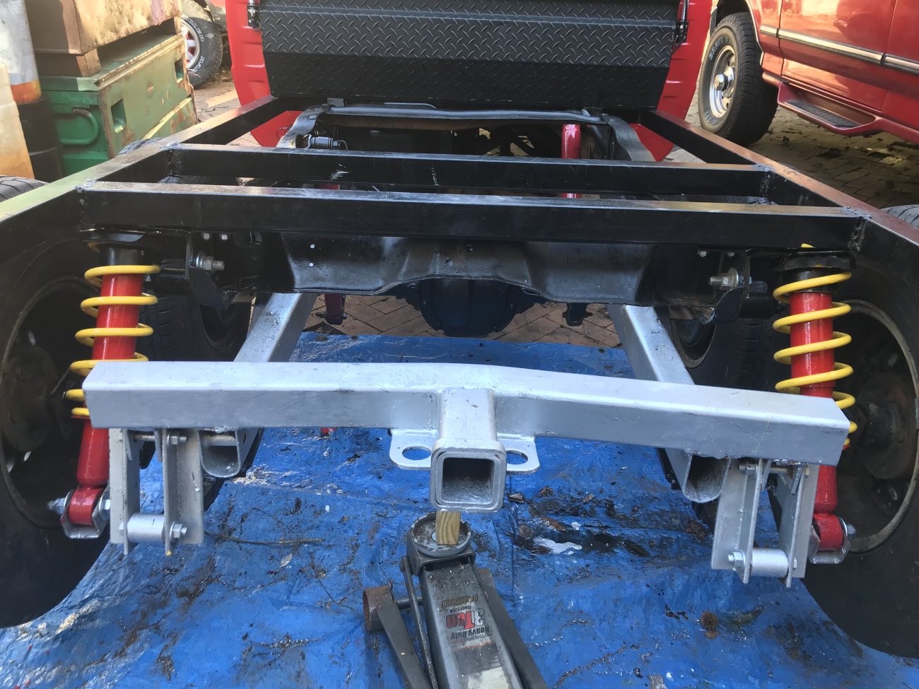

When I added the third axle, a floating axle, to the Road Ranger my fear was that it was going to bounce up and down as I went down the road if I didn’t have the trailer. Again, it’s on a four link set up, and it doesn’t actually hold the truck up, it drags behind. You can back over a 8 inch curb, and never take the traction off the front axle.
When I first did it, I used the coil over shocks from the back of a Honda crossover. They were the complete spring set up for that crossover, not “in addition to.” I’m not sure what year or model, they just looked right as I cruised the pull a part. The truck drove around fine with or without the trailer, and as you can see, I was able to jack up the third axle without lifting the original back axle.
While the axle floated, those shocks were attached to the tip of the Ranger frame, and they were too stiff. With the stage three clutch, I was spinning the wheels like crazy. I took them off, and simply replaced them with the standard shock absorber for the rear of one of my town cars (87-88). That has worked perfect ever since. It keeps the bounce out, but I can climb over a railroad tie without losing traction.
I’m sure nobody will be surprised that the red and yellow paint is rust oleum.
I don’t know if you could use some as a lift kit, but it’s got a pretty good amount of support, and I thought somebody might be able to use some for something or other. Mine are sitting in my way in the shed of miracles for the last two years. I envision them going on some version of some light weight trailer contraption I will make in the future.
