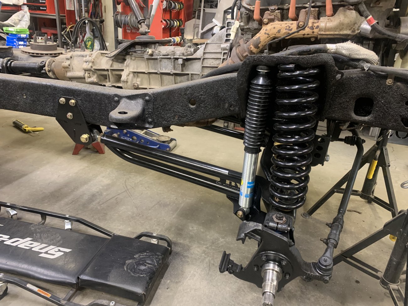

I went with a full custom setup on my Ranger. Both are 4 “.
With the Ranger I used Rough Country rear springs and Bilstein shocks. Stock brackets were retained because I had the beams cut and turned. Custom radius arms, brake cable brackets etc. the clearance with the cut and turned beams is nice.

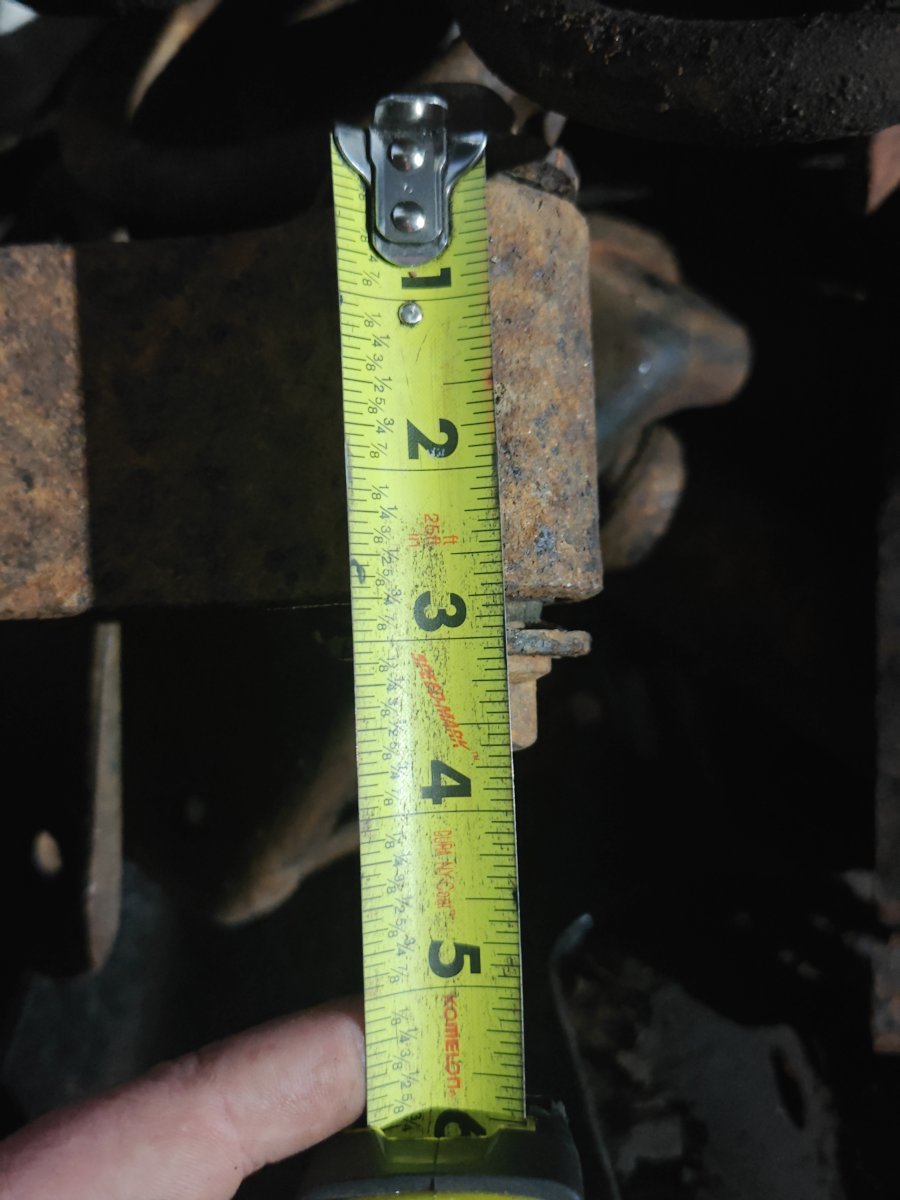

88 2.9 xlt. I did a 4" rough country simply for the price. However, I also had to change leafs and coil spring buckets because of rust. I currently have 2005 f-250 leaf springs that bolted right in with barely any issues. Surprisingly, the f-250 leafs gave me an additional 2" lift in the rear.

That's weird. All the F-250 springs I can find are 3" wide. Rangers are 2.5"
I had to replace the stock shackle mounts and spread them 1/4" on the front. But it was still super easy. Surprisingly, I didn't have to change the plate for the u-bolts.
