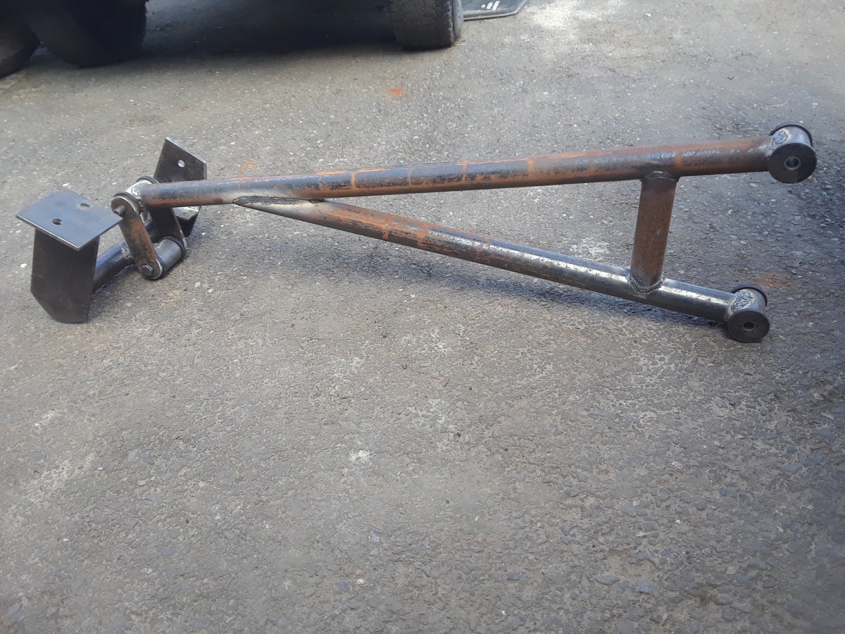

On my '90 the rear suspension is custom so I had to make a custom traction bar, I weaseled it next to the passenger side shock mount between the exhaust and frame with the front mount to the front gas tank crossmember, I have under $100 in it but it's full custom as I just bought the "sleeved bushings" from Rough Stuff and some scrap metal from the metal yard... it works fantastic!

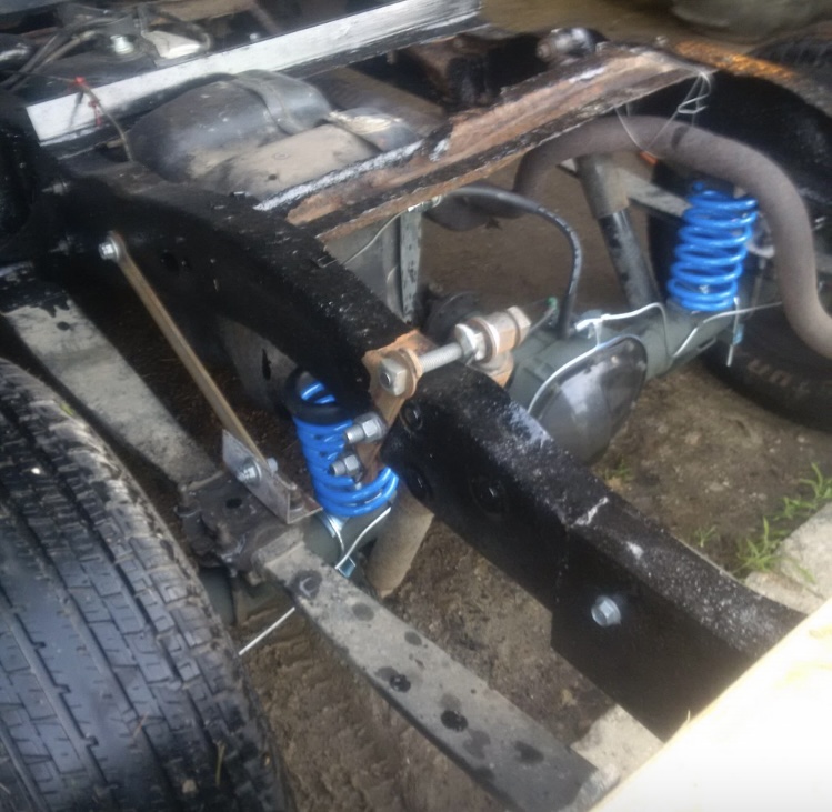

I run flat galvanized steel straps from the frame to the top of the axle. cant get much cheaper than that. I also have single leaf fiberglass springs along with axle coil helpers. Must work cause if I get into the gas too hard in reverse the straps will bend. No problem going forward
What is the easiest traction bar to install?
@racsan, if you change that strap to an angle piece, it will likely prevent it from bending in reverse too.
Do you have any bushings in the ends of that strap?
No bushings, should have -yes. But I didnt. On my ‘93 (4x4 4.0) I used chain with a turnbuckle, same idea though. It didn’t really need them though, had a real steel spring pack and was the 5040 gvwr so that axle didnt flex much anyways, even with it being the 4.0 V6.

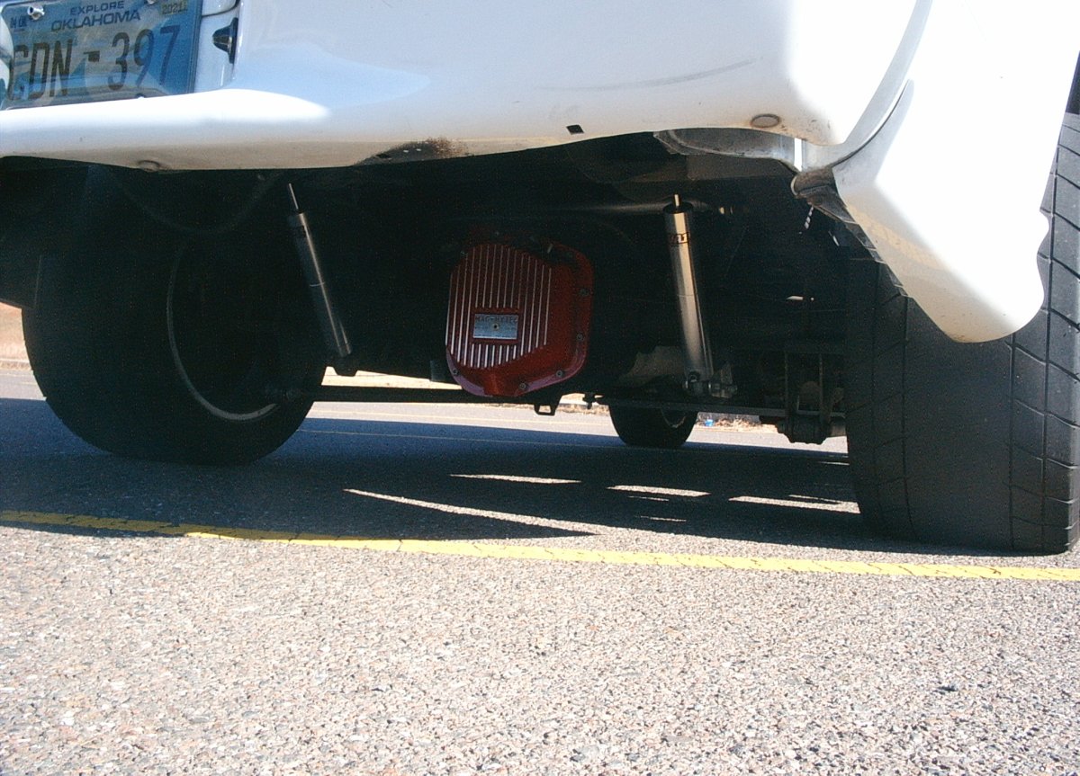

Lakewood makes a traction bar specifically for the Ranger, and no, you don't have to remove the gas tank. LOL. They clamp to the spring in front of and behind the axle. I have the snubber about a half inch from the point of contact. So, that half inch gets used up fast, and then the bar starts working.

When I bought mine in 2000, they made a set specifically for the Ranger. Because of the axle being underneath the springs, the mounts have to be really long.
On my Lightning, I use Johnny Lightning Performance long bars. These are hung below the axle, and the bar extends forward 60 inches to a mount on the frame. These work extremely well, without causing the binding of the leafs like
slapper bars do. I've thought about getting another set and see if they can be adapted to work on the Ranger.
