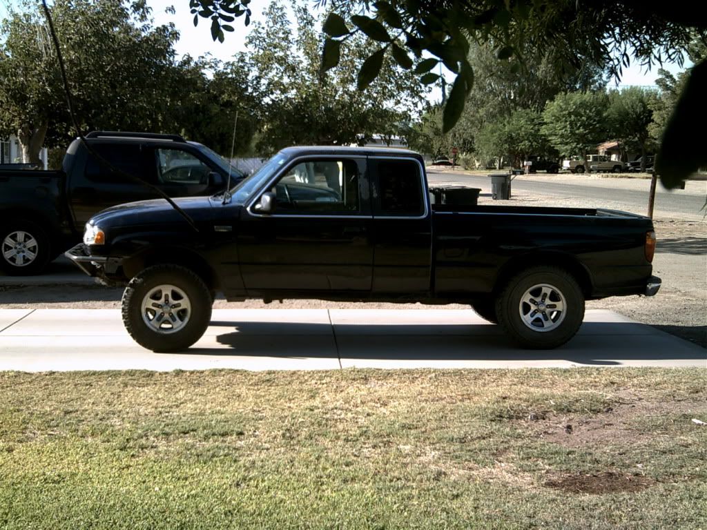

i run 31's and my truck takes em like nothing. altough my speedo is off about 10 mph accordint to the trs tire calculator
jus 3 inch spindles in da front :D
here is my baby
