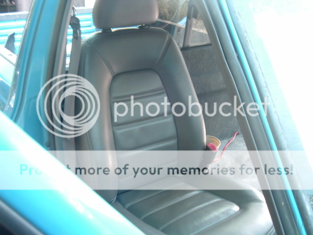

These are 2002 Leather Explorer seats installed in my 1996. I removed the seat tracks all together and hard mounted them to the lower half of the 1996 Ranger tracks. I measured and tested fitted the Driver seat to my driving comfort! Its a small cab so I don't need them to adjust! Then I sat the passenger seat all the way back.

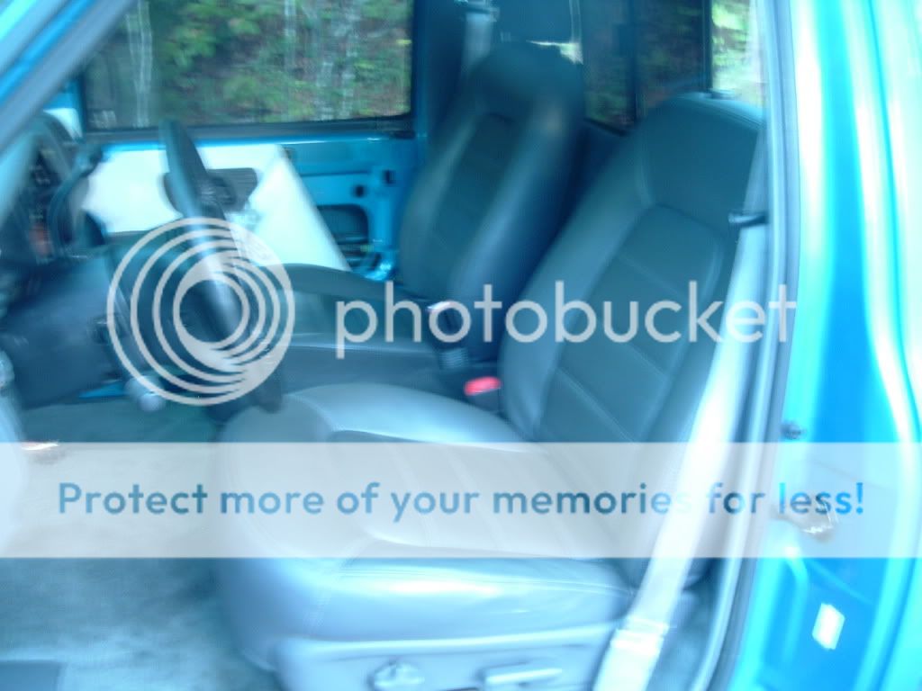

i put 03 explorer seats in my 98 ranger. bolted up perfect, power was even easier to hook up
That is good info. Thanks man! I think i am just going to hunt down Explorer seats then.
