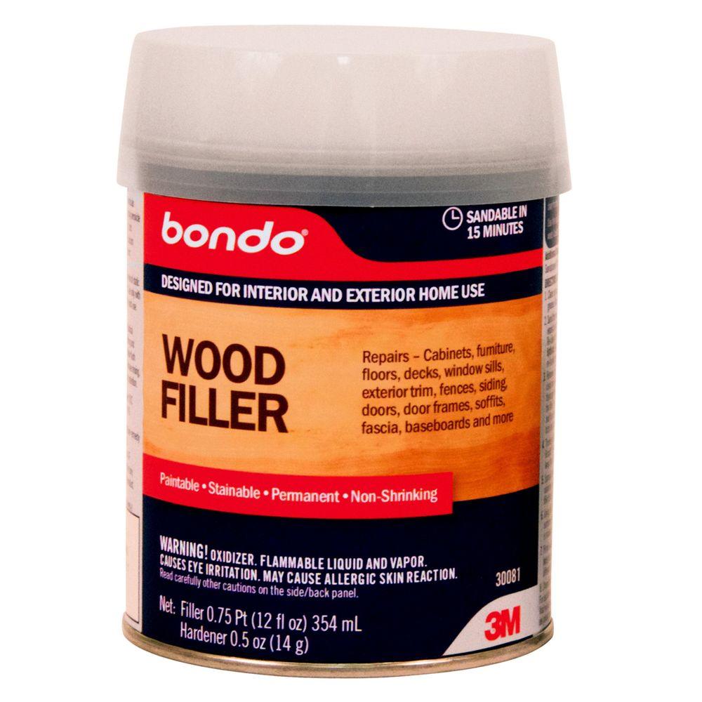

If you have a wooden flatbed.
And it gets wet.
And it warps.
How do you bondo?
And it gets wet.
And it warps.
How do you bondo?
