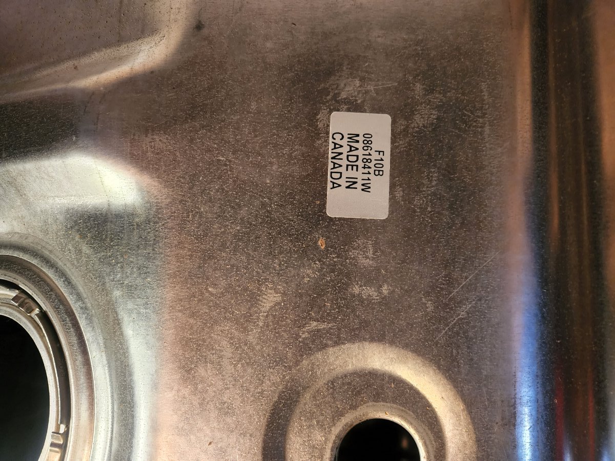

The best tanks are the ones from Spectra in Canada. They are who made the OEM tanks. They have that nice tin coating, they are not painted. But with all this trade war stuff, not sure you can get one, especially if inventory dries up.

Funny enough, my truck came with a Spectra gas tank. Made in Canadia.

Mines got a spectra tank.

My Spectra tank...

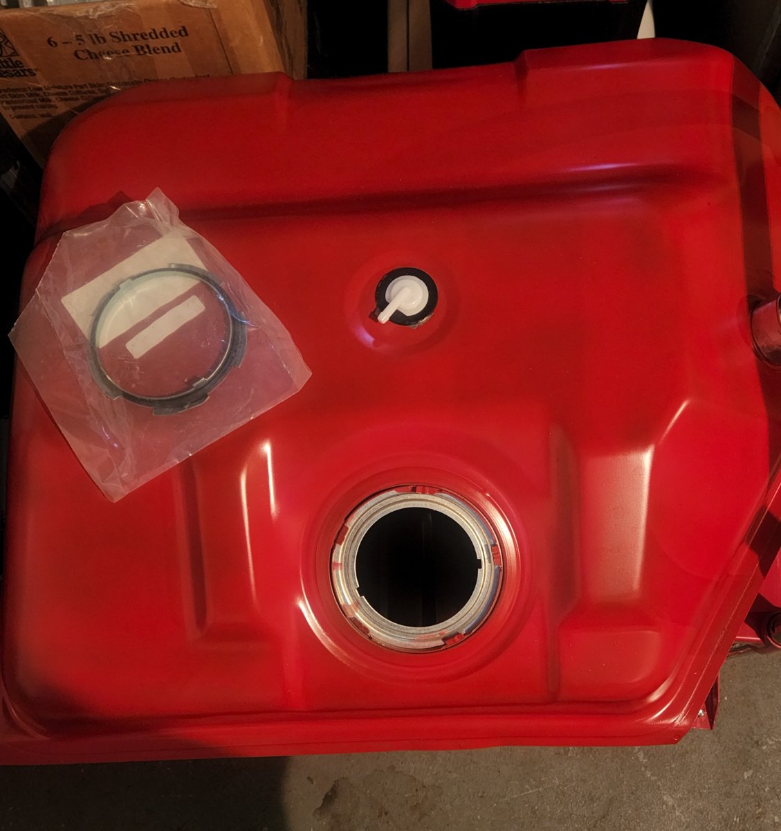

Paint looks good on the tank.

Did it come painted ? Or was it raw steel? Dorman tanks come painted
I thought about doing that to the tank I put on. But I was in a bit of a time crunch with a head gasket blowing on the Jeep, and faulty wiring on the Ranger (again)...
