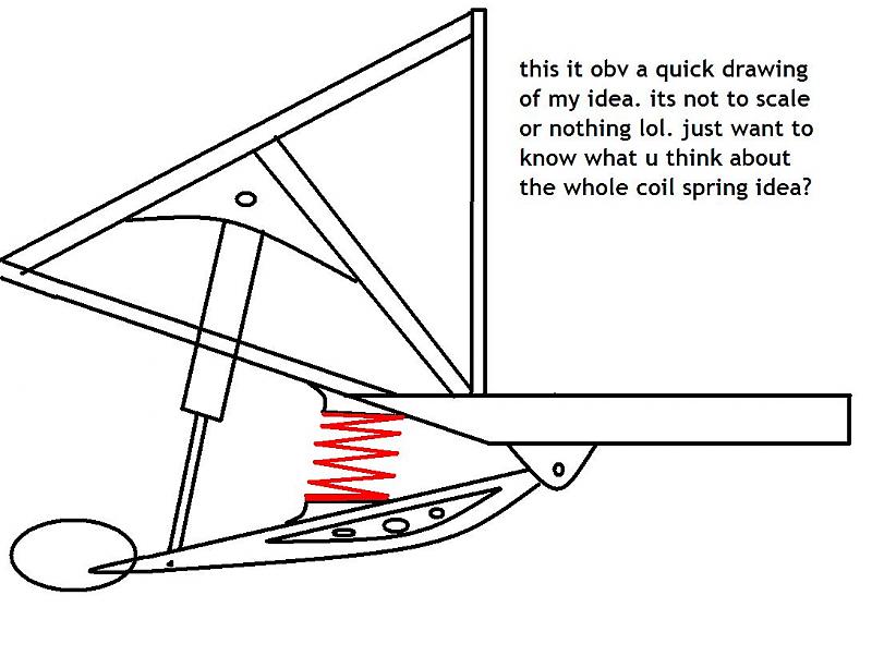

hey, im soon going to start a full chassis build and im just going through some ideas and was wondering what u guys think of this one?
just wanted to see what u guys think. starting next week im trying to build the best truck i can and also as cheep as i can. HARD I KNOW!. but i don't think it cant be done. ill be building 99% of the truck to save from paying ppl to do it for me . id rather build it anyway. but yess i have thought about getting coil overs, that might be the way i go.
For the record, I dont think your get full extension from your springs and you wont get full compression from your shocks. You need to find a way to mount them side by side or completely opposite like most stock setups, being one in front of the other is just gonna mess you up too bad. The ladder bar part of the drawing looks pretty cool though if you could modify it to be practical.
This is completely do-able. It is old school technology though, and no, you will not get large travel numbers like you will with coilovers. If you are worried about costs of the coilovers, check out F-O-A.com, they are much more practical on prices

i have not really thought about what coil i would be running yet, it was just an idea.( any ideas?).as for a shock i was thinking about the bilstein 5150 series.
this truck wont be used really rough just a few trails and small sand pits. Im only looking for around 15" of travel 20" at the vary most.

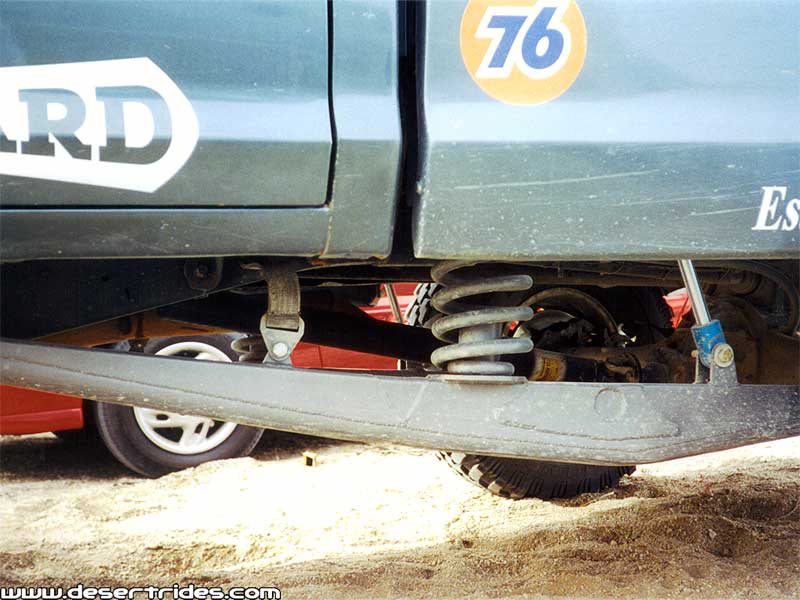

its been done before,back in the day. Perry McNeil use to back when C/O's were waaaaayyyy costly.
If your dead set on doing this,try to talk with perry about it what spring he used etc.

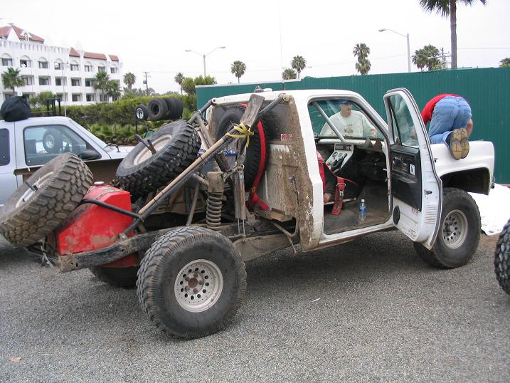

thanks man for the advice, here is a new pics of the set up i want on my truck built my perry McNeil sr ( so the sites say anyway).:icon_thumby: Im still not sure what kind of spring they use though, anybody have any ideas on what they use or what would work?. thanks
