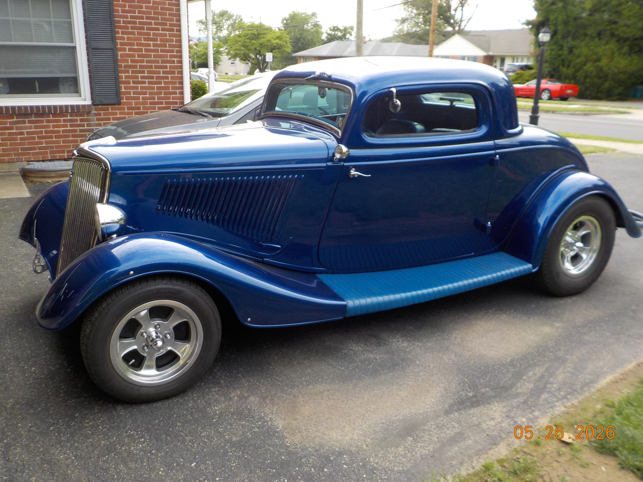

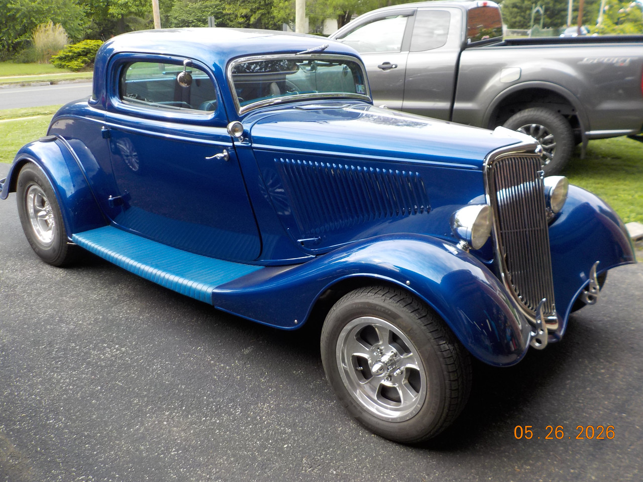

Looks great both ways. Sweet ride.

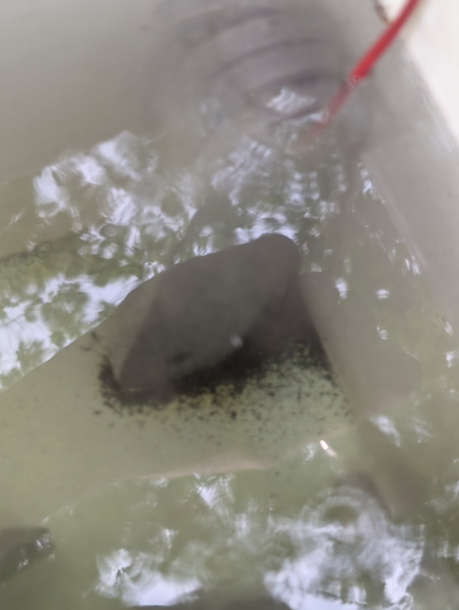

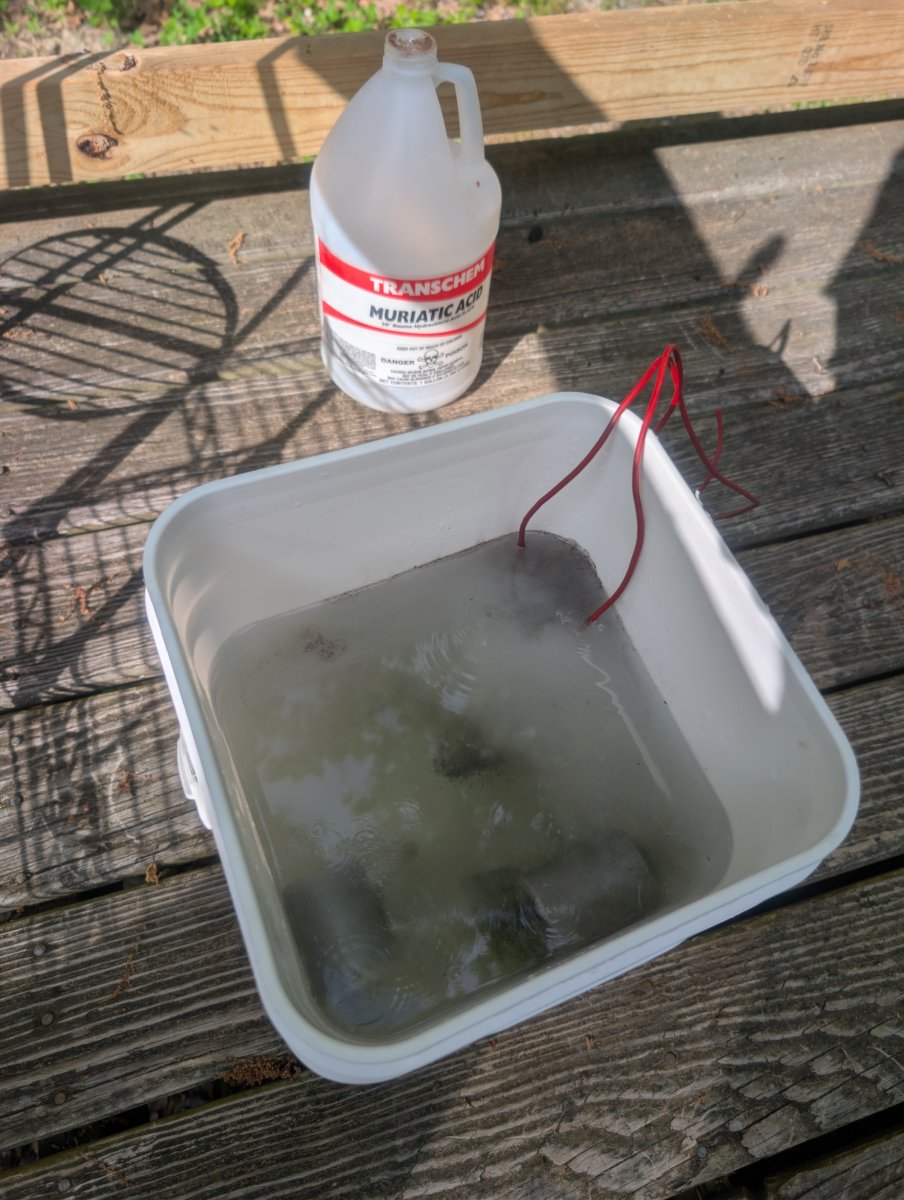

Muriatic acid bath to remove mill scale from a bunch of various squarebody frame/suspension parts.
Pretty simple process.. equal parts acid & water, soak for a half hour, nuetralize in a bucket of water filled with baking soda, final spray with the hose.
Stuff strips off mill scale like nobody's business...
Black crap is scale.. just falls right off.. quickly too.. picture was taken about 5 minutes after submersion.

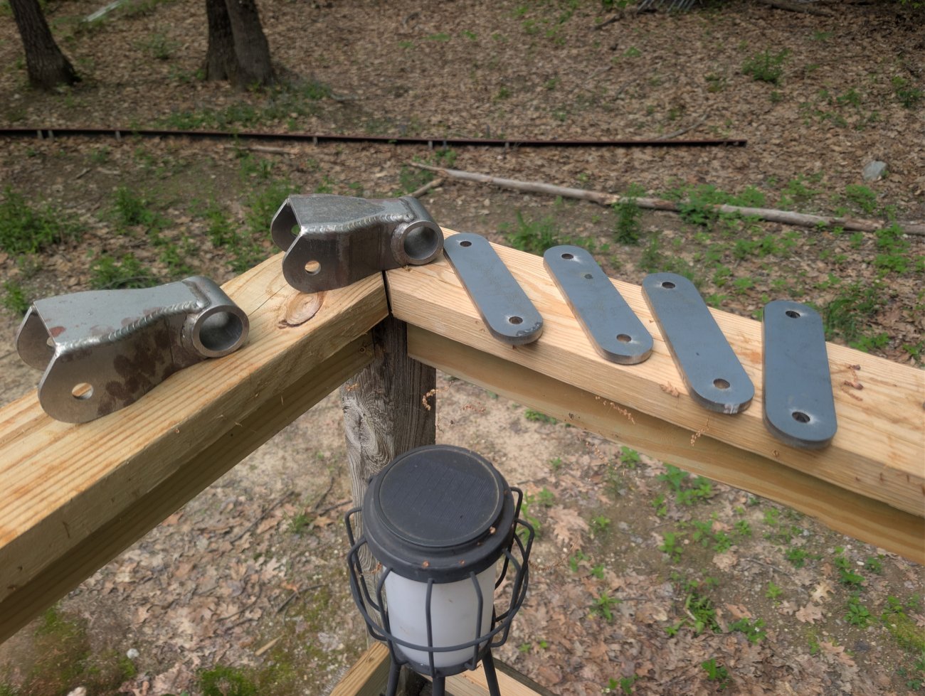

Now.. I could of *sworn* that the people who make corroseal say it still works on bare steel.. so after I cleaned up my shackles I started slapping them with corroseal..
It really doesn't work at all 😑

Everywhere it's BLACK... the corroseal has done it's work. That finish is TOUGH.. a wire wheel in a drill won't phase it in the least bit after it's cured for 24 hours. However... As you can see.... It's real spotty as to where it worked and where it didn't. Bummer.
Now... Gotta figure out my next steps. Everywhere it DIDNT turn black is gonna be covered in what's essentially a clear layer of latex by this time tomorrow... So that'll need to be stripped... But wherever it's black... That shit'll probably on there forever.
