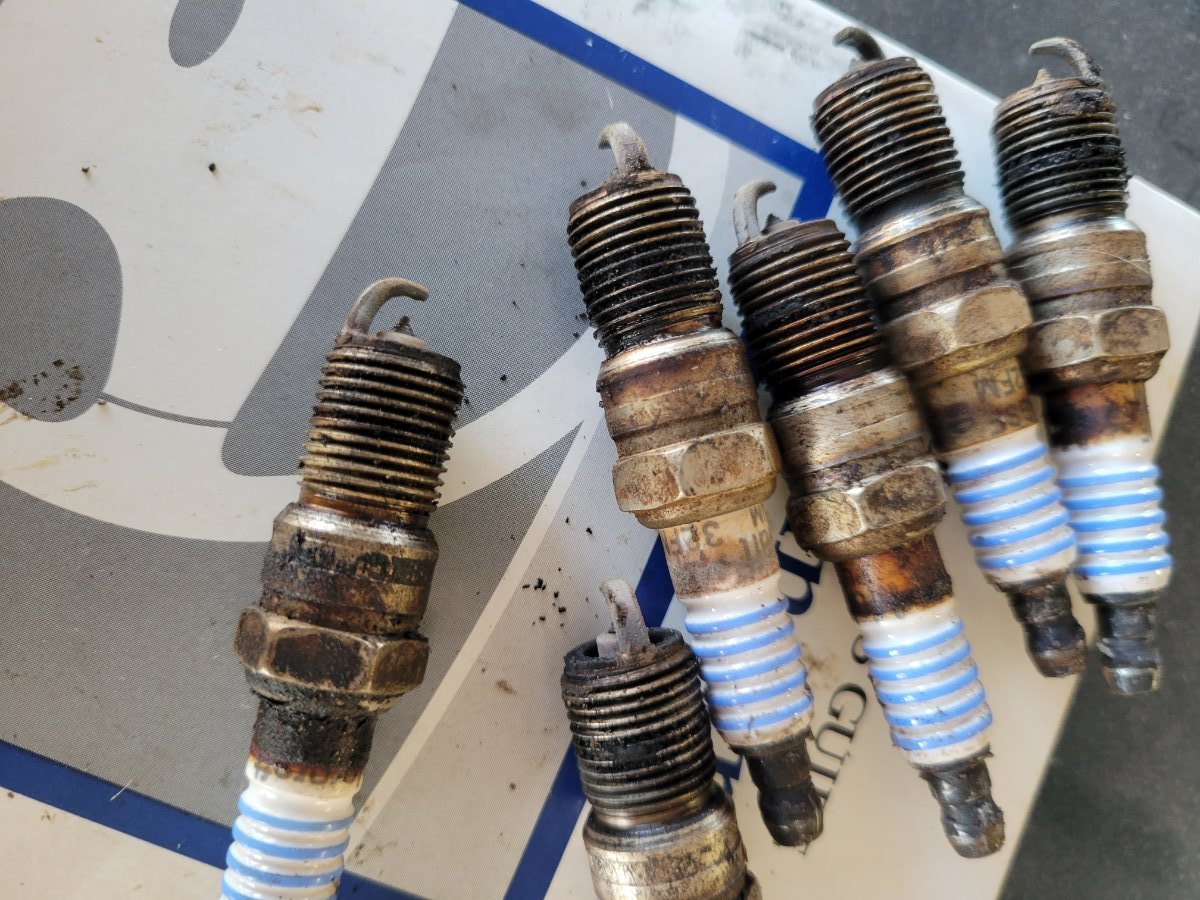

new member, changed my spark plugs on my "new" 98 3.0 with 101k on the clock, it wasn't running that bad, only an occasional misfire detectable with an automatic tranny. old plug gaps ranged from 0.065 to 0.085 my guess is they were original plugs. had to re-gap new plugs from auto parts store to match emissions sticker 0.042 to 0.046. It was 80° degrees outside today so just worked in shade instead of jockeying cars in and out of the garage. have not checked after dark to see if any wires are arcing, two appear to have been replaced. Took about 3 beers and 2 hours to complete.

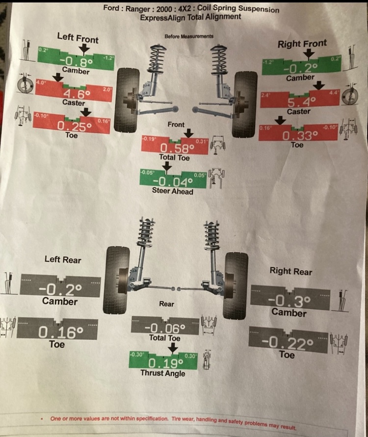

i went to a chain autoshop for a free alignment check and tipped the guy $20 for doing it. but then he went full service and spent a while checking my full undercarriage. shop was empty though. dick move or no?
he gave me this read out on the attached image. considering my steering wheel is pointing a tiny bit counterclockwise towards the left, should i loosen my tierod end one full rotation on the driverside to set the steering wheel centered? or do i have it backwards and the passengerside tierod end be loosened a full rotation?

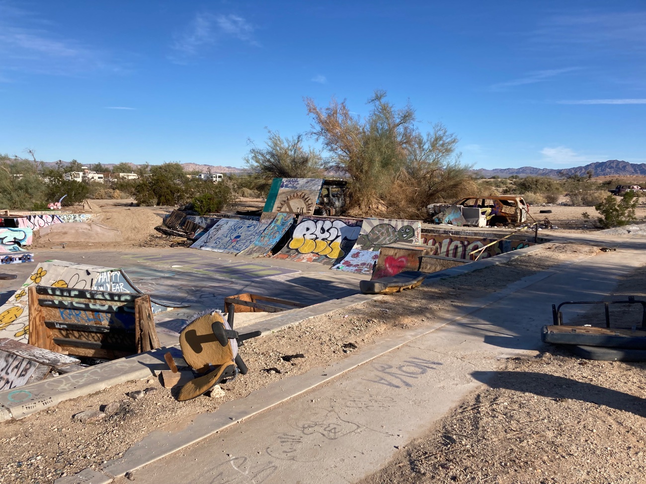

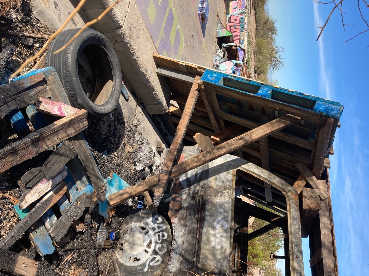

also finished rebuilding this ramp that burned down, cuase someone was living inside my aerostar

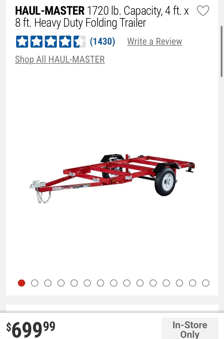

i want to haul a big bag of gravel from home depot 45miles away. are they really only $30 for a giant bag? is there a deposit on the bags? i hear theyre 1100lb bags or possibly upwards of 3/4ton? whats the proper way to strap them to one of these harbor freight trailers (haulmaster 1720)? which type gravel should i use for mixing my own concrete?
I'm not exactly sure how the whole bag thing works. So, I can't help you there.
Be careful on the loading of the trailer, gravel weight adds up real fast. The max weight on the VIN plate includes the weight of the trailer. So, if you don't know what that is, weigh it before you load it. Scrap metal places and gravel yards will often allow people to weigh their vehicles on their scale for free or a small fee.
Over loading the trailer can cause the axle to bend, even if it otherwise seems to be towing fine. Then the only fix is to replace the axle. A bent axle will cause tire wear on the inside of the tire, kind of like what you see when the toe is out of alignment on a vehicle.
i want to haul a big bag of gravel from home depot 45miles away. ...i hear theyre 1100lb bags or possibly upwards of 3/4ton? whats the proper way to strap them to one of these harbor freight trailers (haulmaster 1720)?
I suggest building side rails and make sure whatever floor you put on that can handle the weight between the supports. Tarp the load and use over-rated ratchets - at least 4 of them. Ratchet under the side rails so as not to bend the steel of the trailer and keep constant contact with the load. Make sure the anti-fold bolts are installed. That weight is about the most I'd put on that trailer. I'd run back home with your flashers on, or take the slow way back, whichever is better.
If they were doing a proper alignment, they should have done it in such a way that the steering wheel is straight. A little goes a long way as far as alignment adjustments go. So, I wouldn't mess with it. You could take it back to the shop and ask them to straighten the steering wheel, like they should have done in the first place or live with it. Since you paid for an alignment, they should make the correction at no charge.

i recently did the steering rack myself and eyeballed the toe. then i went in for a free alignment *check*, tipped $20 and then asked for the printout.
my steering wheel is a full rotation out, i know this cuase i snapped my clockspring /facepalm.

For the correcting the steering position, whichever way it is off, tighten one side and loosen the other the same amount until you get the steering close. Without an alignment rack, close is the best you are going to get. In the end, it's going to need an alignment by a shop to get it totally correct.
