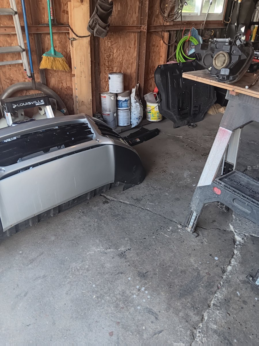

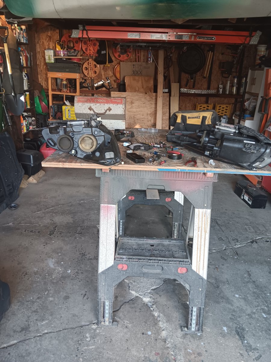

While working on replacing the HID low beams, I had to pull the splash shield. Evidence is pin pointing to the side of the engine facing toward the transmission. So, it may be the tube there that is notorious for the o-ring turning into goo. I'll investigate furthe before running the engine so the system can pressurize. It looks like it may be an active leak, static.
In other news, I have changed the HID low beams. I just need to run to the parts store for replacement marker lights while I have easy access to them. Looking at how "easy" the bulbs in the bumper are to change (Fog, Park, Turn), I think I'm going to do those too. The only ones in the front that are really easy to get to and change are the high beams. Everything else pretty much requires that you tear apart the front end.

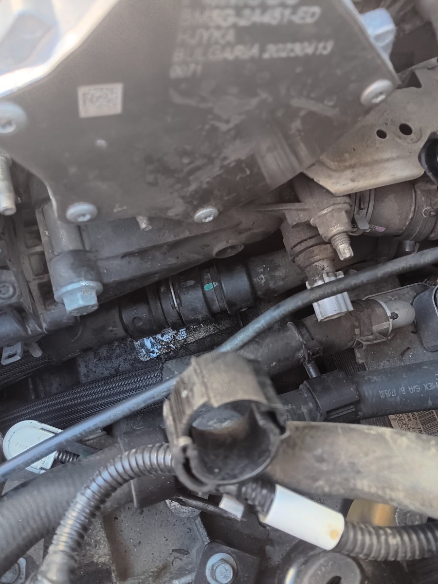

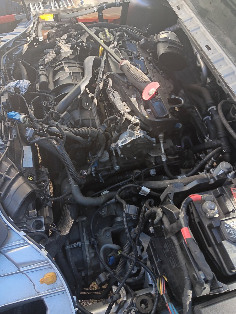

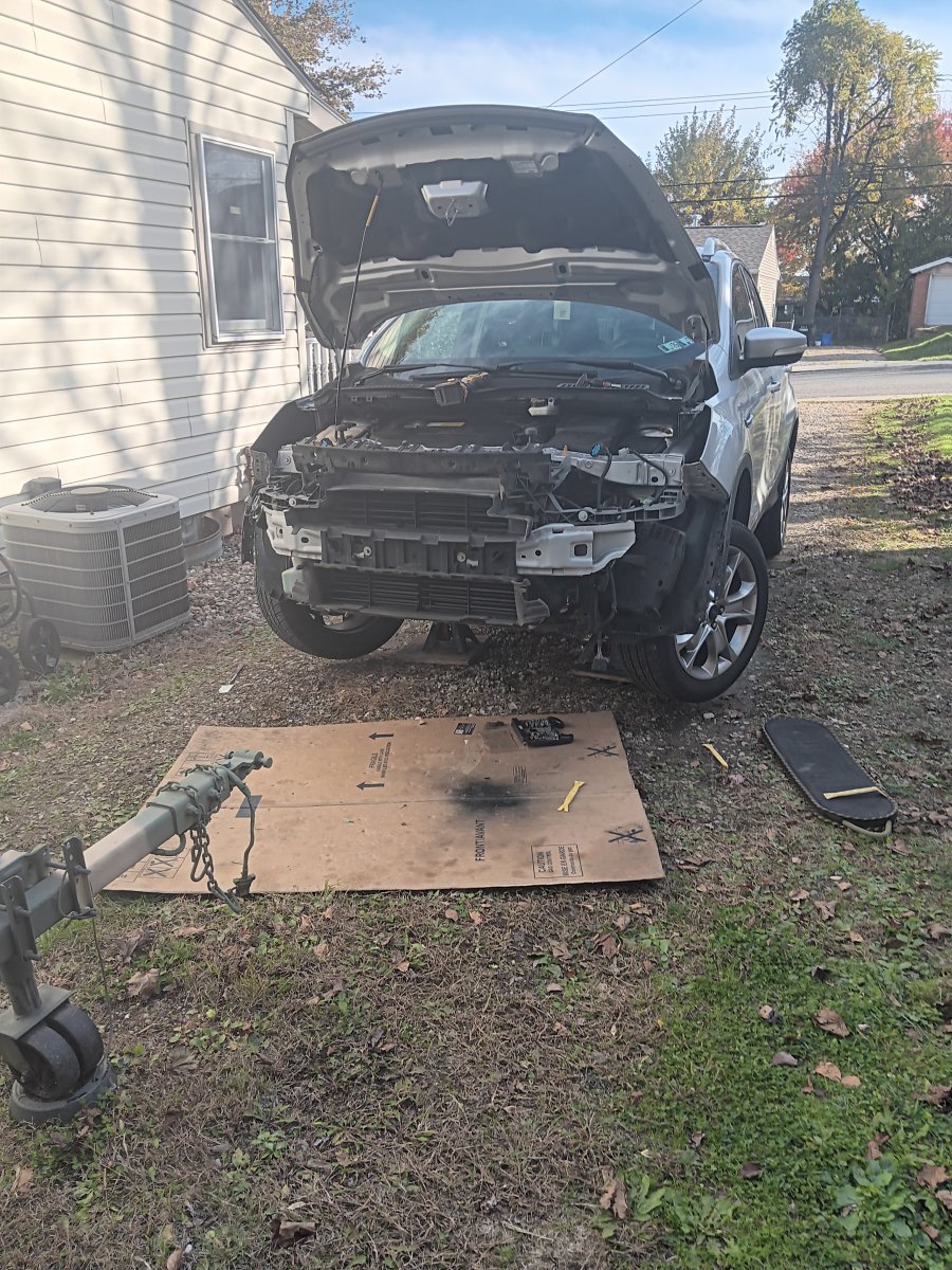

THe front is the car is back to together and I'm starting to dig to where the coolant leak is. I can see coolant on the side of the transmission cooler but there is a bunch of wires, tubes and hoses in that area. I'm slowly working my way down to find the source. I'm seeing evidence that someone else has been there before. So, I'm thinking someone knew there was a problem and elected to let it be someone else's problem. Just like the valve cover oil leak. With amount of work it takes to get to all of these issues, I would hate to see what a shop or dealership would charge.

It is located at the back of the engine, as expected.

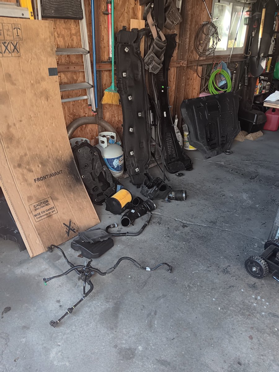

I had to remove all of this, along with all the spaghetti moved out of the way in the above picture.
