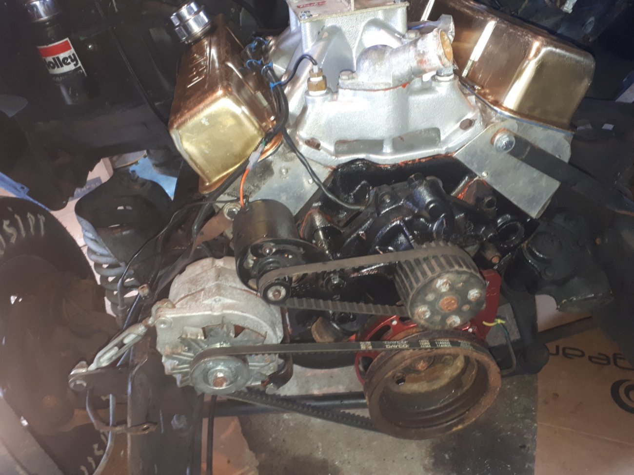

Looks like the alternator bracket is to the frame? So the engine is solid mounted? And the water pump is run off 12V electric?Productive day here - All that's left now is headers, plugs and wires, carb, radiator, grille and hood. Had to fight with the alternator bracket to get the belt aligned properly but we finally figured it out. NHRA Canadian Open starts Thursday so it looks like we'll be ready for it.
