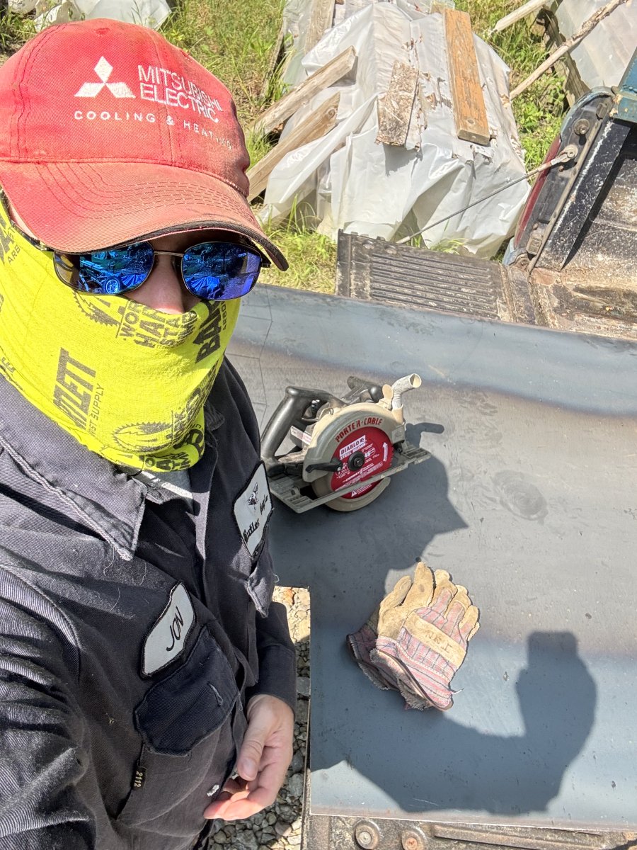

So… those metal cutting circular saw blades… :headbang::yahoo:
Having that chip exhaust thing on the saw was really nice too, I could aim most of the debris away from me. Worked really slick, right up until I tried a few plunge cuts. The third plunge cut killed it. Well, it cuts still, but not well at all. I managed to force it through the last few cuts. Gonna buy another blade though and just remember that plunge cuts need to be done with a death wheel.
I didn't know we has Antifa members here.
You take that back… that is one of my Arborist face protectors to keep saw chips out of places they shouldn’t be. I was melting in that dang PPE, had to make a couple cuts, take it off and take a break, then don it all again and repeat.
Yep, Antifa. It gets triggered at the drop of a hat too....

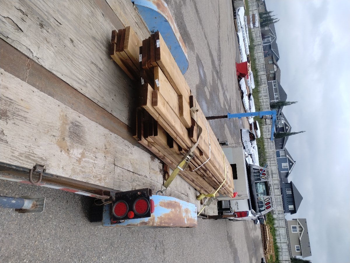

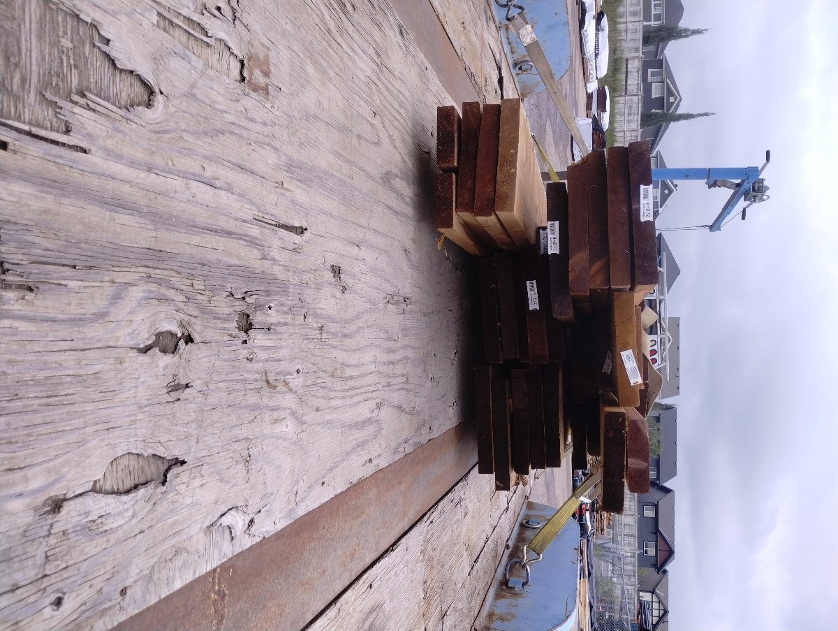

Started tearing off the deck on my car hauler. Many years ago I used 2x8 and 2x6 spaced about 1.25" apart then covered with 1/2" plywood. The last car I hauled I noticed that the front tire was sitting about an inch below where it should be. The deck was soft. I scored a bunch of pressure treated 2x10 and 2x12 for $100, so its time. The pic is of the trailer hauling the lumber home...
You can see the plywood is seperating. And under the seams the 2x is rotting.
I'll have to figure a way to attach them. Using self tapping screws won't last long because the treating is corrosive. And I don't want to drill and bolt if I can help it. But that's what I'll probably have to do.
:buttkick:
I decide to wear proper protective gear for a change and this is how I get treated? Accused of such absurdity? I feel like Rodney Dangerfield. I don’t get any respect I tell ya…:thefinger:

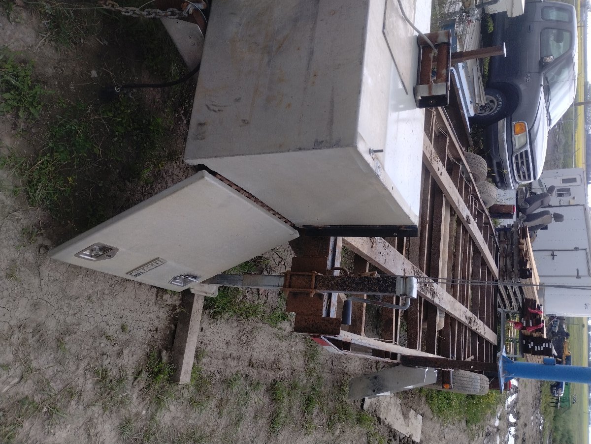

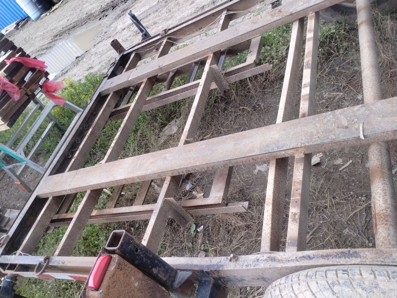

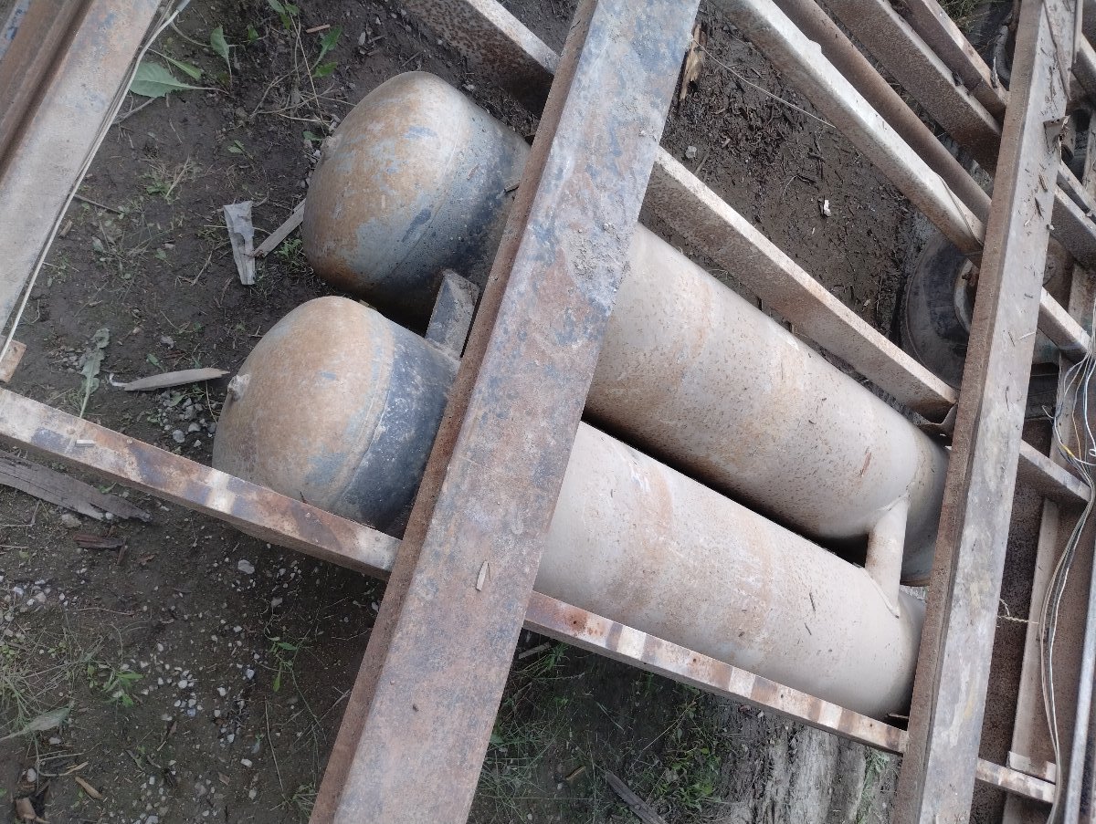

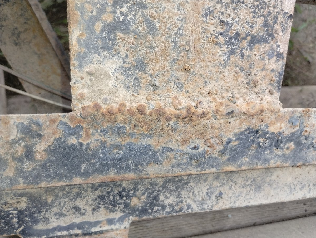

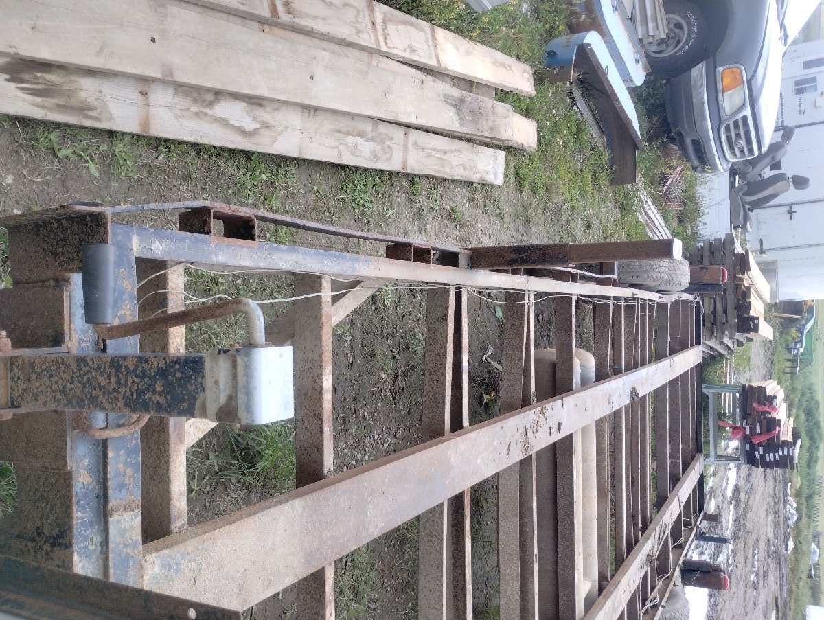

Finished tearing off the old deck. This trailer had a car on top burn up. I was told this before I bought it. The repairs done are meh at best, and terrible in the main. The welds that is. I had done some repairs last time I had the deck off. Now I'll finish fixing the welds as best I can. I might make the propane tanks usable as an air reservoir. I'll put a small 12V compressor in my tool box. And a Schrader valve so I can fill it up quick. The tool box also houses a 10,000lb winch, as well as chains, straps, bungie cords and other misc.

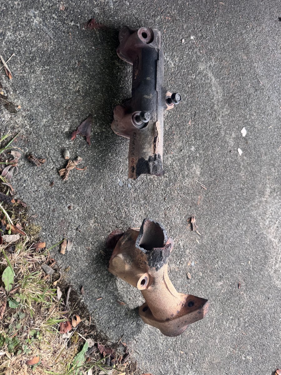

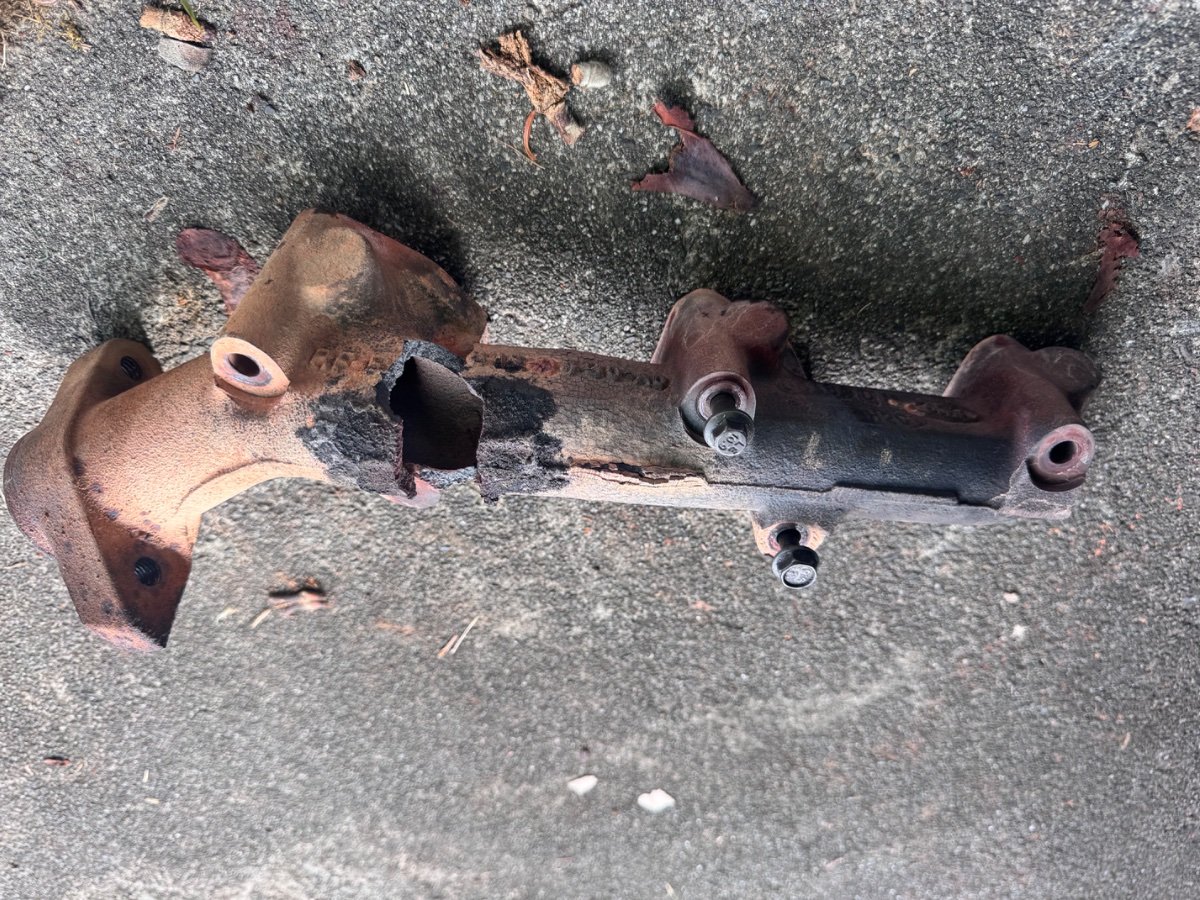

Tore apart my passenger side exhaust manifold cuz she was getting loud with me… found this beautiful sight hiding under the manifold cover… just finished welding it back together and we will see tomorrow if it still fits… Cast iron sure is fun welding 😑
