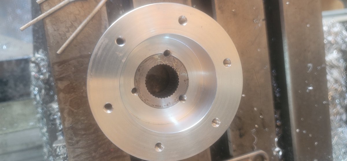

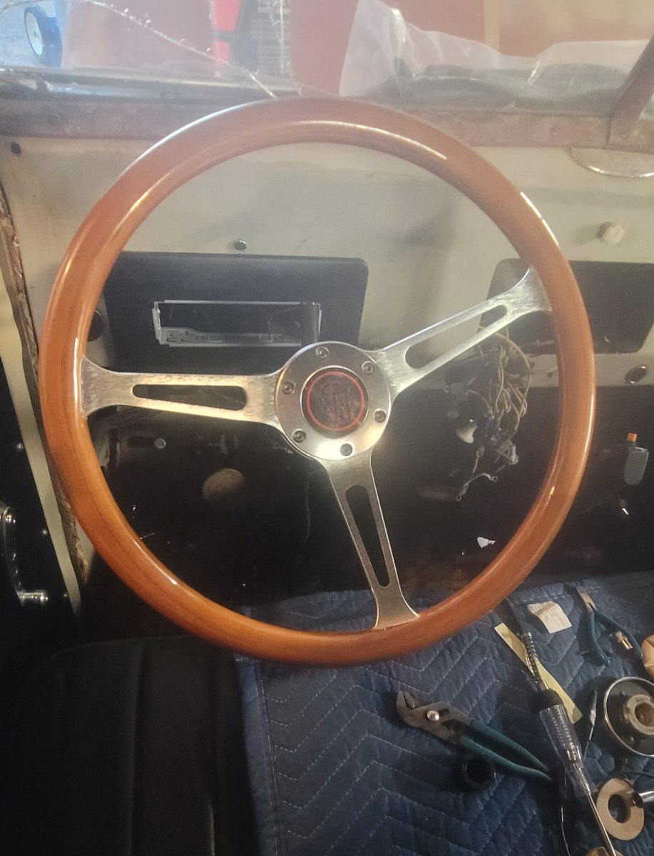

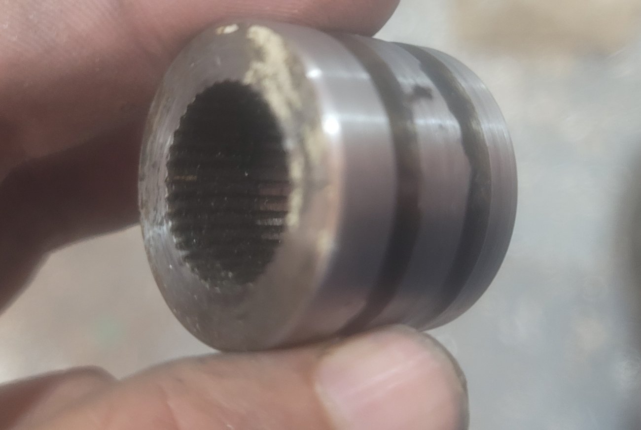

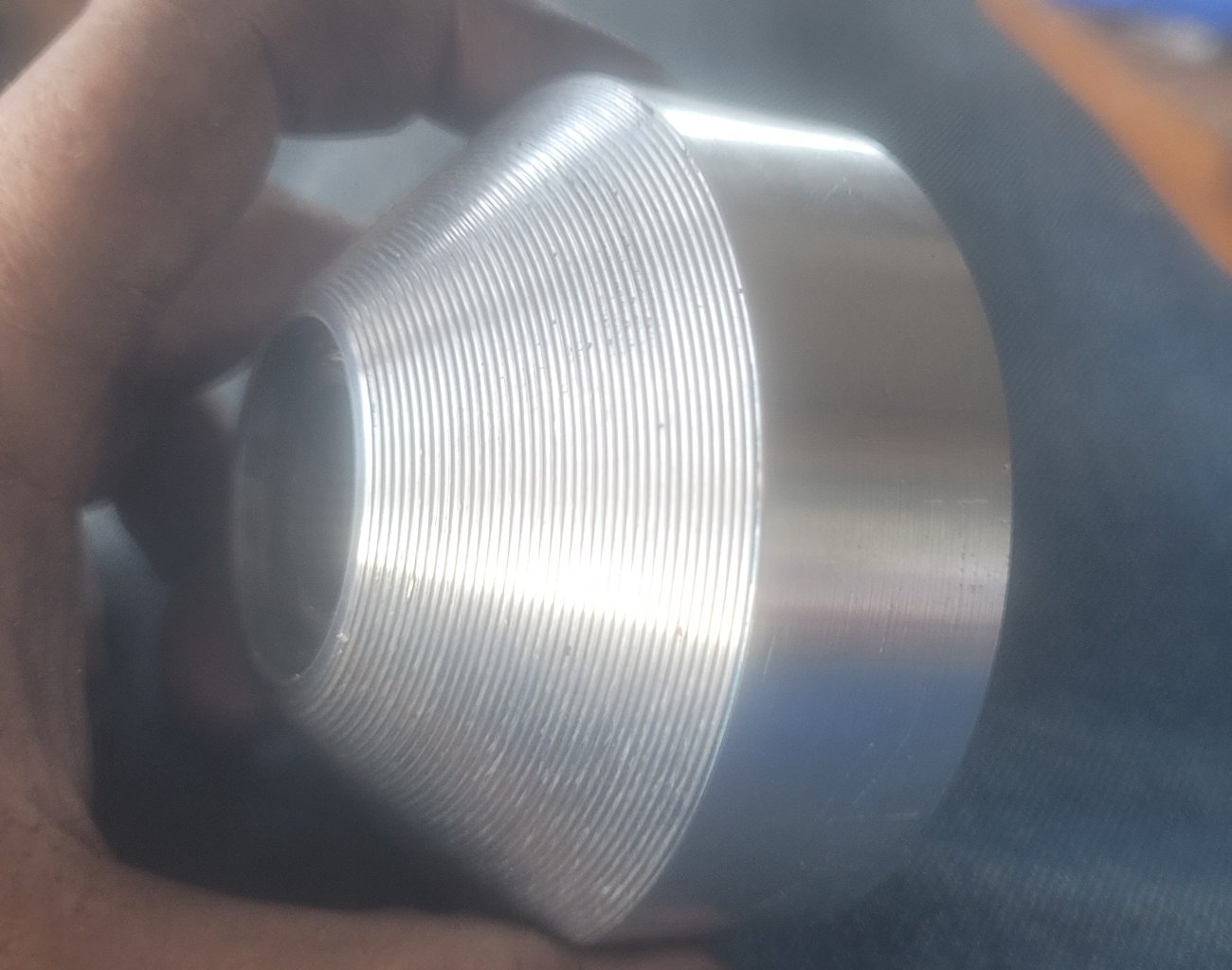

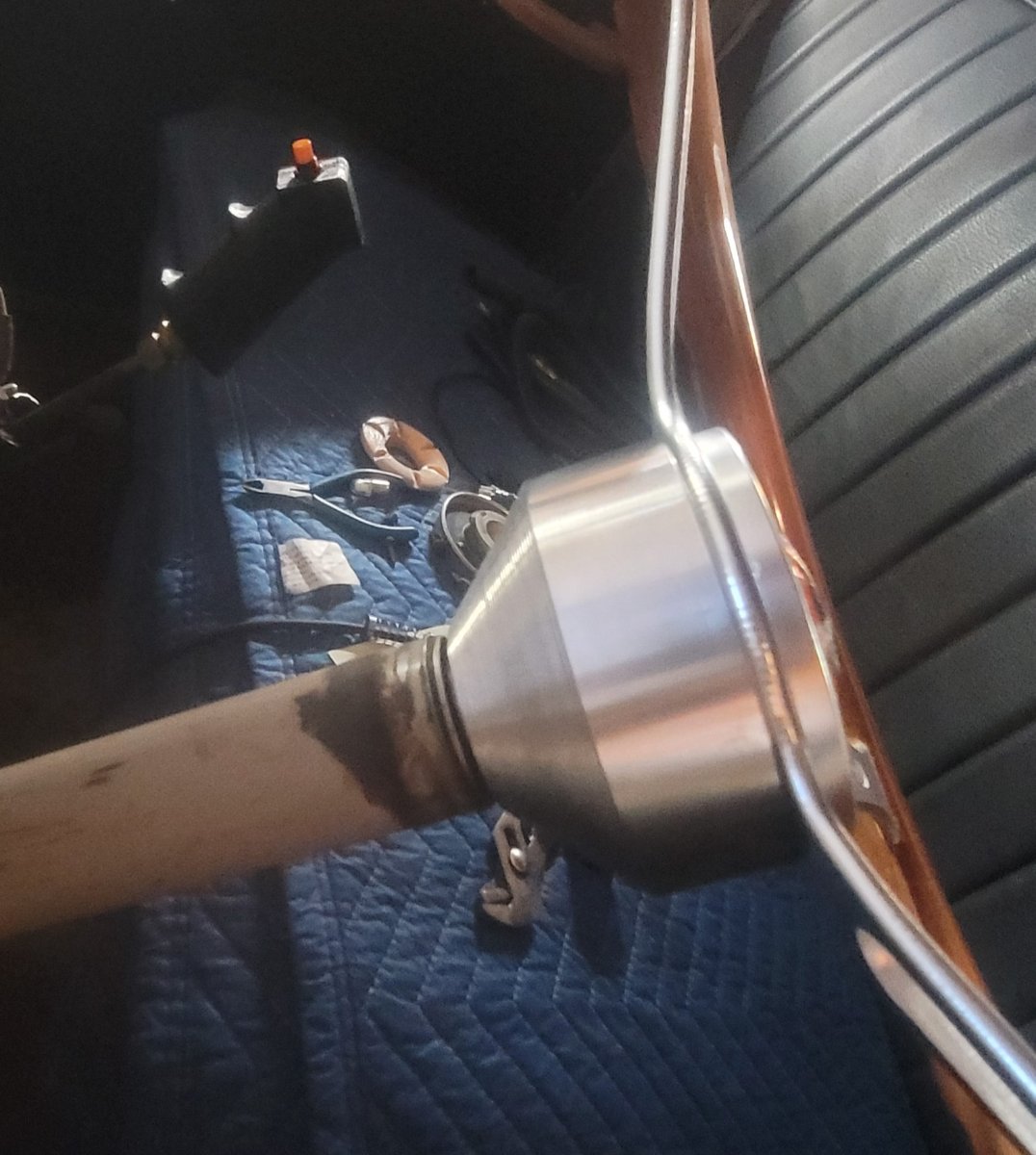

I cut the old steering wheel apart for my dad's 1950 Willys pickup and made an aluminum hub for a modern steering wheel. I turned the splined sleeve round on an arbor, made the aluminum piece, shrunk the splined piece into it with .002" interference, some loctite, and 3 dutchman screws. It turned out ok. I also 3D printed a black and red W logo for the center (horn button is on dash).
If you put that level of detail and effort into the whole truck...
I wanna see more of it. That's nice.
I probably will at some point. He doesn't want to spend a lot on it so I keep making him random parts to keep him interested lol

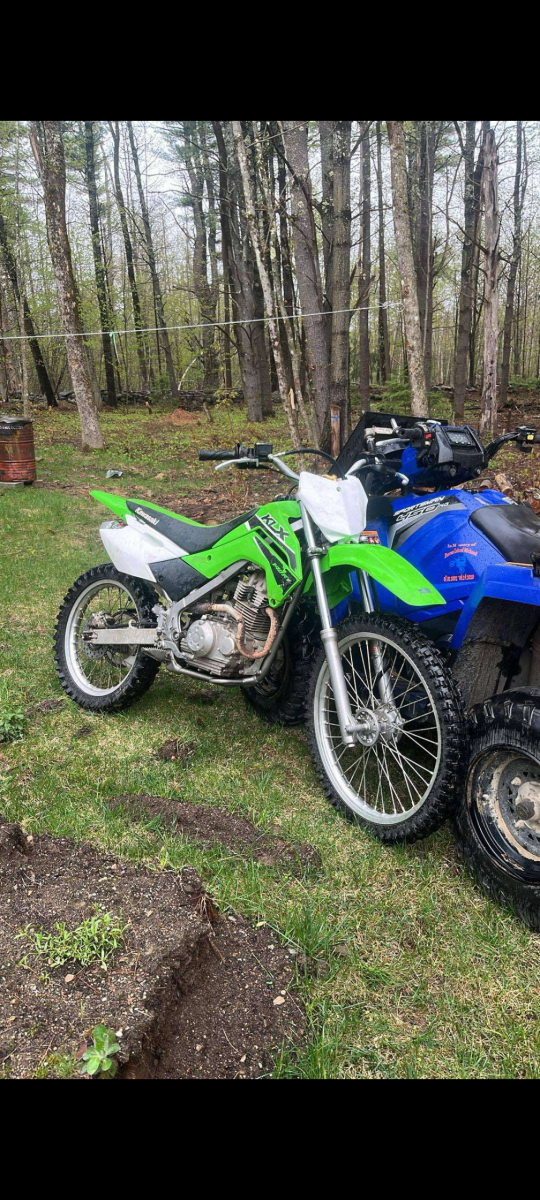

Klx140r. The kid I got it from is the nephew of the guy who built the minibike lol.. really wanted the thing back in the family I guess.
It's in as nice of shape as any dirt bike you get from a 17 year old kid lol.. rear wheel bearings are shot, some rear spokes missing, front wheel warped to hell, a slip on pipe booger welded to the factory header, dead battery, no front disc, doesn't like to start, boggy dead spot right off idle when moving..
Kid claims it's a '23.. but well wait and see what a vin decoder says lol. Probably gonna pick up a compression test kit too..
Either way.. even if it's running out of squish.. I'm happy and would still consider the direction of the trade as 'up'.
Hmmm...
I really want an aftermarket wheel in my 96, but I don't believe anyone makes a quality adapter..
This something you could/be willing to do.. at some point?
Probably. I'd need a donor steering wheel and a lot of dimensions though.
It might be easier to find an adapter for a 96. He's got a 1950 Willys. The old simple round column is pretty easy to make look good too.
