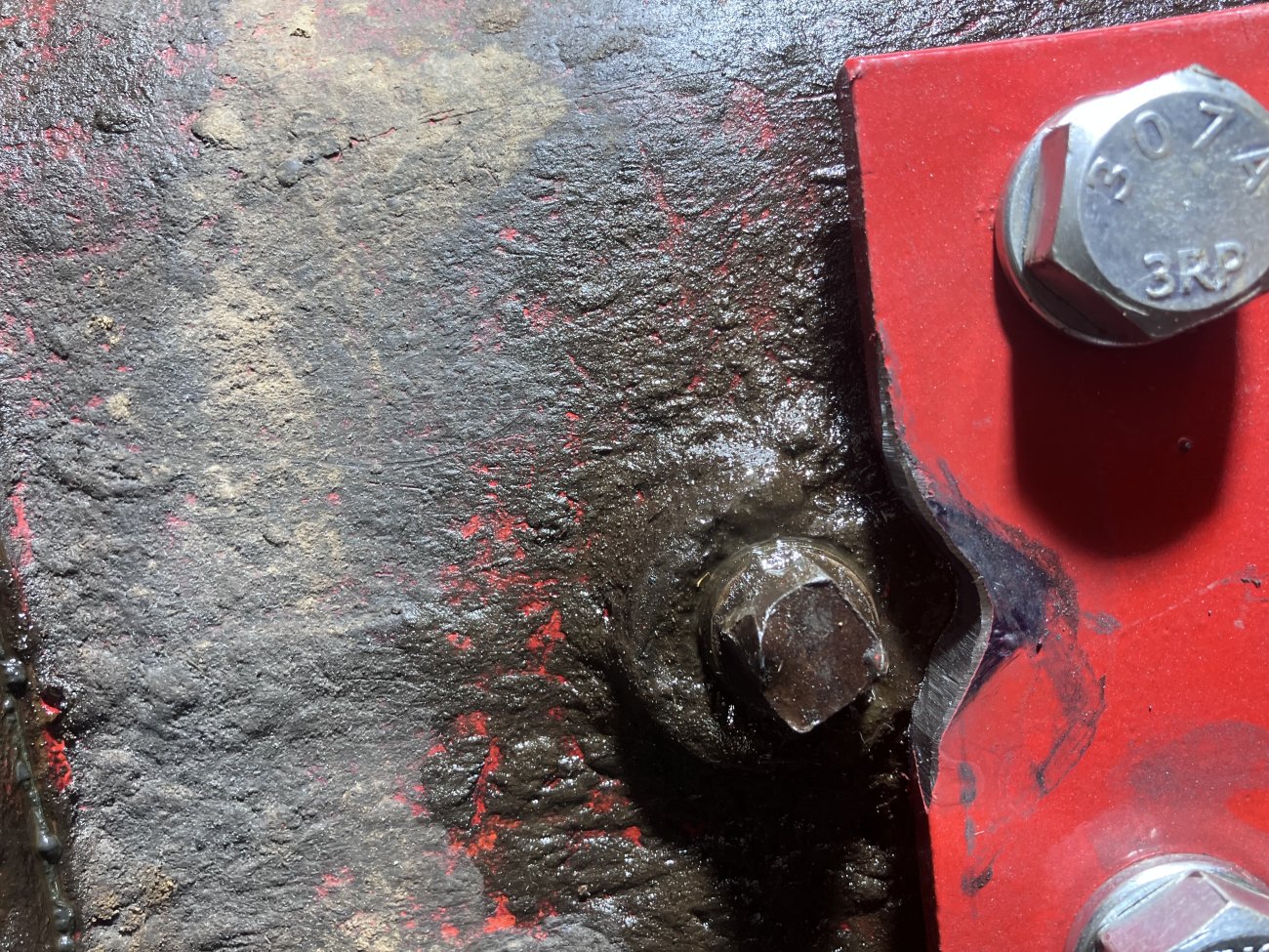

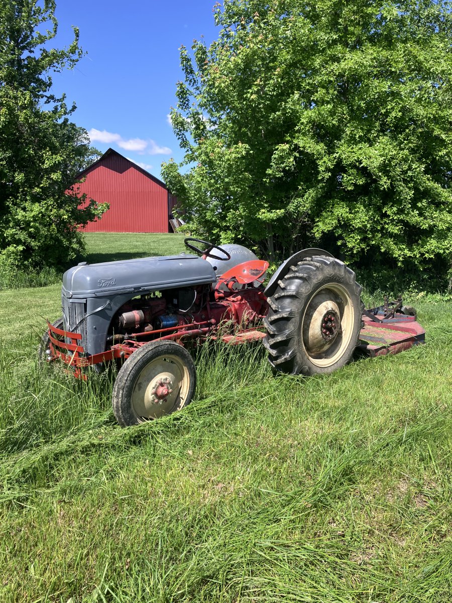

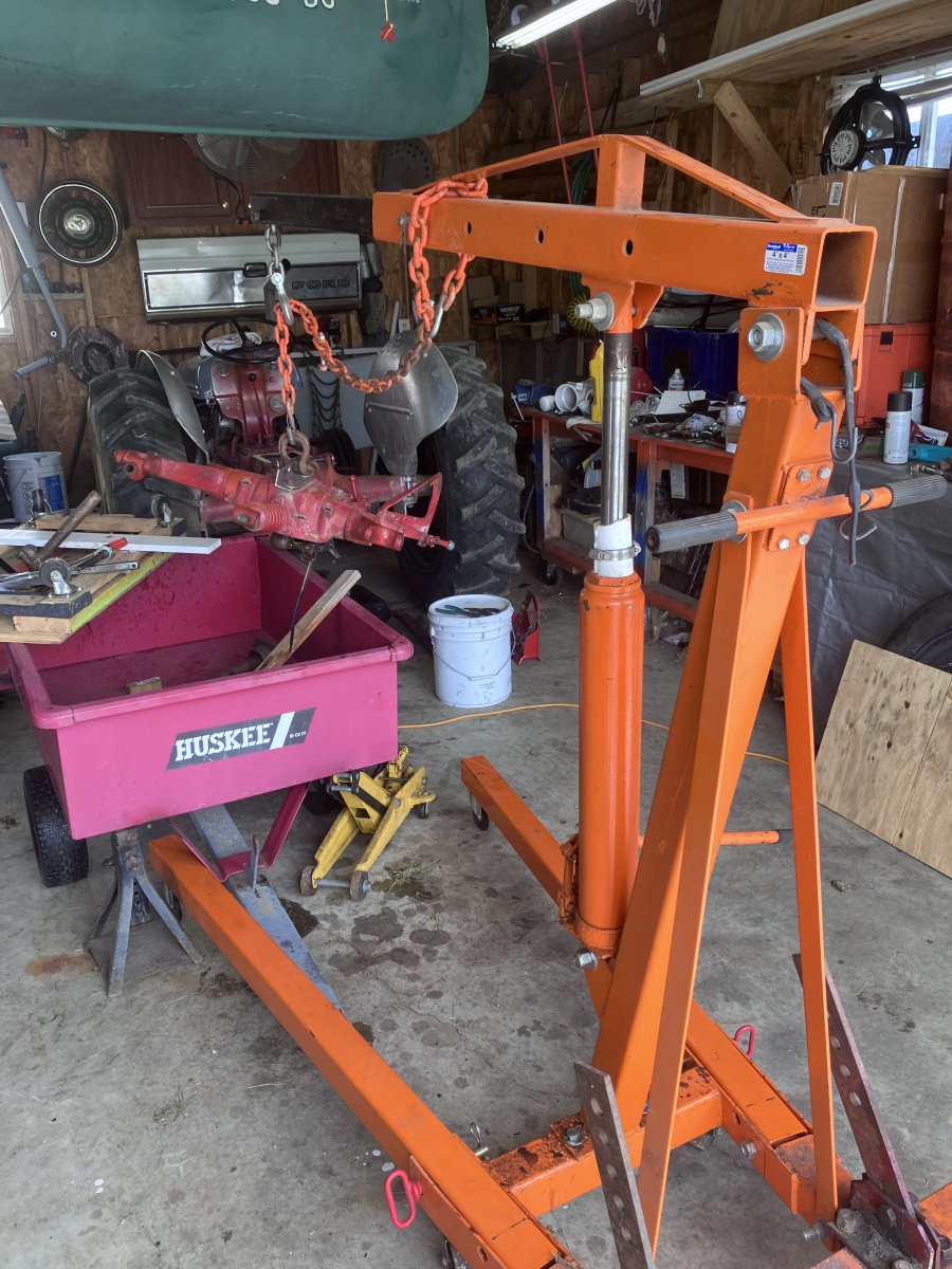

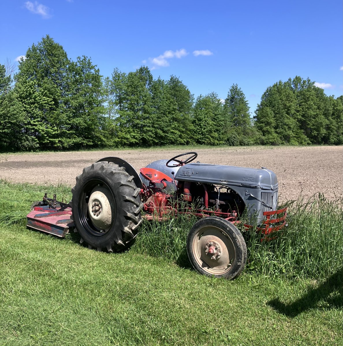

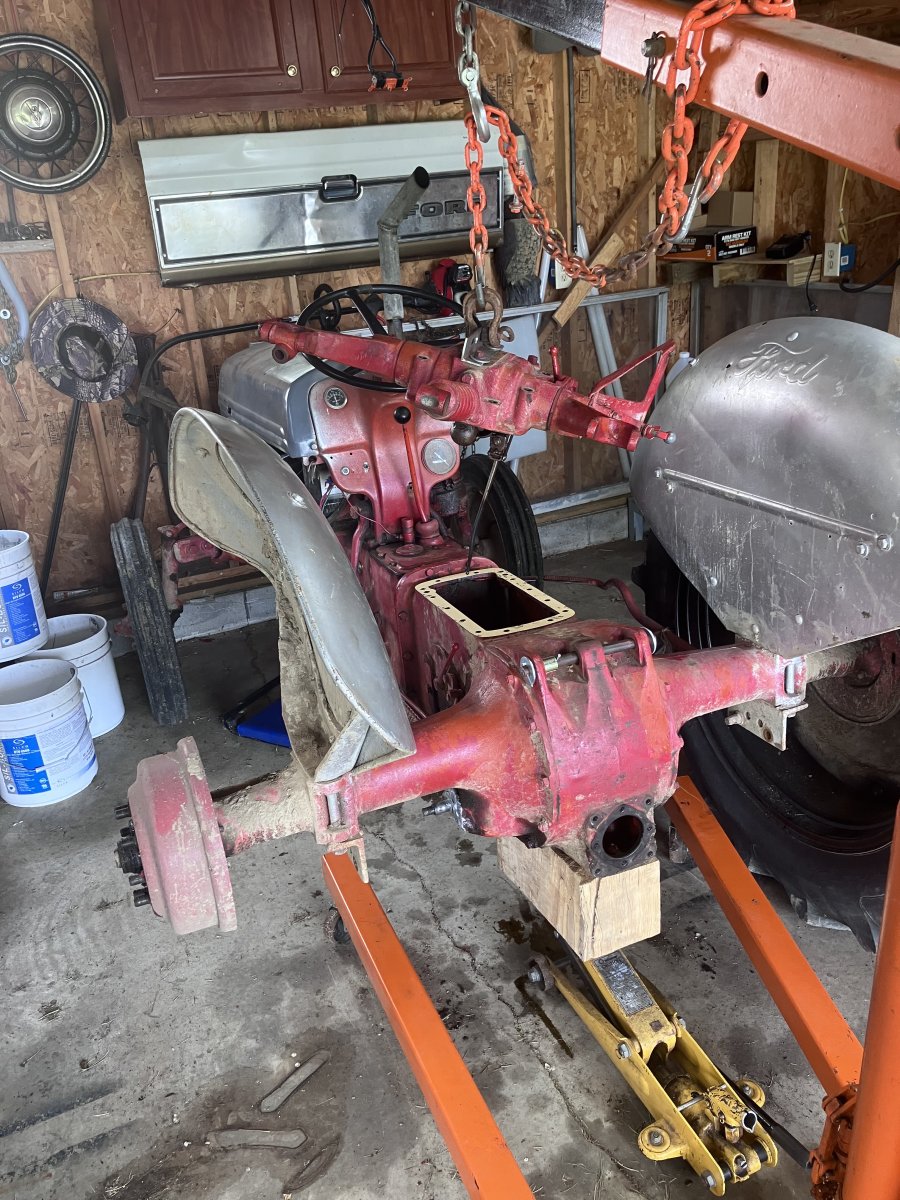

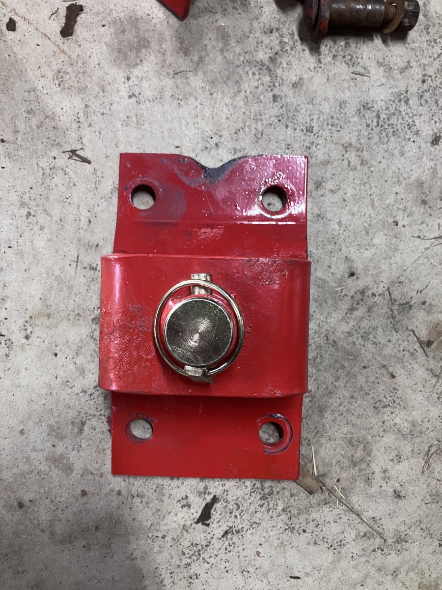

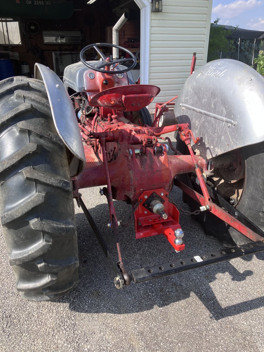

Got the tractor back together & out of the garage, dug out my engine hoist to make putting the top hydraulic plate back on easier, turns out it was wider than the distance between the back tractor tires so I had to pull a tire. Still worth it. Clearanced the plate for the drawbar mount underneath so its not so close to the differential drain plug. Later I took off the straightpipe upright exhaust & put a underbelly stock setup on with a muffler. If it ever dries up I can try out the bush hog I bought a month ago. Now that Ive freed up a garage bay & got tractor parts & tools out of the gator I can now put the power bed lift on it and add sideboards.
