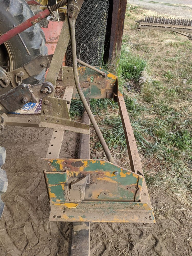

Tonight did some more farm fabrication, brother wanted somethin to shear off the top of the dirt to get rid of vind weed and thistles that are evading every dirt working implement... so we rooted through the random stuff sitting around and found a 6' grader blade that was worn down to like 3" on one end and 6" on the other but still had a new edge left (they apparently never flipped it? but took it off when they got a new one?), then found a 3 point frame that didn't work for what he first tried it for but would work for the plan, found a random ripper tooth that was about 30" long ~5/8" or 3/4" thick by 2.5" bar, cut that in half, welded each half to the sides of the frame then welded the blade at about a 10 degree angle for down pressure... had the old stick welder fired up and cooking metal pretty good. The intention is to use it on already worked dirt so it doesn't need to be super strong so we didn't go too overkill, he'll probably try it tomorrow...
