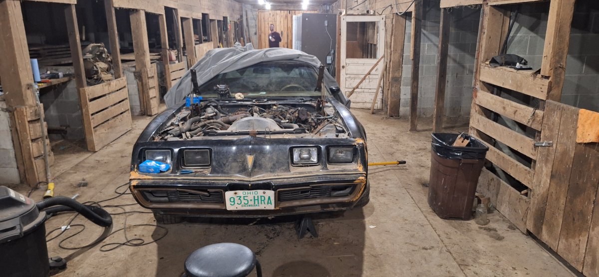

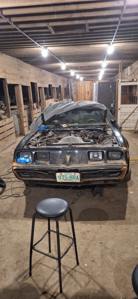

My son-in-law inherited a 1980 Turbo Trans Am after his father passed. His dad bought it new and parked it in 1985 after the turbo went out. The car has 44,000 miles on it.
It's sitting in the lower level of their barn in Ohio. My SIL and his friend tried to start it but it wasn't getting spark. He replaced the components in the distributor along with new plugs and wires, and still no spark.
I remembered that these Turbo T/A's had a spark control module. After some research I found it under the front of the center console, unplugged it, cut the green wire for the G connector and the black wire for the J connector and connected them together with a butt connector.
A shot of starter fluid and it started right up. It will stay running if I keep spraying starter fluid in the carb. My SIL was pretty happy / excited to see it run.

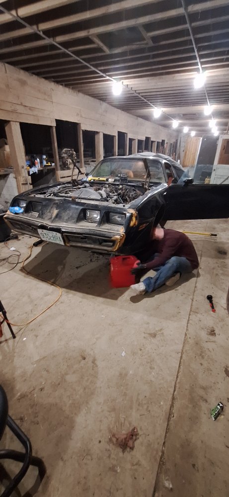

He had removed the fuel line that goes to the fuel tank and ran a hose into a gas can, but the pump isn't sucking up the gas. I pulled the line off of the carb to confirm that there isn't any gas flowing through it.
It's great to see the T/A run after 39 years. Looks like the next step is replacing the fuel pump and draining the tank.
