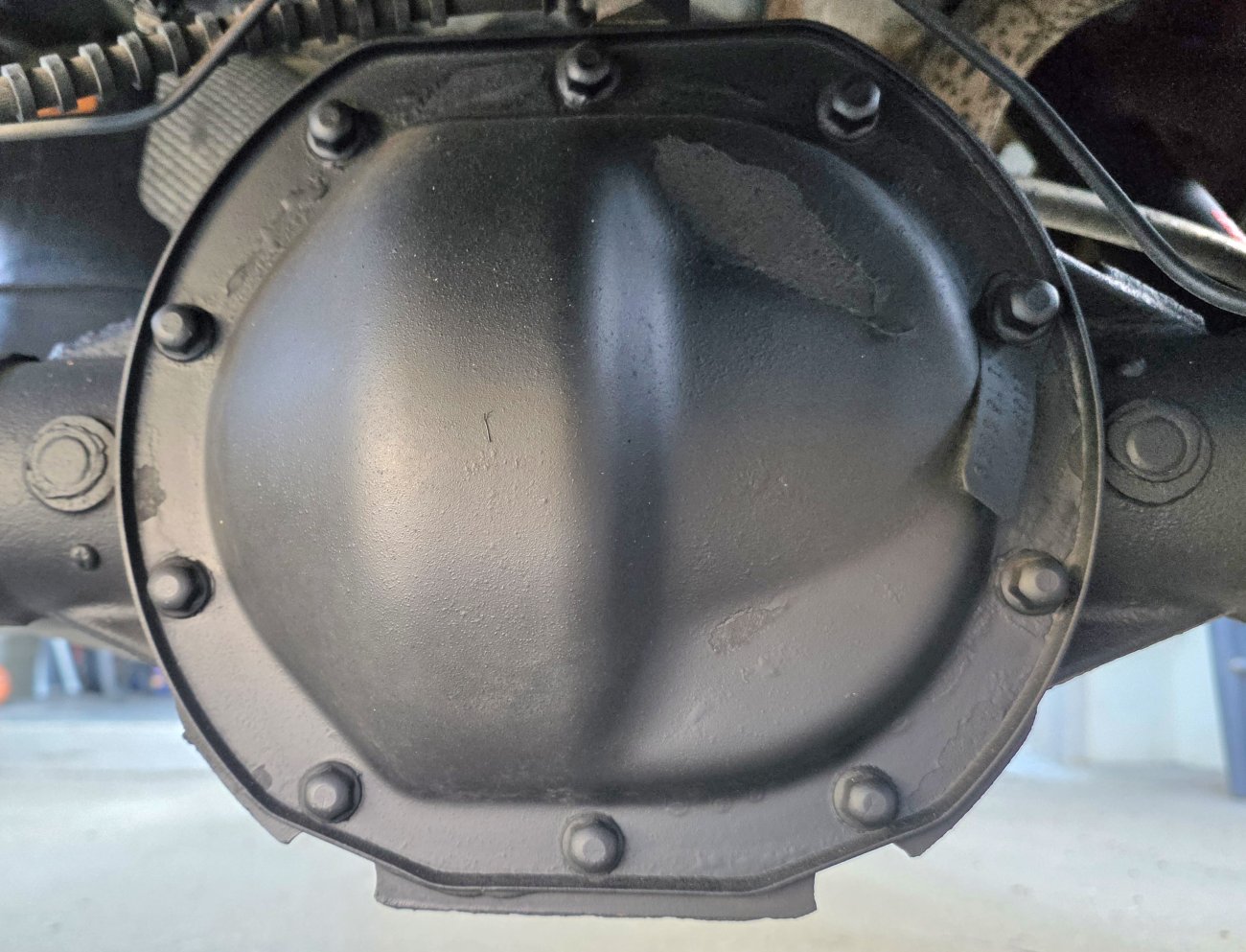

2 things on my list still yet to do, 1, replace rear shackle on both leaf springs, 1 is severely bubbled up with rust. Anyone use the ATS shackles? Also need to service the rear diff. 3 quarts is what I have seen. Most seem to like RTV, but I love the Lubelocker gaskets, cost difference is about $30 since I have no RTV currently. I plan to use 75W90 as most all of its full synthetic. I need to get my axle code off the door to see if I have a LS, but several of the gear oils I am looking at say no extra friction modifier is needed. Any opinions on what direction I should go with on servicing the rear diff and shackle replacements.

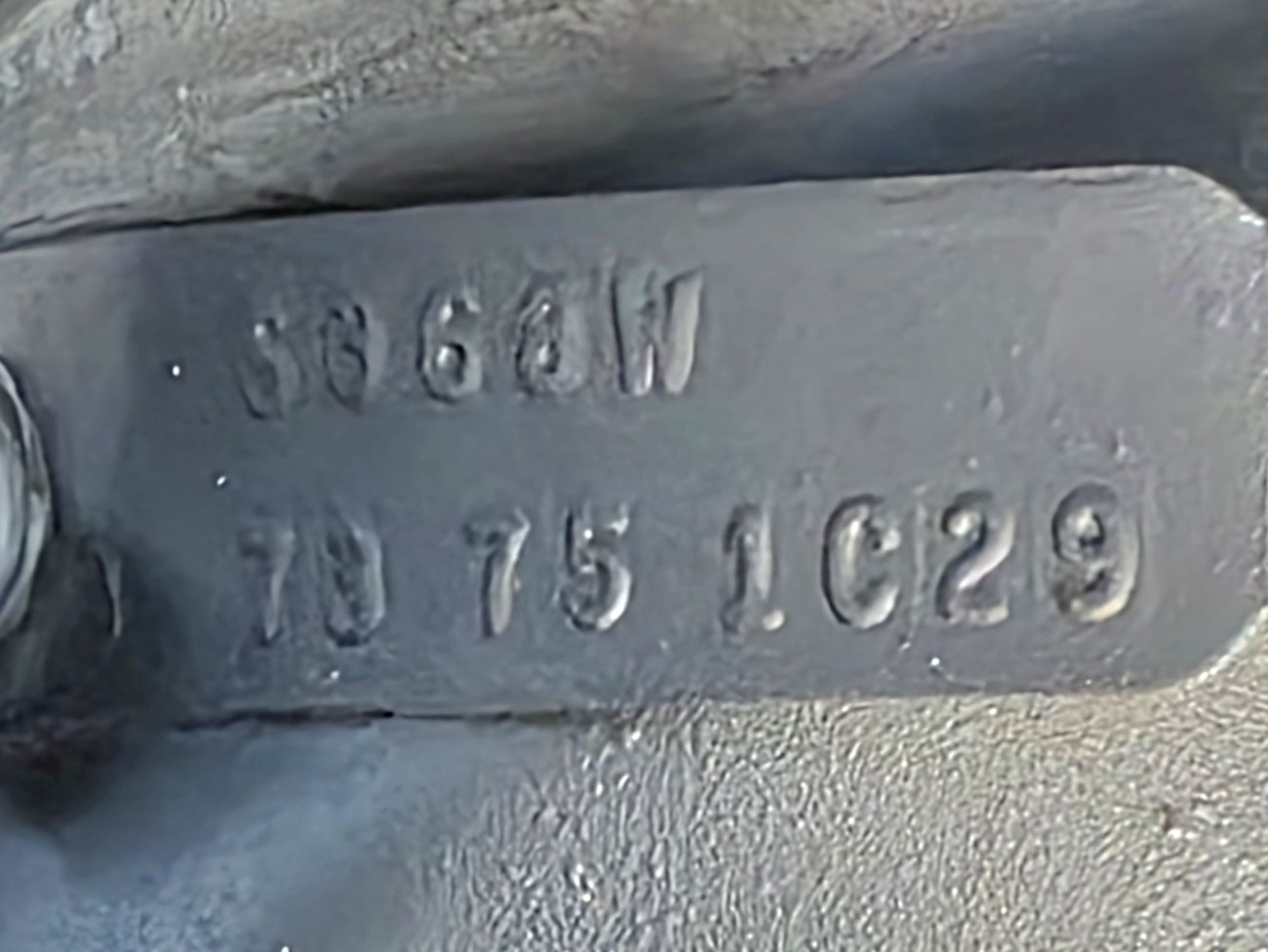

There should be a little metal tag on one of the bolts that holds the differential cover on that also has the rear end information. If your truck has been modified, I would go there first.
No modifications, so its stock. I looked at the tag yesterday, but more to figure out what I had. It's the 8.8 for sure. I'll record the numbers next time I am under there.
I like using a different cover gasket myself. ATV is fine... but clean up the next time it comes apart sucks.

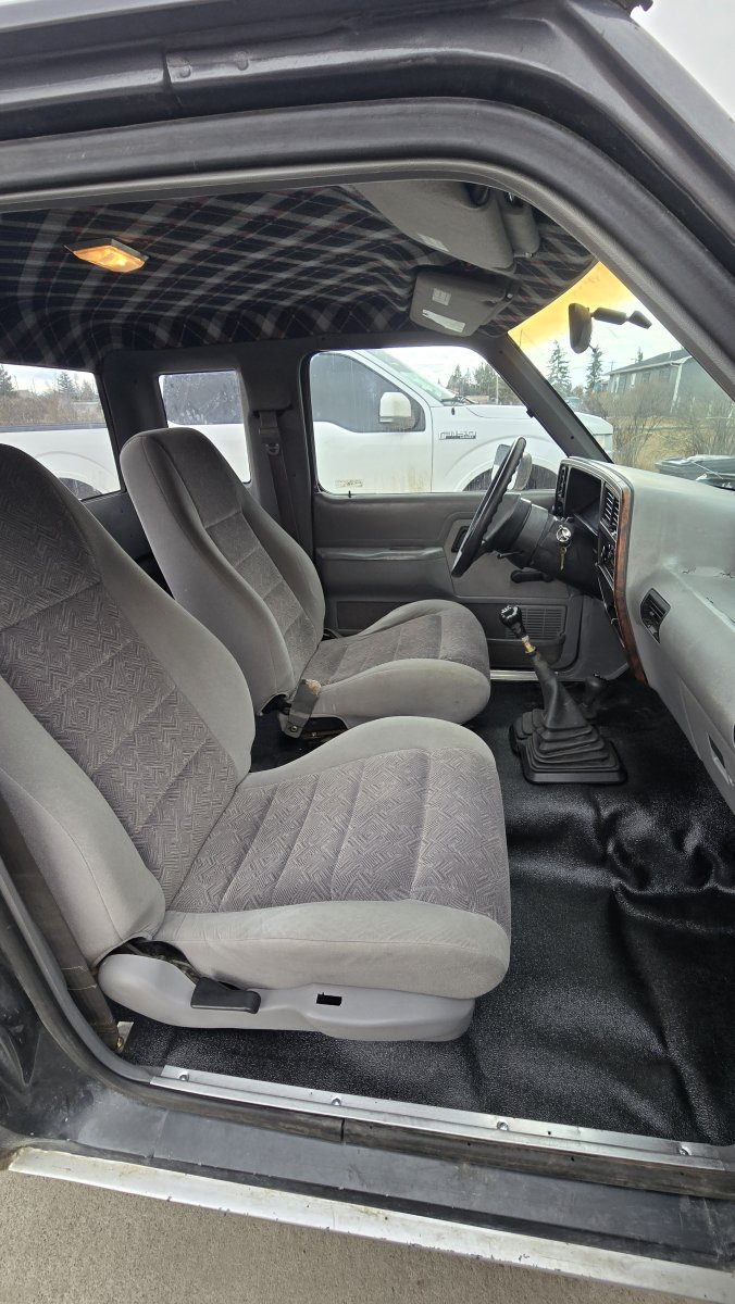

Went after a 97 explorer interior after reading a whole bunch about seat swaps. New vinyl floor, new headliner, new switches and buttons, it's styling.
I have the center console from the Explorer, it's going to be a hoot modifying it to fit the twins sticks but I think I can make it happen. Might do a thread about it, we'll see.
