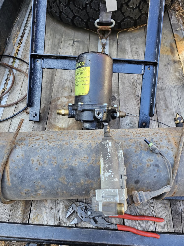

Not this morning but yesterday, fixed some shortcomings in my on board air setup, most notably, I swapped the non working Amazon special air filter for a small transport truck air dryer. With a little bit of wiring, a solenoid valve, and a relay I was able to get the purge cycle to work on it as well. It's a little bit of overkill but I'm happy with it.

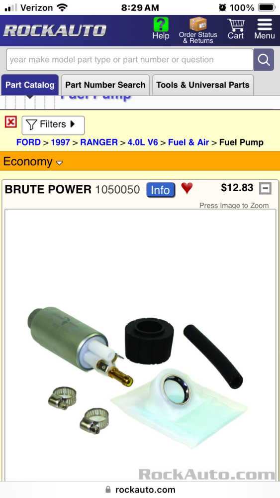

I looked online and found this:
I of course, googled for my truck, but then when I checked the vehicle fit, it said this pump would not fit my truck. Every place else it said it would fit the truck.

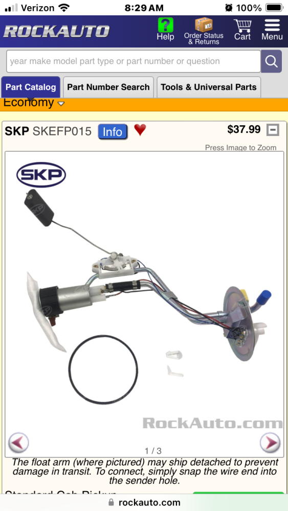

This was the alternate:
Here’s my question. Can I just get the pump and replace it on the assembly, or do I have to get the whole assembly? It’s hard to tell from the pictures, and I’m not sure how the tube that supports the float attaches to the top of the pump.

To me, you will have to do the same work in order to get the same result. So, it would be better to replace the whole assembly and be done with it. Especially, since the pump you have now is probably the original and is 27 years old, thus probably pretty rusty. If you have a plastic retainer ring, you can reuse that with the new pump but if you have the steel one, you will want to replace that as well. You might need a new seal for the hole as well so gas stays in and doesn't leak out.
As a side note, a number of people have had issues with aftermarket fuel pumps not lasting very long. Since the pump isn't easy to get to and one would want to only do the job once, I would strongly encourage getting a Motorcraft fuel pump. Those have a tendency to fix the problem and stay that way.

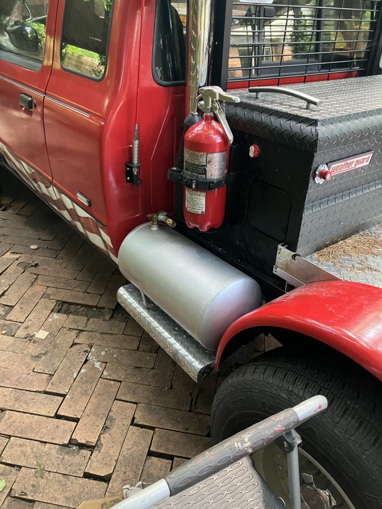

I pulled the diamond plate panel over the axles, and I crawled underneath to check out where the fuel pump was relative to the weatherguard toolbox. Of course it’s right dead center in the middle, a little off to the driver side. Crap.
If you look at the picture, the headache rack and the smokestacks are actually attached directly to the Ranger frame. The toolbox is bolted down on top of the 2 x 2 tubular frame I built, with some screw/bolts going into that headache rack.
All the wiring goes in and out of the box on the driver side, where the fill neck is, where the fire extinguisher is. I have a habit of leaving one or two coils of wire extra when I wire anything like this contraption. If I have to modify something, I don’t have to run new wires. I’m hoping I’m going to have enough slack that after I pulled the fill neck, I will be able to slide it over tilt it up, passenger side to driver side, enough to get the fuel pump out. If the wires aren’t long enough, when I put the box back, I will make it so I can unbolt it and tilt it up right to left without disconnecting anything but the fuel filler for next time, next caretaker
BTW, when I was modifying the fill neck to run through the toolbox, I had that pump assembly out. I don’t know if the items you guys asked about are plastic or steel, etc., But I have enough sense when I’m doing this stuff to check things out that I have to touch, and nothing looked bad on it or I would’ve replaced it at that time. It had a little drip on the return line when I got it, and when I modified the fill neck, the door is located about 6 inches closer to the centerline of the truck from when it was sitting on the side of the bed.

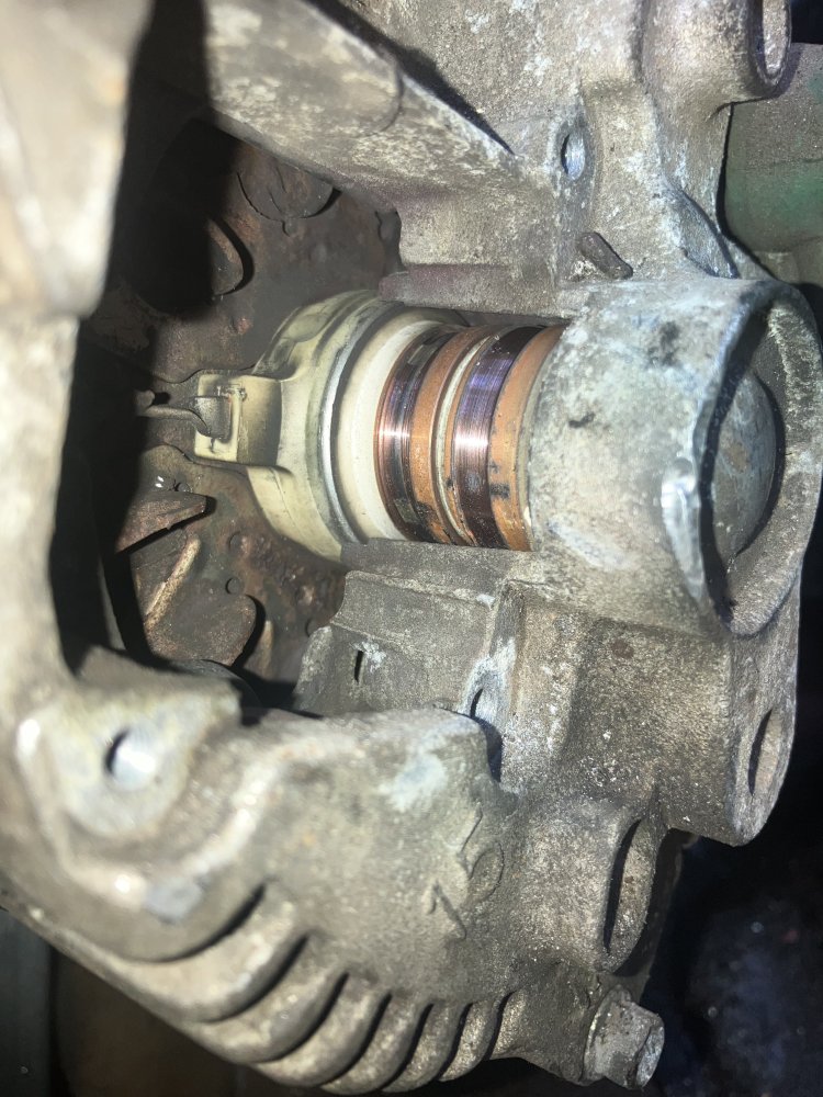

On a different note, I bought a voltage regulator/brush thingy for the Alternator and swapped it out. As I was doing it, I remembered that I did that shortly after I got the truck, which is only a few thousand miles ago. Battery light is still on, and alternator voltage is still low. Is there anything else I should check before replacing the whole alternator?
When I had the brushes out, I looked at where they contact the rotor, and it looked like it was worn down about a 16th - 1/8 of an inch or a little bit more, Which seemed like an awful lot
It’s the “4-hole“ alternator which I understand is the 95 amp. I’m going to go look at the pull-a-parts and see if I can find a “2-hole” 130 amp that will bolt in. I’ll probably grab the first 95 I see, and then simply leave it behind if I find a 130. I’ll probably start at the south pullapart, which has the greatest selection of trucks, explorers and Broncos. It’s the furthest away, so if I don’t find one there, I’ll probably hit the other two on the way back here.

Swapping a fuel pump in the sender can be a giant paint. I always recommend buying a sender.
However, my brother bought a sender for his ‘96 recently and the angle of the piping was all wrong it it didn’t fit right in the tank. So we had to take the pump from the new sender and put it into the old sender. So your mileage may very.

You were right about the wear on your original alt. That's to much wear. For what you ordered the new one for would be about what it would cost to have a shop repair the commutator rings, if they're the press off/on type.
Truck has 318,000 miles. Might be the original alternator. I said it a few times, but the guy who had it before me bought it new and did meticulous maintenance on it. He looks down on it from heaven now, he probably spins!
