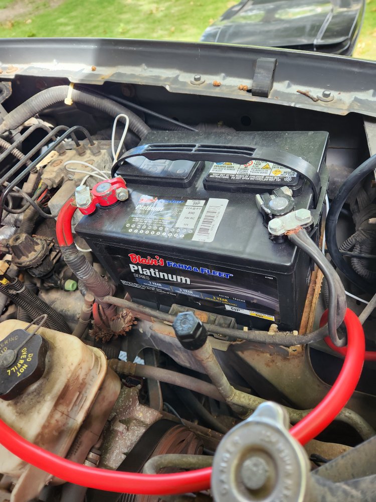

From this...
To this...
And a little of the other..
Gotta figure out lightning now...
From this...
To this...

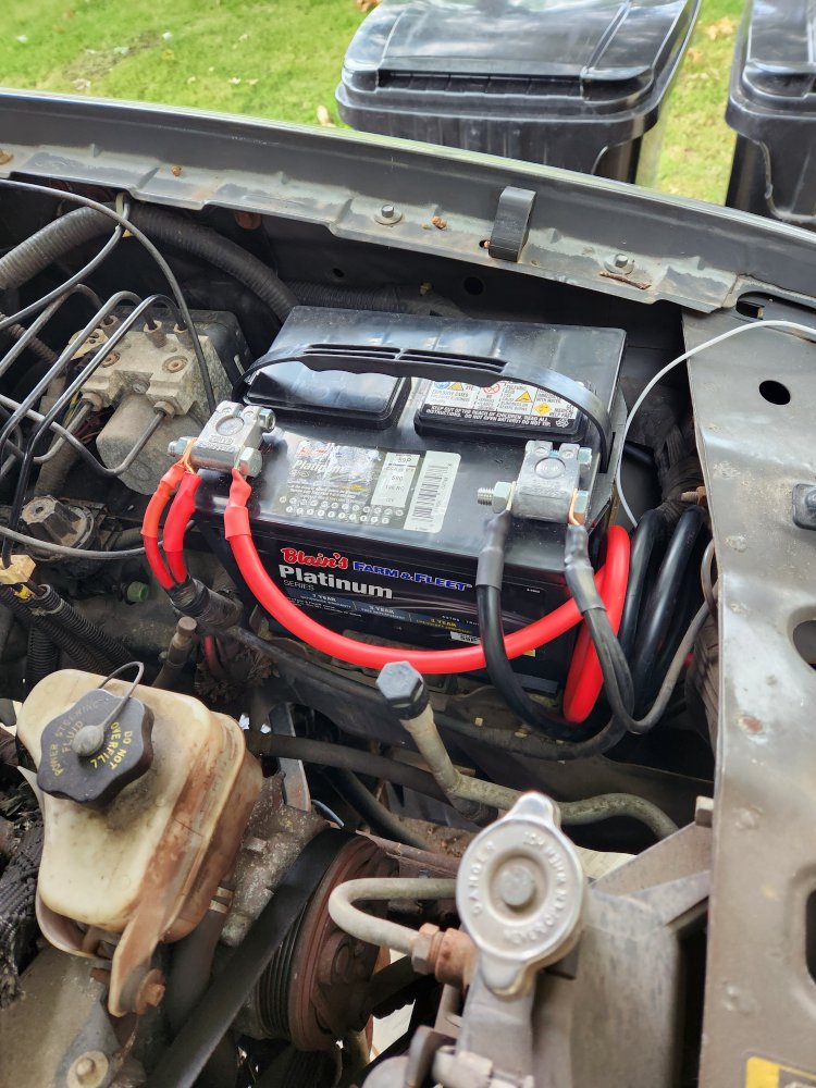

Are those post clamps from Amazon or local sourced? I went out of my way to get brass units and the one I installed lasted a month and broke while parked... and I didn't go super monkey tight on the pinch bolt or anything... I'm hoping they last for you and if they do I want to know what they are! Everything is zinc aluminum or sheet metal anymore and I don't trust it...
Out with the old...
I got the new MBRP system hanging in there. Gonna have a final look at it and adjust if necessary... then tighten it up.
I just plain ran outta gas for today.
I believe these are the clamps I bought. 4x4 junkie had post a link to them.
Battery Terminal Connectors, Military Spec Positive Negative Heavy Duty Auto Car Marine Battery Terminal,with 4 Pcs 2 Gauge 3/8" Copper Lugs,4 Heatshrink,2 Cover and Anti Corrosion Washers (Kit) https://www.amazon.com/dp/B09DKZRYZK?tag=959media-20
Time will tell if they hold up...
Edit to say these are like solid lead. They sure seem pretty robust.

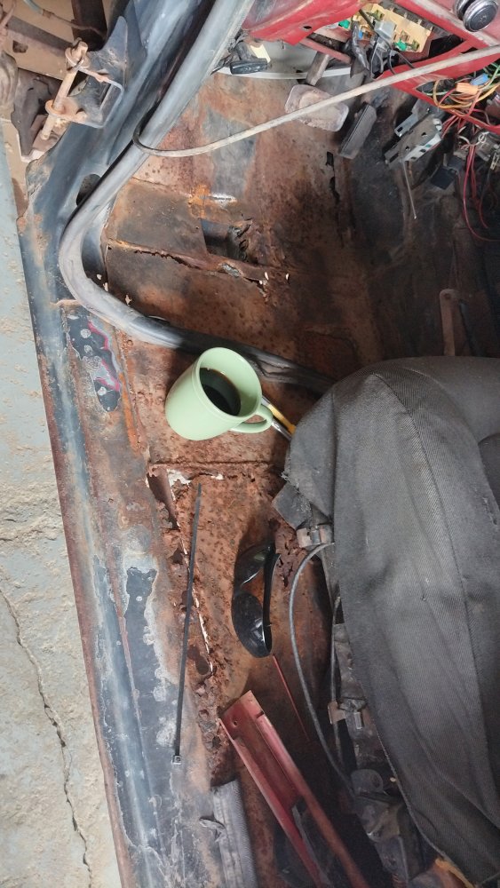

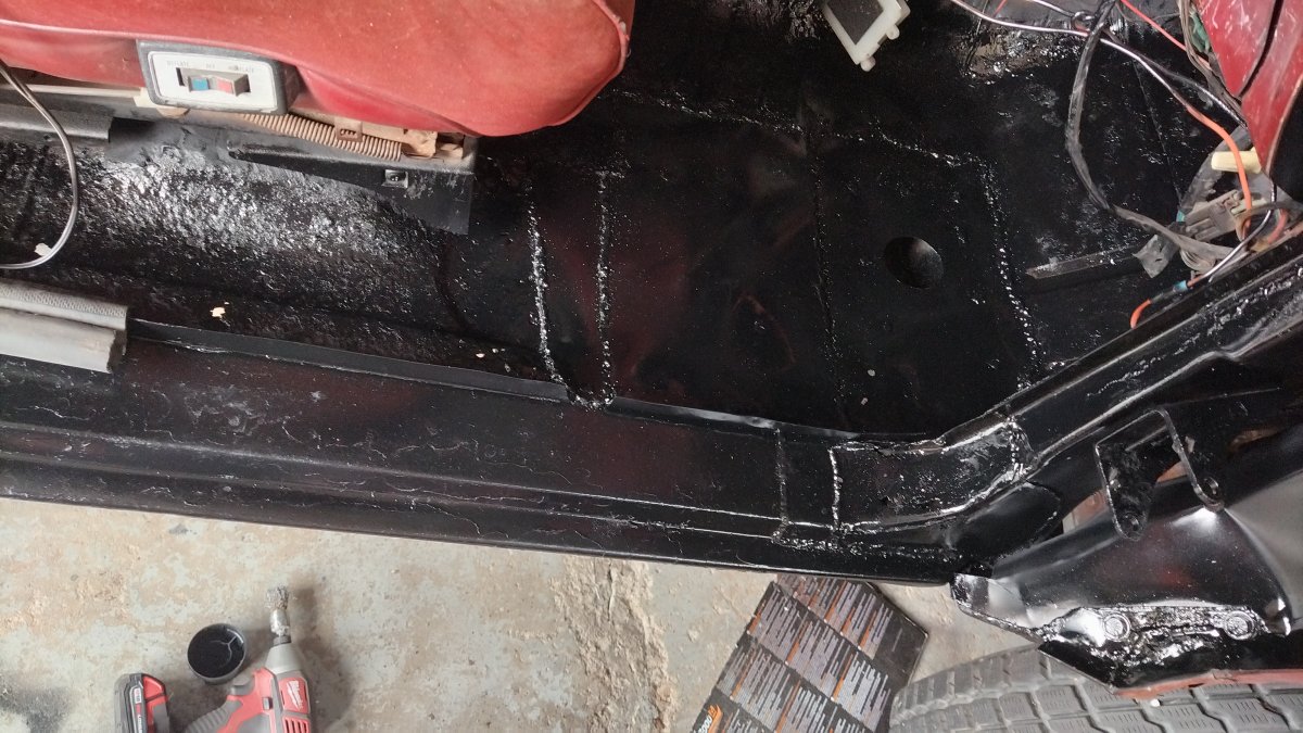

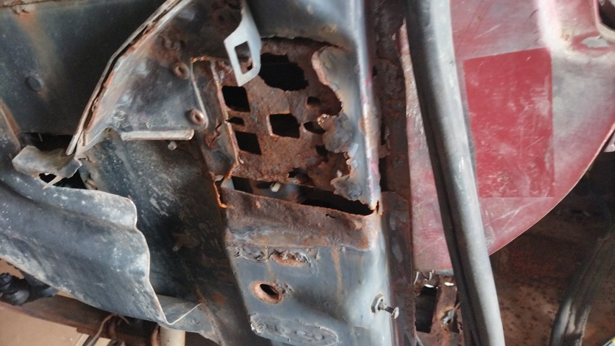

its 445 and i am hacking on the cab of the ranger....she is rough.
instead of cruising woodward..... going to a birthday and think i will try to get bob to go....he dont want to because they took all the fun out....i am shocked i am not there....its rainy though.
hopefully ranger will be patched up enough to get by a few more minutes.....again.
sux.....but i do not like taking it out of service....i use it too much.

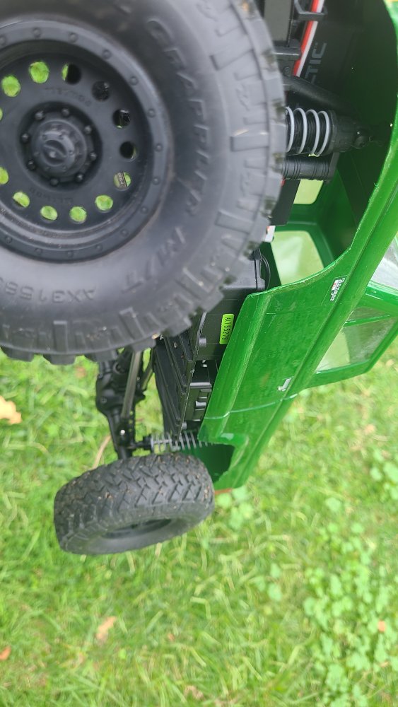

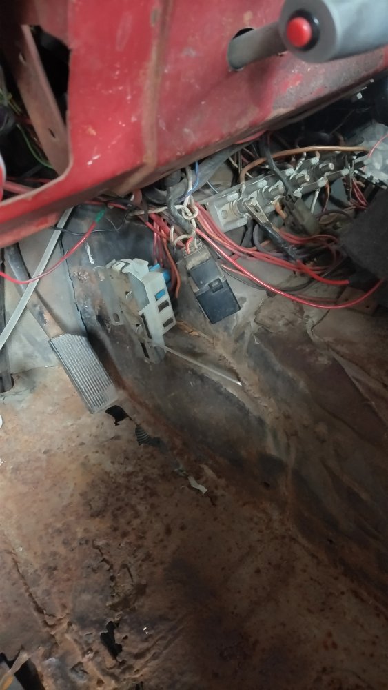

When I first built this thing a year ago it was kind of giving me vibes of a Mashup of our trucks. Fullwidth axles and big tires on yours and the body of mine.
Little did I know it also has the same floors as your truck too...

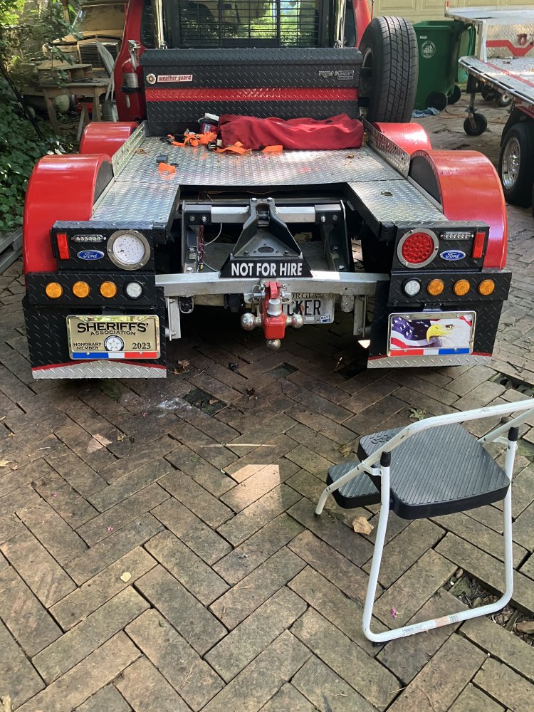

I took the trailer off The Road Ranger and played musical vehicles. My next focus is going to be the Lincolns and my F250 which have been neglected.

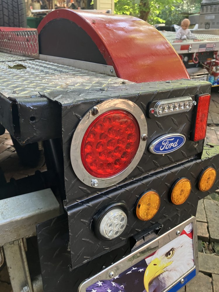

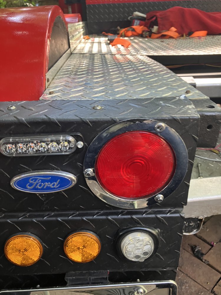

But when I moved the trailer away from the truck, I found this
Driver brake lens popped out somewhere along the trip. I had an extra pair, but they are a slightly different pattern, so I’m saving them for whatever project, and I just took an old-fashioned tractor-trailer type lens, shaved the edge so it would fit in the bezel, and glued in with some shoe glue. Of course, temporary.
I’ll either replace both with the pair I’ve got, or maybe buy a new one online hoping it will match either set.
it never ends….
View attachment 115466View attachment 115467
I swapped out the 21 LED tail/stop light with one of the ones I had in the shed of miracles. If you look real close, it’s a hair different, but it suits the hell out of me.
The other issue I had were the sequencing turn signals. On the same/driver side, it was only through two lights. The one in the outside wouldn’t come on. It was a loose wire, problem solved, but…
When I was looking at them, checking them with the four-way flashers. They sequence with this little 12 or $13 module out of China on eBay. Well, the one on the right goes 1– 2–3. When it shifts, the light before goes out. On the left, it goes 1 – 12–123. They sequence outward, but once the light comes on, it doesn’t go out till they all go out.
I’m going to put fixing it pretty low on the priority list, but that’s the kind of thing that makes me crazy.

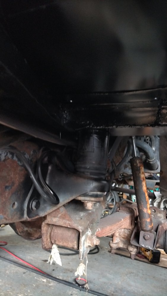

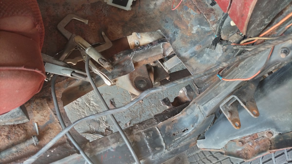

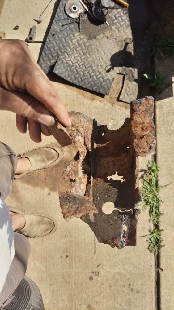

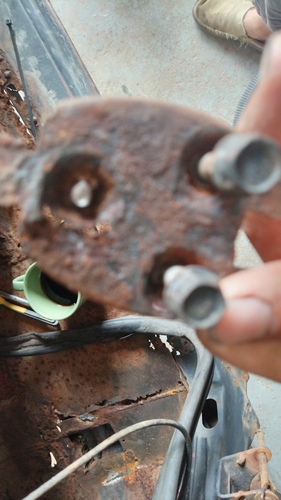

its less flintstony again for a minute. still need to beef up the drivers side....
the mounts were totally crushed.. just used old 3/16 strap and some rusty ass scrap sheet metal and fluxcore.
hopefully i can get a cab soon .... maybe in oct when we go to sc. just need to keep lil bob safe
i was beating the hell out of it out back...and it didnt fall off..
so....its good.
