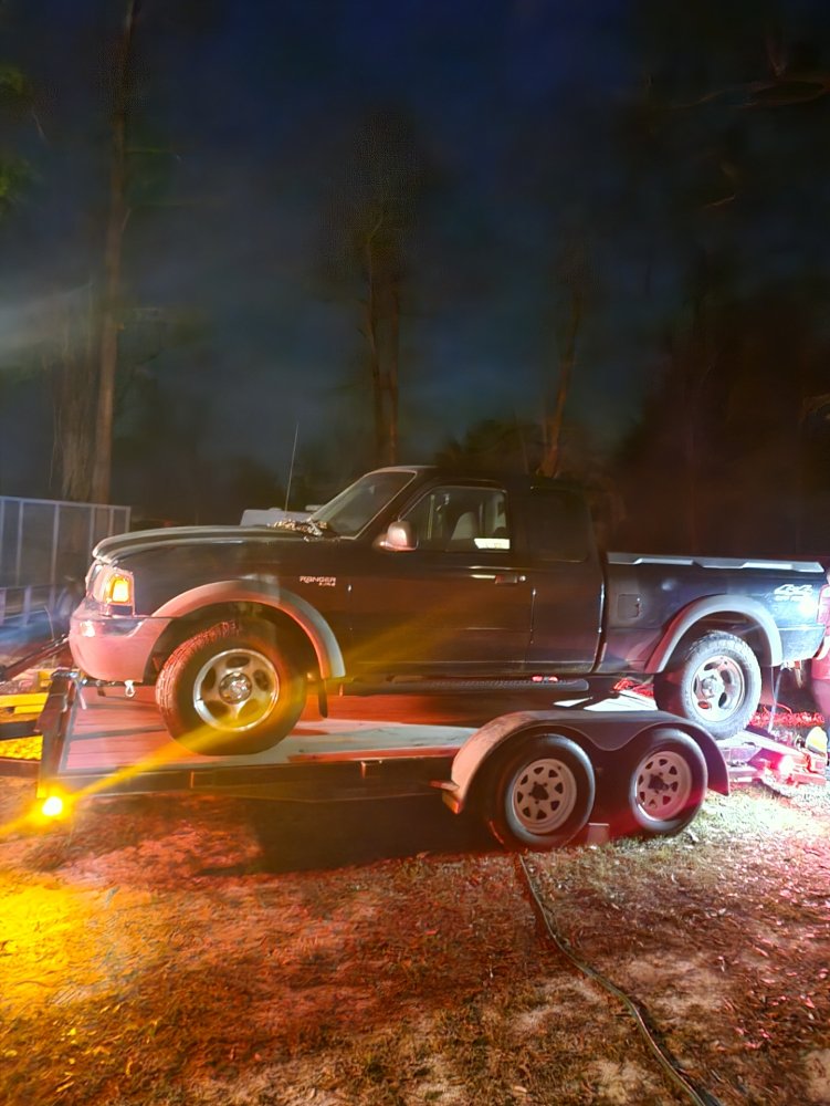

Scrap it, sell it, or sending it to the shop?
Sold it to a cousin. Took a loss, but with the B2 to occupy my time now, I wasn't sure if I'd ever get back to it. Plus the wife wanted a new yard ornament.

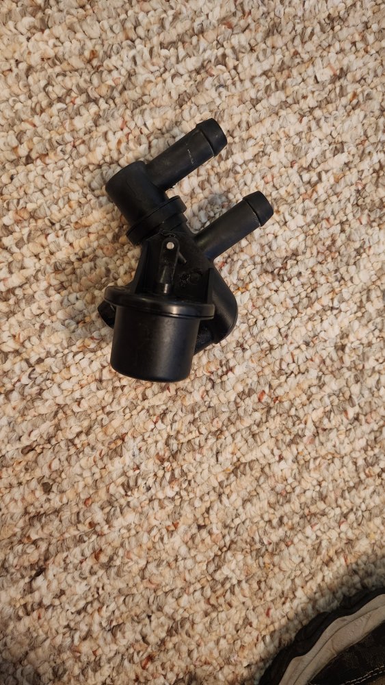

I loaded it with yard waste (mostly sticker bush trimmings from last fall) and tried to drive it to Greencycle to get rid of the sticker bushes.
Didn't get far. Vacuum activated heater control valve let loose, I thought I blew a head gasket as it was peeing antifreeze right onto the passenger manifold. Got a bit of attention when I pulled into autozone.
Bought the last one at autozone and luckily I had my tools with me and 60 bucks and 15 min later I was on my way. Almost 20 of that was 2 gallons of antifreeze...
That makes for an exciting trip. Don't know whether to use a sad reaction because it happened, or a thumbs up because you were prepared and fixed it. I'd do both if it would let me.
