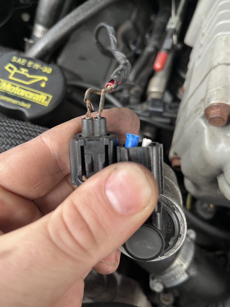

Spent some time trying to get the IAC correct.
The original connector pushed the wires heavily into the heater box. I had originally flipped the valve 180 but it didn’t work correctly. The valve was bypassing and it was idealist high.
I flipped the valve back around and replaced the oem connector with a couple of spade connectors. I only needed to gain about a 1/4”.
Giant PITA to get at the IAC without pulling the intake.

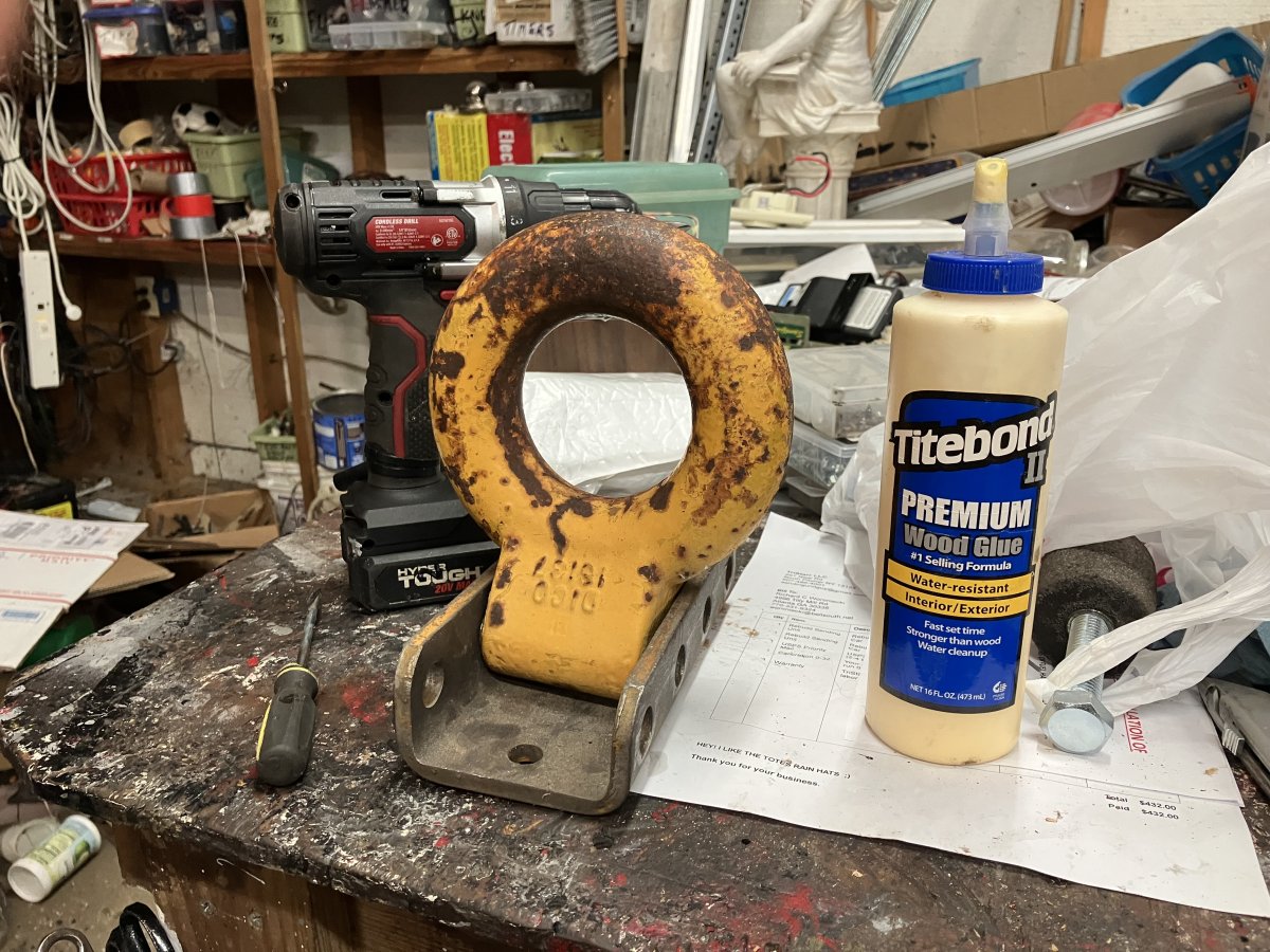

I laughed out loud. Not all of my bargains work out exactly the way I think they will.
My $10 Pintel/lunette ring came in yesterday (plus $18 shipping). It’s huge, like you would use on a D9 bulldozer to pull the Titanic. I’m going to need a trailer just to bring it over to my trailer to see if it will fit!
I already figured out what I’ll use it for, but I’ll have to get a normal size one for my little trailer or the truck/trailer combination will sag in the middle.

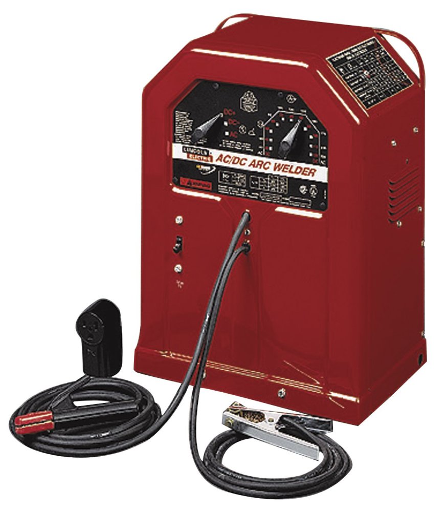

By the way, Titebond is good stuff. But it won't hold that ring on the truck very well. You need Lincoln metal glue for that.
Ha ha, tight bond was to fix sweet peas chair in her den. Beautiful wing back she has had for 40 or 50 years, and when the hefty grandson sat on it, it turned into a beach chair immediately. All the dowels and sockets were worn out in the front. A relatively easy fix, and if you know sweet pea, getting it back was probably the best Christmas presents.

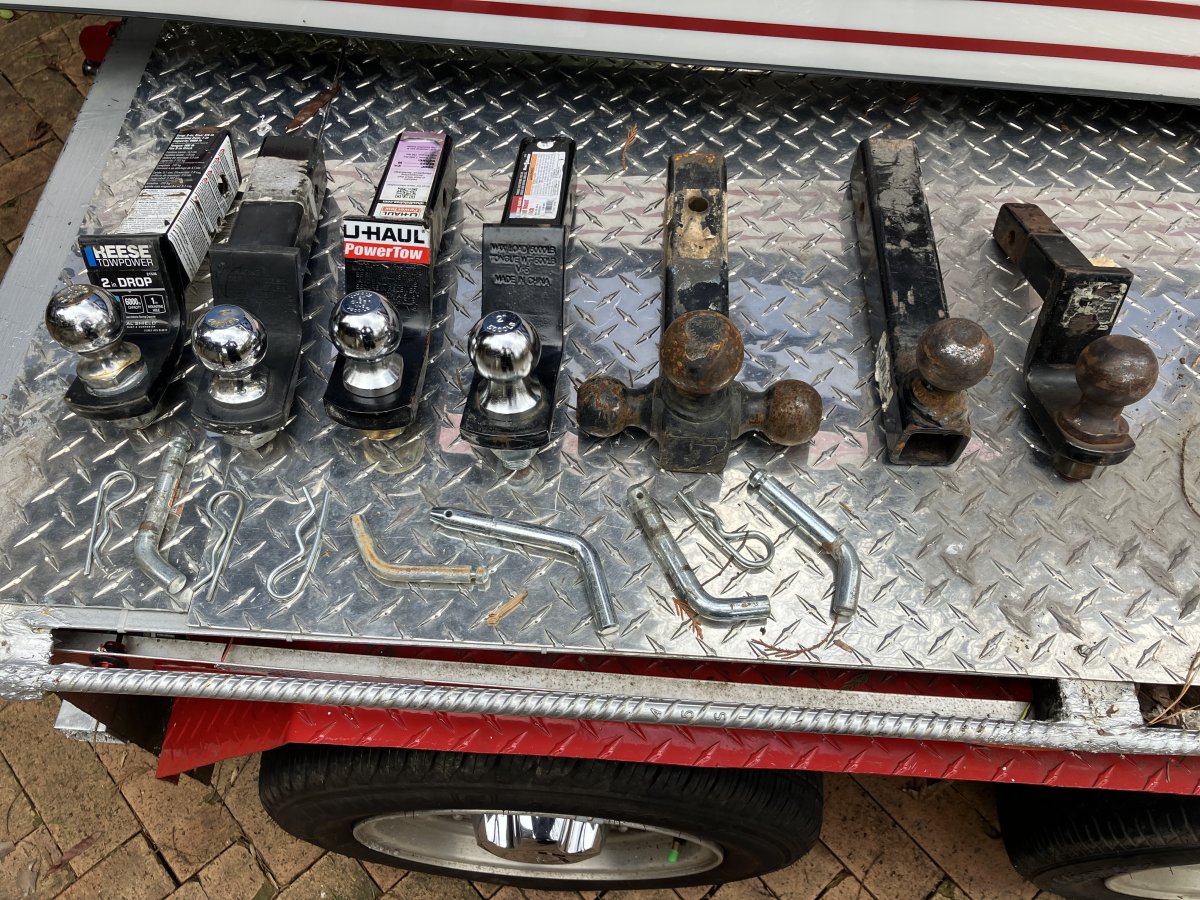

Another Facebook marketplace score:
$35 for all. I’m starting an “extras” pile that I’ll sell once I’m sure I have everything I need for my hair brained schemes. I’m sure I’ll get everything I need and run a net profit. I think it’s the only way I could justify screwing around with stuff like this.
that is a pretty decent colletion of shinbangers...
