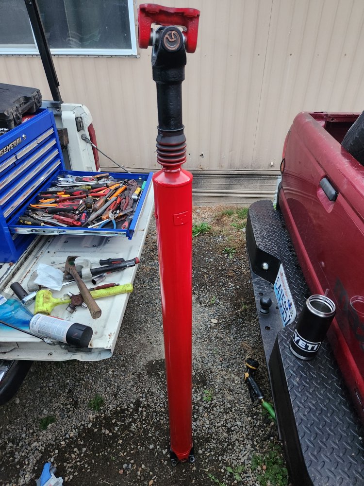

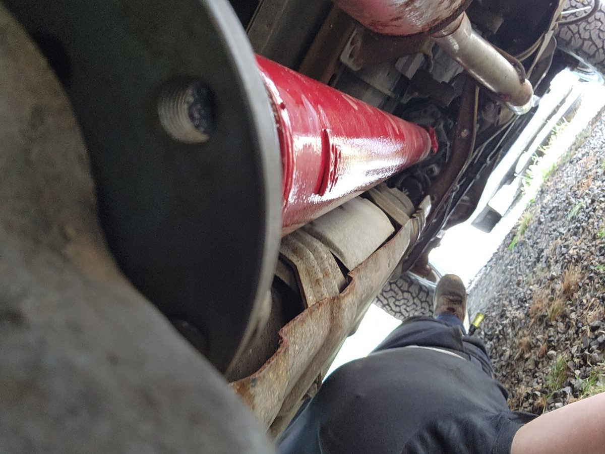

Well I went put to the big junk yard, about 20 acres of cars, and started searching for a single peice driveline for the 89. I found one a spicer product, had a single small shallow dent in it, but I'm not putting it behind a torq monster soo. Got it home got the remembered I have a u joint tool, so no more socket and hammer like last weekend. Got it apart, had a good amount of surface rust cleaned and sprayed with rust converter, than some enamel paint. I need to grind the rivets off the crossmember for the carrier bearing mount. Also got a set of air shocks to install.
OK well I worked into the dark got the air ride shocks installed. Will just need to drill the hole for the Schrader valve. Going was slow due to the contents of that yeti cup

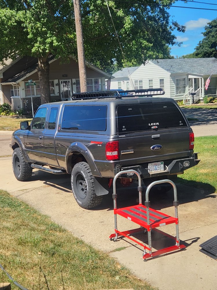

Got the '96 insured and registered yesterday.. took it for a ride to get cat litter and put some gas in it.
Felt good to be back in a little truck.. needs some tinkering though. I feel like front end needs some attention? Although having never driven a TIB vehicle before... it might just be how these drive lol šŸ˜‹
I haven't done it yet... but I wanna.
Probably gonna create a new level of road noise.
Probably lose a mpg with it... two with the canoe.
Still considering drillin holes... what y'all think?

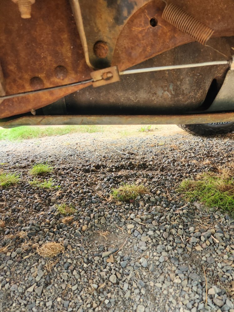

And for those who said JUST remove the carrier bearing mount, wish engineers could over engineer everything like they did the metallurgy in them rivets. And I also disassembled part of the original parking brake adjuster to get this part to conect the 2 ends.
I would mount that on a removable low profile roof rack if it’s in your budget. You’re still drilling holes but you won’t taking the mpg hit until you need to.
A set of racks is going to be about a 1 mpg hit with aero bars and there will be some whistling. Throw an air dam on there to eliminate the whistling will cost you another mpg.
I have no idea what a basket will do but it will drop the mpg and it will probably be noisy.
I had a basket on the roof of my old turbo outback.. IIRC the only time I really noticed a meaningful amount of noise was during cross-winds.

TIB?
I’m lost. Drill what? Tires will go flat if you mean them….
