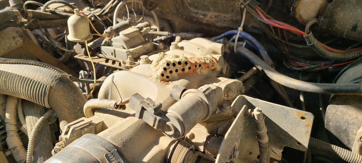

Found some artwork on the intake manifold.

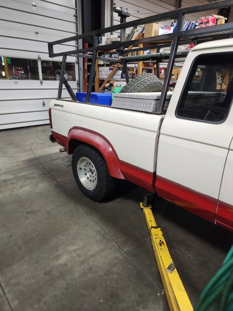

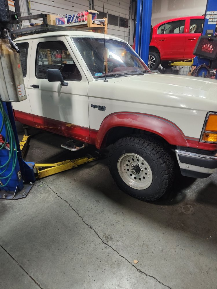

Got the new socks and shoes on the 89, realized
we orderd the wrong shocks, it's so nice on Saturdays when there are only 2 techs at the shop I can work on personal stuff between calls, mounted and balanced by myself for free.
