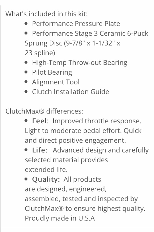

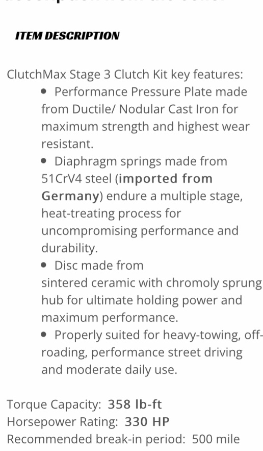

The Road Ranger’s clutch would slip if I pushed it when I got the truck with 305,000 miles. I knew I needed a new clutch, and I wanted one with more grab because of what I was going to do to the truck, semi pulling a trailer.

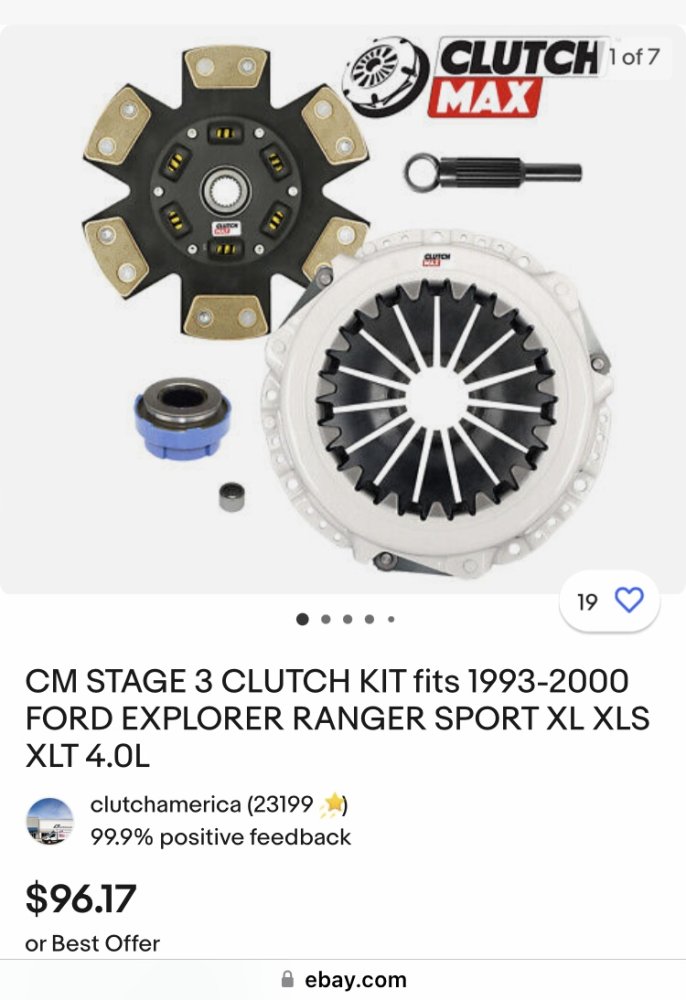

My 15 or 20 minutes of research, talking to the guys at NAPA, etc., led me to buy a ceramic clutch. I bought a kit with the heavier pressure plate. This is what I got:
When the guys were installing it, there was wear on the pressure plate, so they got one from NAPA, I don’t know which one, probably stock, to keep the work going to get done.
I LOVE the way it grabs and holds, I’ve already pulled a 16 foot heavy trailer with an Isuzu rodeo on top, and it pulled like a dream.
The downside is I’m a feeble old curmudgeon, and the thing is killing my left knee/leg. Also, it grabs so low and so hard (exact opposite of the new normal clutch in the 87 Missing Linc), I either screech the tires or stall it. I’m driving like a stick shift newbie. (I haven’t figured out where the sensor is, but it seems to do it more when there’s people standing around than when I’m all by myself.)
View attachment 92147View attachment 92148View attachment 92149

I’d have to look for the box, but I bought a stage 2 or 3 clutch years ago for my F-150 and it’s like that. A heavy sucker that works more like an on/off switch than a clutch. Probably a tad excessive, but like you I figured it would be a good idea with towing and hauling.
My choptop got a Duralast clutch kit from Autozone. Almost want to say it was stamped LUK even though the box didn’t say it. It’s been fine, but it doesn’t have a ton of miles on it since I can’t seem to keep an engine in that truck.
Every puck style disc I ever used was on or off. They aren't very forgiving... but hold well.
I didn't even use them much for our drag buggies. They grab so well we would break shit nearly everytime out.
That's exactly why I didn't want a puck clutch, the centerforce drives like a normal clutch but apparently grabs like a mofo... it's only got hot on me a couple times which was likely from getting oily...

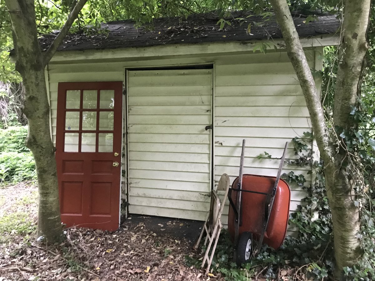

Used the Missing Linc to fetch a door and a couple windows to convert my shed (The actual original shed of miracles) into a gardening shack. Vintage, solid oak, two matching windows, two locks and keys, $40. Can’t go wrong.
