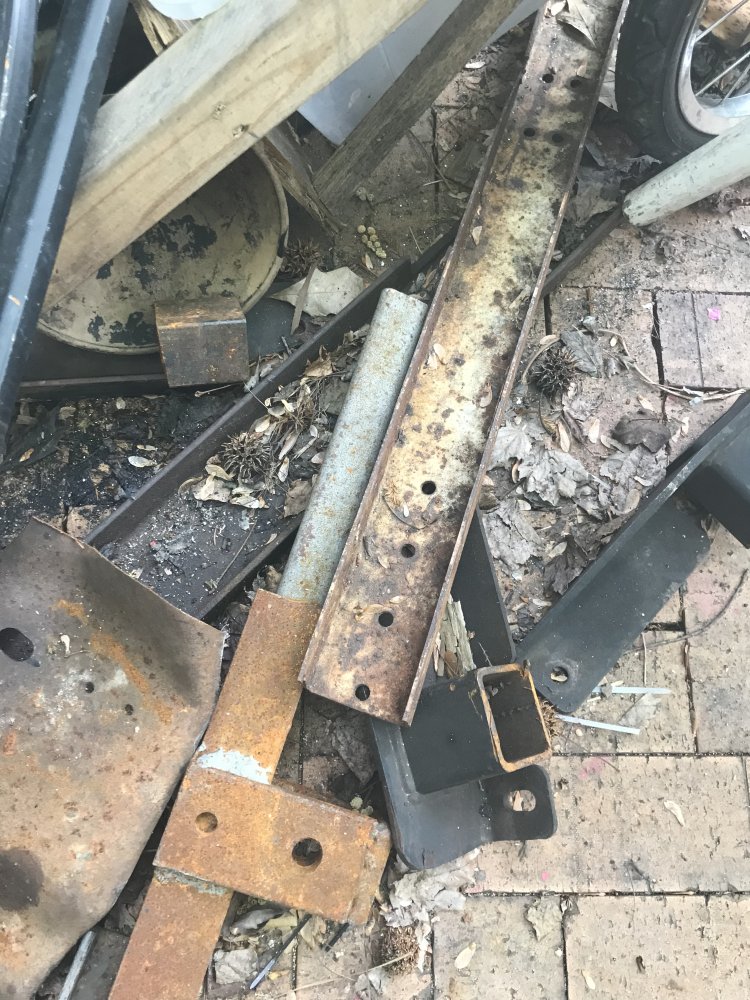

Really didn’t get much done on the Ranger today, but I did get a few things done like putting loom and wrap on the fuel tank sender harness that I repaired yesterday I think it was. Really kinda need the frame sections if I don’t want to do a bunch of work twice.
Is this them?
I’ll look in my shed of miracles again…
Question: Do the raccoons drive a Ranger? Is it Rusty? maybe they took them
Lol, let me know if you find them because I’m kinda baffled at this point. Thought I remembered them being in the box truck, but they’re definitely not there now. I know before we got kicked out of the garage my buddy was renting off a neighbor, they were there. Some of that stuff went in my buddy’s garage and some came here, but I no longer remember exactly what went where. Couple concussions will do that to you I guess.
Pretty sure the raccoons don’t drive and Rusty wouldn’t be interested because they’re for a newer Ranger than he owns. Those older ones don’t seem to rust as bad in the frames either.

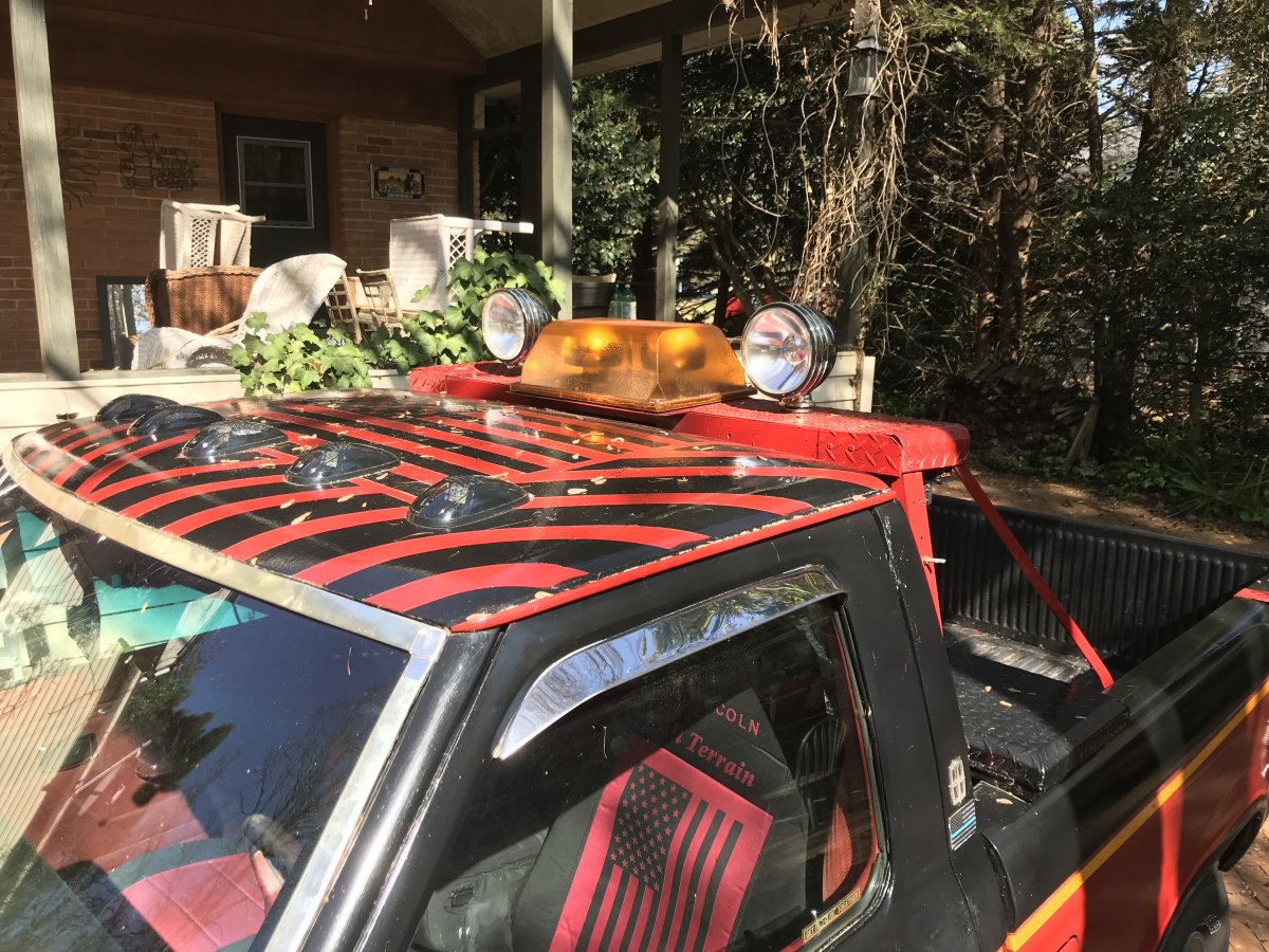

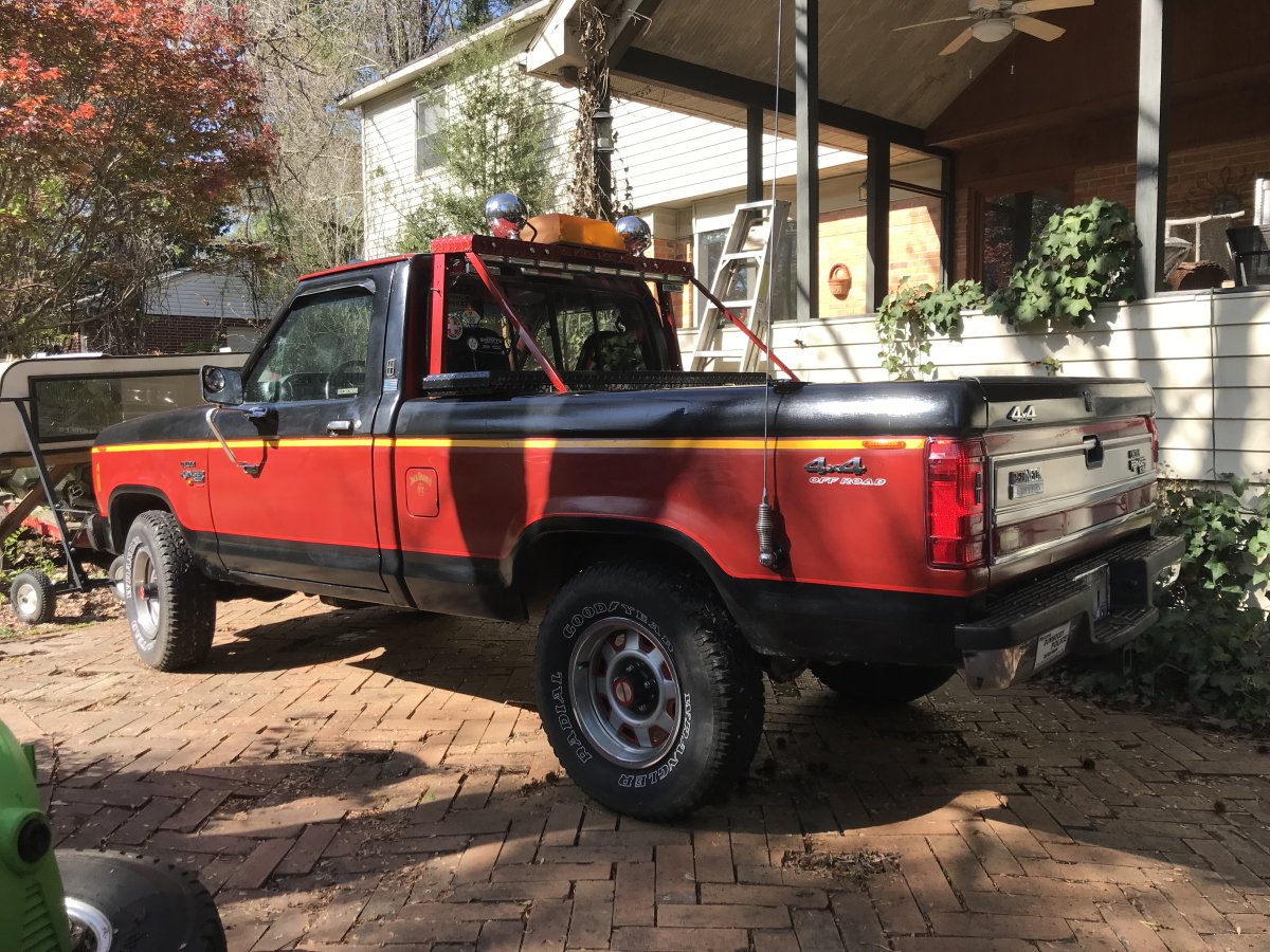

Another Missing Linc detail: Back in the day when I scoured the scrap yards (1970s) I grabbed every pair of fender indicator turn lights off the mopars. I must’ve had 10 or 15 vehicles over the years where I mounted them on top of truck hoods, once on a Ranchero, etc. We’ll, now there is rare as hens teeth, on line for $70 & up, and I used my last set probably 15 years ago. I searched online but couldn’t find anything like it.
What I did find were windshield washer nozzles that had an LED light at them. I think the low riders use them on cruise nights mostly. Well, I installed a pair on The Missing Linc facing backwards up on the hood corners.
One thing I figured out over the years is to wire them into the trailer tail lights after the fuse. That way, if they’re not working, I know my trailer lights are probably not working. You can get them in different colors, these are red. So when I step on the brakes they go on, and they also flash with the turn signals.
I really wanted the Mopar ones because of the quality, but then I realized I can get an extra windshield washer reservoir and hook a button up on the dashboard and squirt anybody who walks past. Top priority for my next trip to the pull a part.

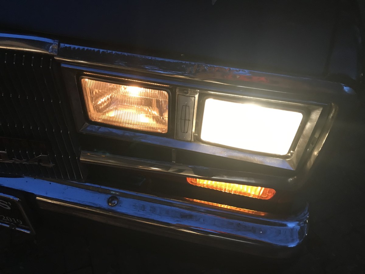

One last thing I did with the wiring by accident, but I’m going to keep it now, is when I put in the Town Car dual headlights, I put the ground on the high beam and the high beam on the ground. So when you have the low beams on or the high beams on, they ground through the other circuit instead of the ground. That makes one bright, and one kind of dim/Amber. They reverse when you turn on the high beams. I’ve been complimented on it a couple times before I even realized what I did. Now I think it’s too cool to give up. It’s great when your screw ups work out!
Soooo, i’m planning on sanding and repainting the black above the yellow line, and I have some stickers/graphics on order for the Missing Linc and the Road Ranger. Probably a dozen things I forgot and a dozen more I still need to do. But here it is. All I get are smiles, and, amazing to me, it is a chick magnet!
I’m still debating whether I’m going to swap out the Ranger steelies for a set of Lincoln turbine wheels. If I use the turbine wheels, I plan on polishing the ribs and painting the spaces in between with the same regal red as the truck.

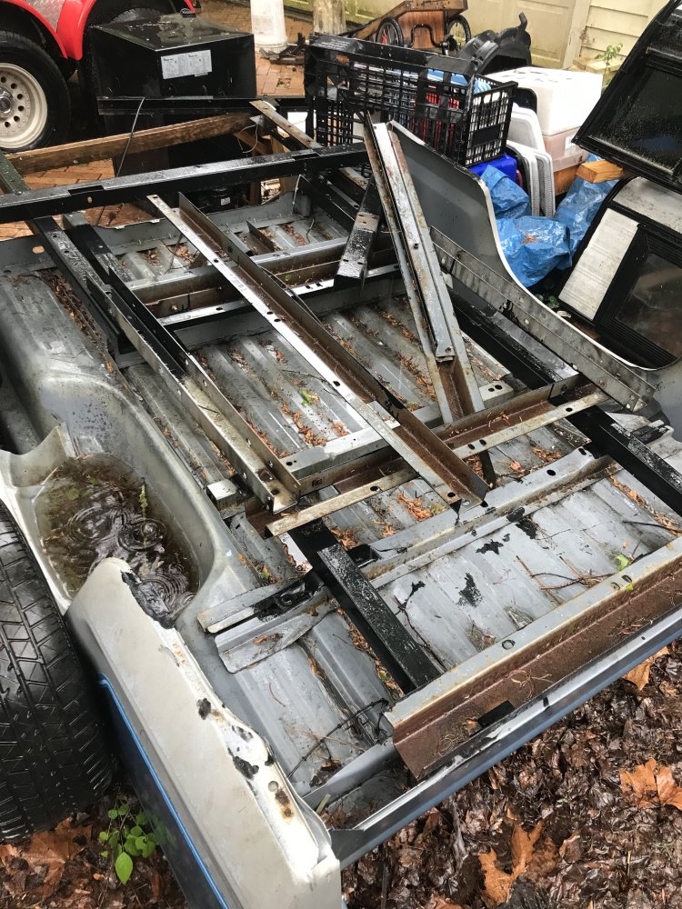

I bought 4 or 5 Harbor freight trailer‘s For no money during the Covid craziness. I modified one of the trailers to go under the Ranger bed, and I’m putting this axle on that frame so I can run ranger wheels that match The Missing Linc.

I took all the wiring and all the lights off the bed, flipped it over and then I removed all of the various plates and shields that are not part of the bed structure itself.
I laid two 2 x 2 x 1/16” square tubes from the end of the bed deck extending about 2 feet past the front of the bed, n line with the six bolts that held the bed to the frame. The bed will ultimately be bolted to the frame through these tubes.
I took the axle & springs off the harbor freight frame, and then I flipped it over onto the upside down bed with the 2 inch tube. I kept four of the five crossmembers, and I moved the spring mount channels more to the center so they will clear the ranger wheels in the wheel well. The 2 inch tube and all the harbor freight parts will be welded together. If you consider the loading, they really don’t have to be very significant welds, just enough to keep everything from shifting.
I have some extra 1/8 inch diamond plate, so I am going to face the front of the bed around the toolbox so nothing looks unfinished. I haven’t mounted the toolbox yet, but my thinking is I’m going to create a slot between the frame and the bottom of the toolbox large enough to hold one of those skinny 14 inch trailer tires as a spare. I want to do it so the top of the toolbox remains even with or below the top of the bed. My concept is the tire will slide in and out under the toolbox, and I can secure it simply by dropping a bolt through the bottom of the toolbox through the middle of the tire. If the toolbox is locked, the tire can’t slide out.
Then I’m going to use the harbor freight pieces to reassemble the tongue so the front corners of the toolbox don’t hit the corners of the truck while I’m towing it.
I have an 88 bumper with the brackets. There are horizontal holes and vertical holes. I lined up the 2 x 2 tubing so I can bolt the bumper on the same way it mounted to the truck frame. I since realized that the bumper on my 87, the Missing Linc, is actually from a later model truck. So I may go find a matching bumper since I plan on painting the trailer exactly the same as the truck.
In hindsight, the only thing gained from the harbor freight trailer (which cost me $100) was the springs and the spring mount channels. I plan on doing two more of these, and I’m probably going to skip the Harbor freight trailer, and just fabricate the frame out of the 2 inch tubing and regular trailer parts. I usually don’t plan these things a lot, I get a concept, and then I throw them together with whatever is in the shed of miracles and the yard.
I got a 5 x 4.5 axle and hubs from another hundred dollar trailer, the one I just put in the post a couple days ago. I’m selling the trailer for more than it cost me, so theoretically these parts are free.
I plan on reusing and remounting the fender struts, the lights and wiring harness, etc.
Edit afterthought: the 87 has a 2 1/2 or 3 inch lift. I’m not going to weld the spring mount channels to the frame until I fit the axle so the ride height matches the ride height of my truck. That means I might have to space the mount channels down, or I may have to use a long shackle spring connector.
Edit afterthought afterthought: I had the 1/8 inch tubing and rust really isn't a problem down here, but I might bump it up to 1/8 if I lived in the Rust Belt. Also, I’m doing it where I can flop the trailer frame down and paint it all over before I built the bed on it. Yep, Rustoleum…

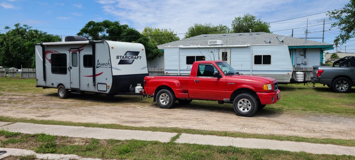

Had to use the ranger to move the small travel trailer
