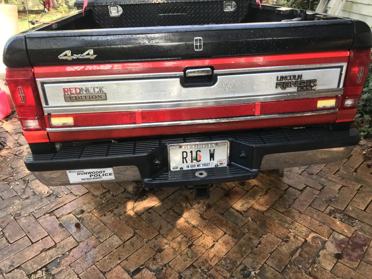

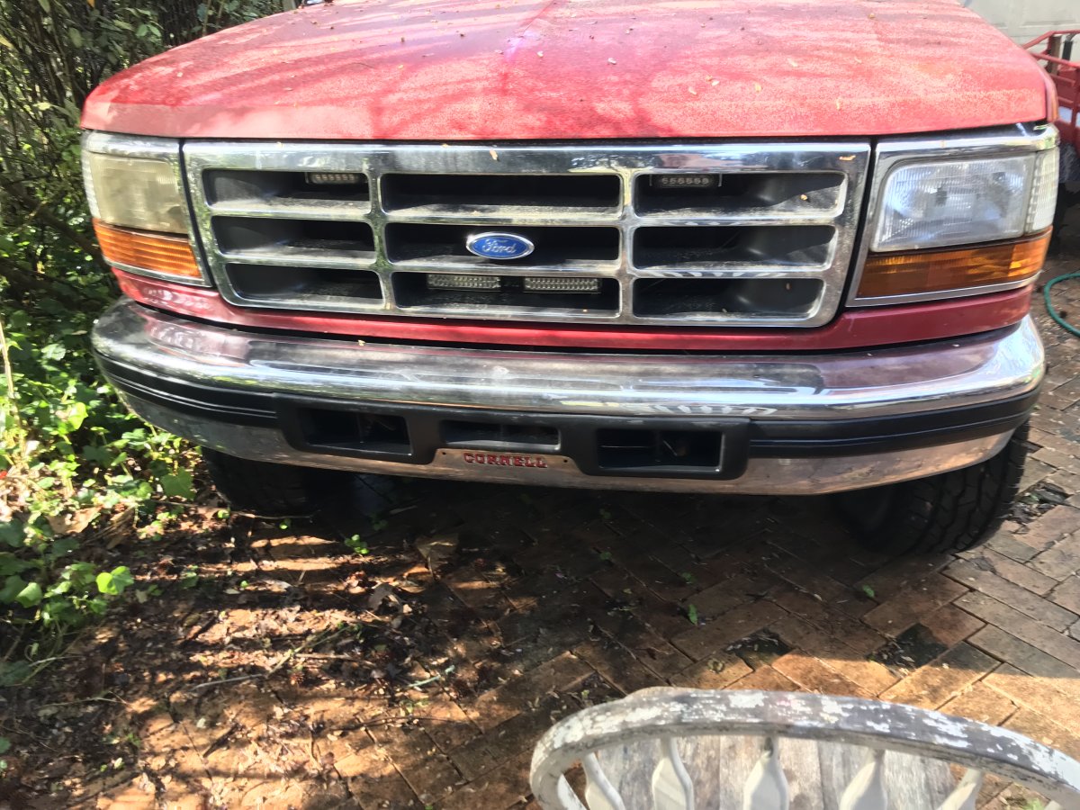

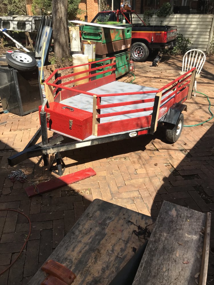

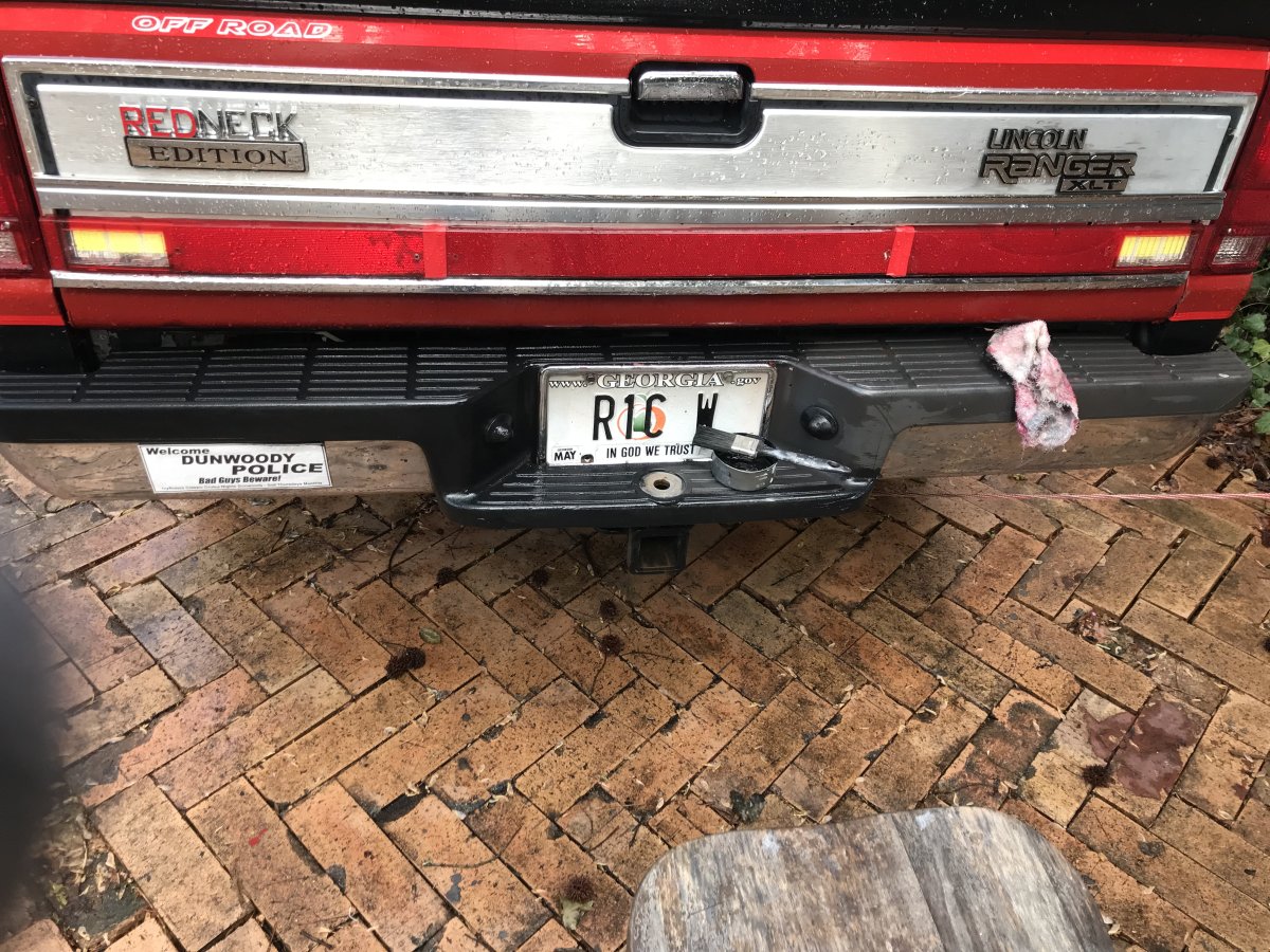

Painting day here. I put Forever Black on The Missing Linc’s back bumper pad and the front of Big Red. Working on a trailer I’m selling too, rebuild a Town Car starter
Don’t know, how heavy is the first winch?
The first winch is 5000 lbs in the front...very light. It's not meant pull an overloaded F150 out of the quicksand.
I am a city boy. The ground is level and paved. Still, from time to time, somebody gets stuck, usually when the snow plows plow them in. 5,000 lbs is plenty for that. Sometimes, however, people get stuck in tight spaces. It's good to winch from either the front or the back of my truck.

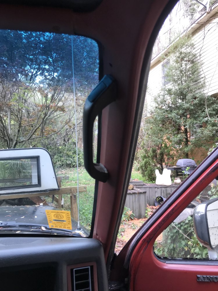

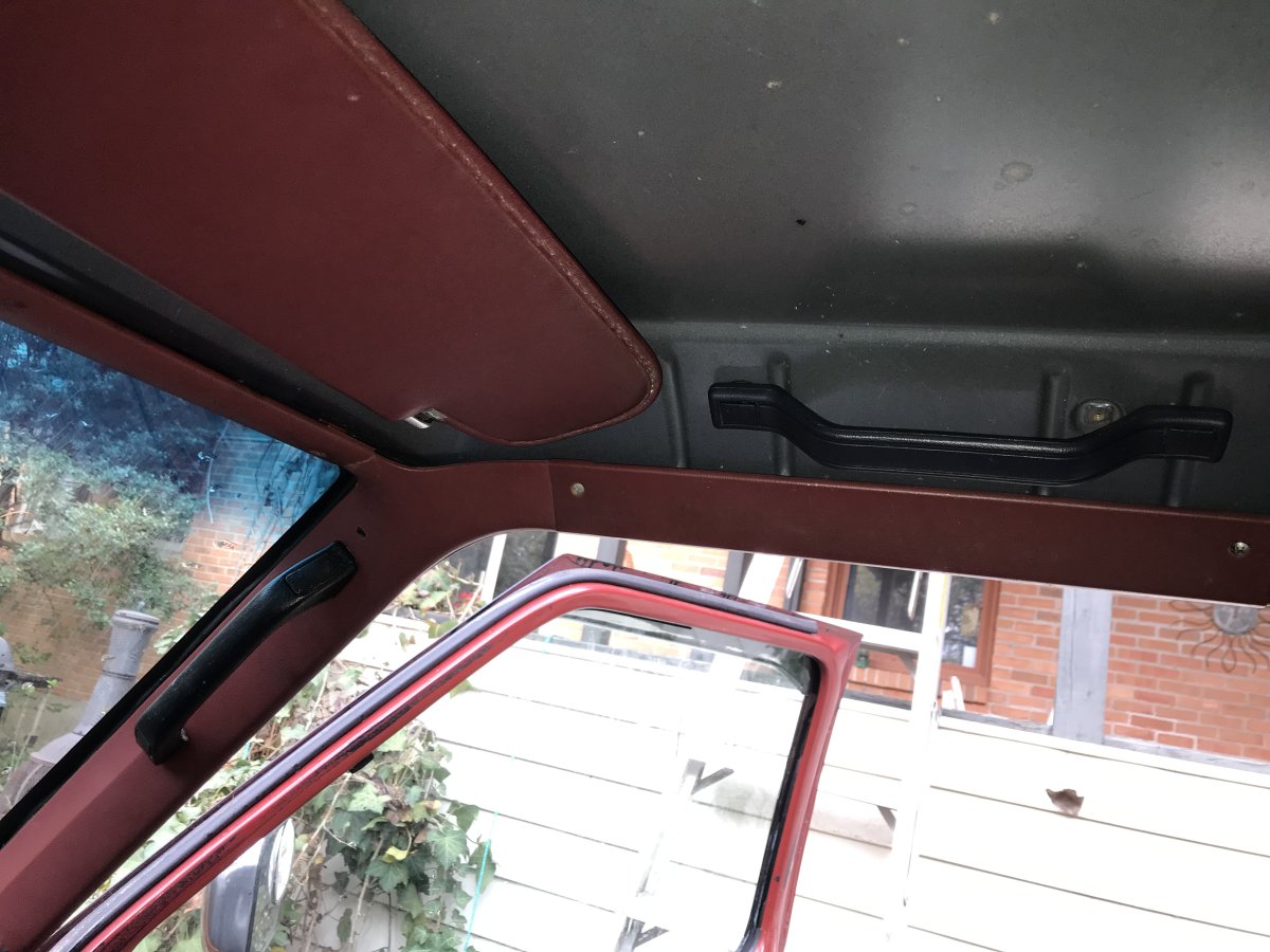

Soooo, today was a honey do day. So I justified working on The Missing Linc and the Road Ranger by installing get ‘er in grab bars for my honey on her side.
Yep, the top one is from a Town Car. The 97 got real Ford handles.
She was not impressed - I’m in the dog house with a much better understanding of what a honey do project is….

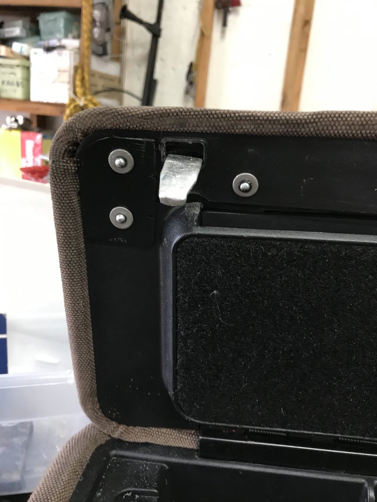

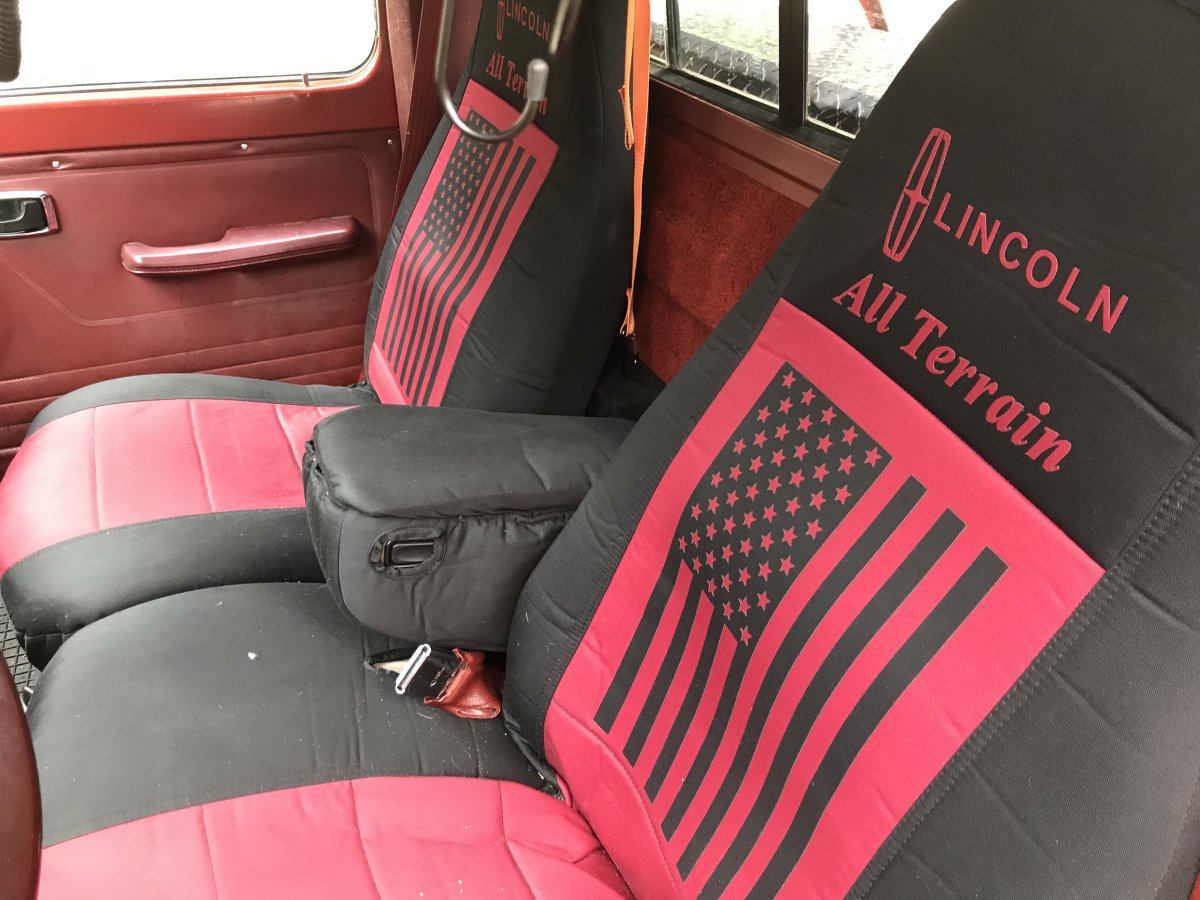

Also, the little tongue/latch that hangs off the bottom of the arm rest lid has been gone for decades, supplanted with a bungee. I got some seat covers, so I figured it was a good time to fix that latch. Turns out the lid was actually cracked in half. I just drilled straight through the padded lid and used some pop rivets to secure the loose piece that holds the tongue. I made a tongue out of scrap aluminum from the shed of miracles. It’s L shaped, I slipped it in between the padded top and inside plastic, and then ran a short self tapping screw into the horizontal part through the plastic.
I also did a patch piece on the inside to hold it level. It looks horrible, but after I put the cover on it, you can’t tell, and like usual, it suits the hell out of me!

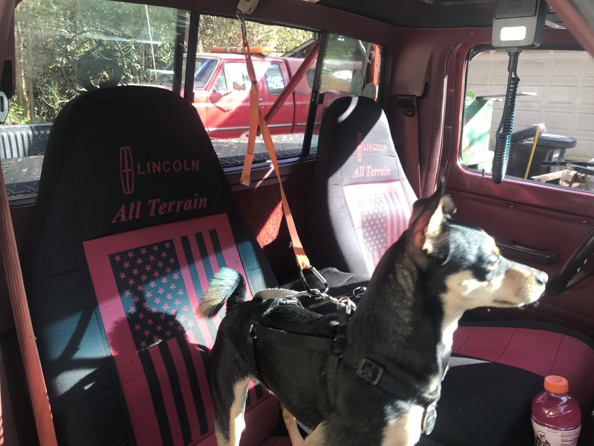

The orange strap is my doggie restraint/collar seat belt. Long enough he can move around, short enough so he can’t jump out or hit the dash. He wears a harness, not a collar. I pulled the coat hook and installed a ring below/behind it, and put the hook back.
Yeah, my dog is named Lincoln too….
