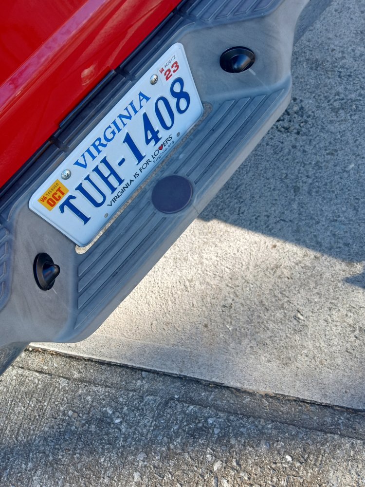

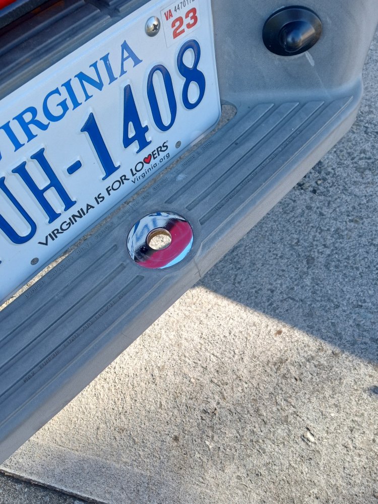

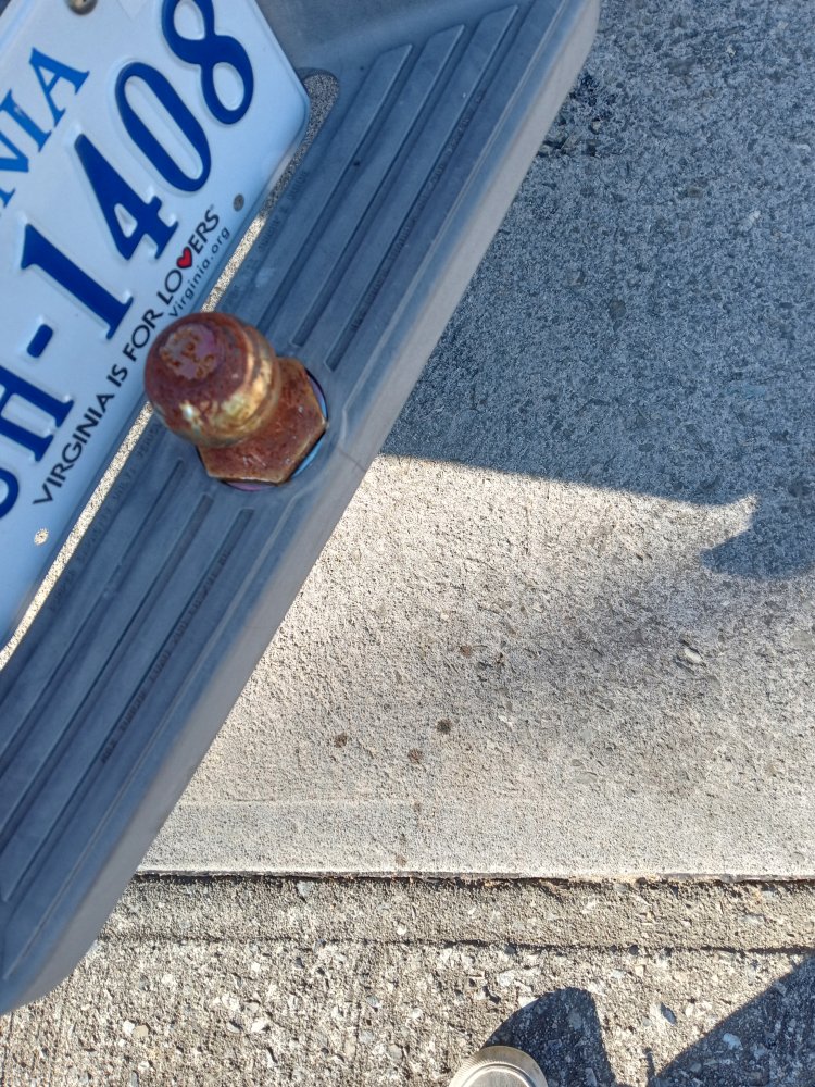

Removed ugly rusted ball which I will never use because if I ever tow anything it'll be on a Class 3 hitch. I have the filler which came with the truck (!) but might leave it out (1) it doesn't go flush, it's larger than the rebate and (2) I hear they get lost so if I do use it I'd attach it underneath somehow, maybe a piece of dowel and drill thru and put a cotter pin or something. I think it looks ok without it. Rear bumper could well get replaced anyway later.
PB Blaster is great, far better than WD40 for loosening up rusted stuff. Got that tip from TRS.
View attachment 89448View attachment 89449View attachment 89450
WD-40 is not really intended as a penetrant for freeing rusted fasteners. Its best use is lubricating hinges and the like.
PB Blaster works, but it seems to be a little thick in some applications. Kroil and CRC Freeze-Off are two of the best penetrants. Kroil in particular has worked near-miracles for me, but it's hard to find on shelves.

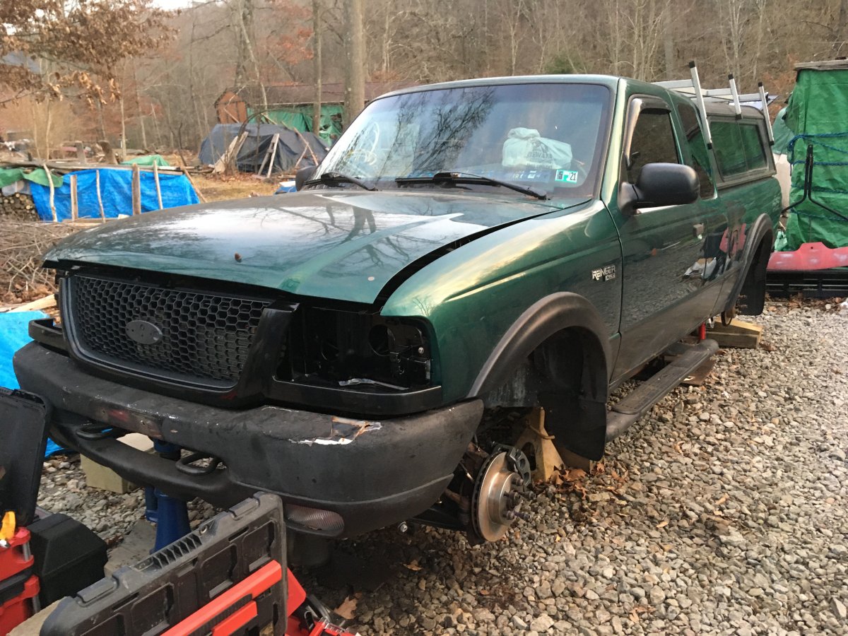

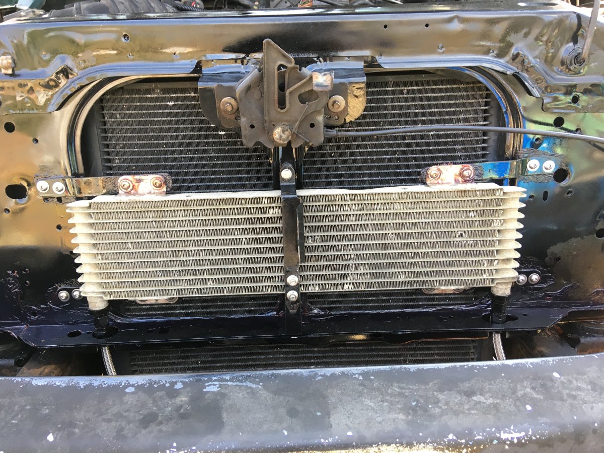

It was back to work on the green Ranger today. Took care of a couple little things, then got the fender liners and front fenders loosely on. For the most part that went well. For some reason they’re making the header panel sit low though and I’m not really sure what’s going on. There might be enough adjustment in the brackets, but I don’t think it’s supposed to be that low. Especially because the grill doesn’t clear the bumper. Again, I might be able to lower the bumper and make it work, but I don’t think I should have to. Gonna have to give it a good inspection when I’m more clear headed.
Hooked up the laptop to bleed the ABS and checked codes. It’s saying a coolant sensor is out of range, despite both being new. Not sure what to make of that unless I have a dead sensor. Also said the intake air temp sensor was not reading. I have a sensor but can’t find a plug in the harness for it. Couple dumb codes (4x4 module can’t see the transfer case). ABS battery voltage too low. Huh.
Tested ABS module. Tests fine. Still a low voltage complaint. Battery at 11.8 volts. Tried to do an ABS bleed. Says activating valves then says that the service procedure was interrupted and stops. Still the low voltage code, still tests fine, still won’t service bleed. I’m lost.
Figure I’ll deal with it later, at least I can put the rear driveshaft in. Nope, because I can’t find my locktite. @sgtsandman , you have any idea where it might have ended up? Lol, I can’t find it. Look under the truck and find a puddle of brake fluid. From a fitting I never touched in this build. All I want to do is drive this thing…

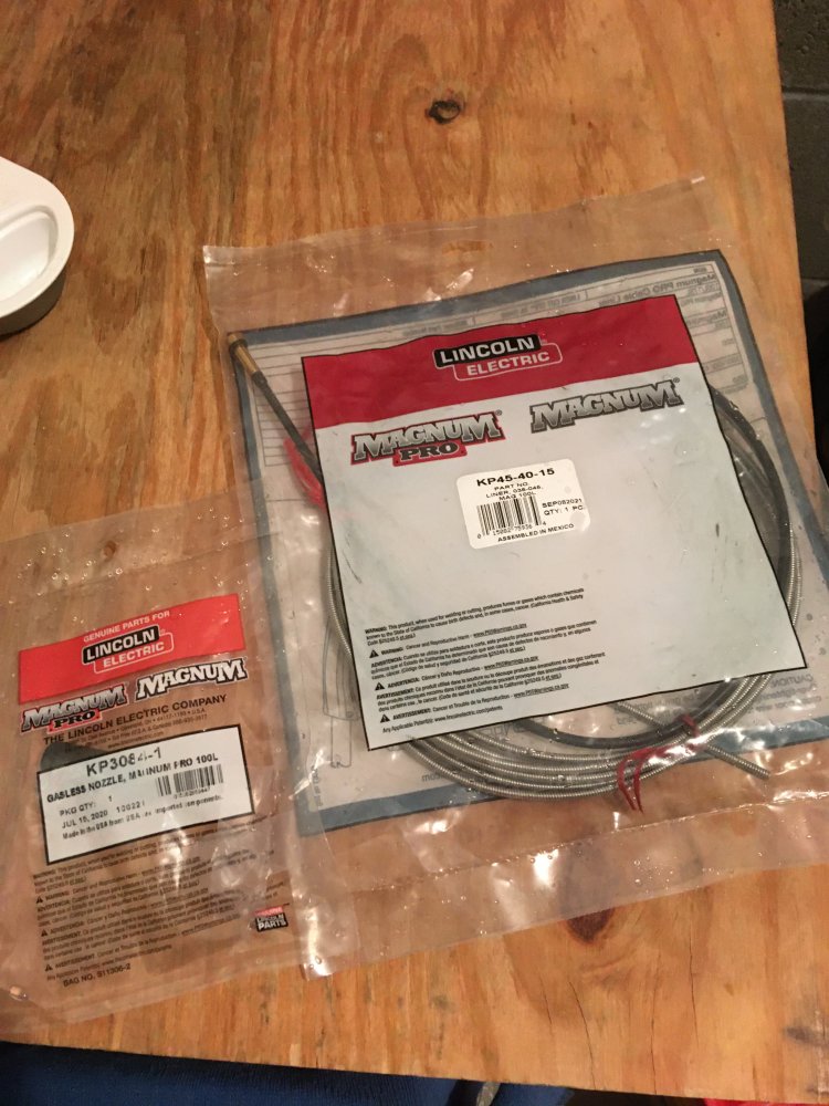

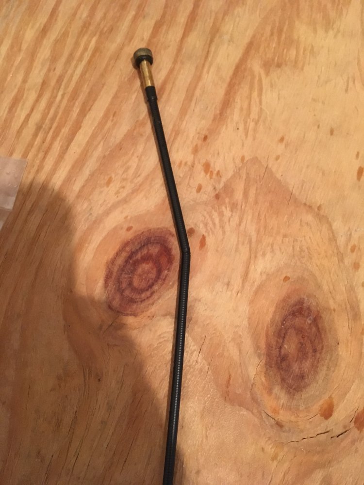

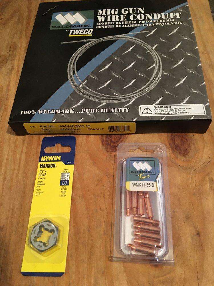

Well, today was a rain day, so no work on the Ranger. Ran some errands today with mom then got to work on the welder. Pulled the wire out and it was a hard pull. Yanked the liner and found 4 minor kinks and one major. Figures. Pull out the new liner and something doesn’t look quite right. Call the weld shop and give them the information and they go, yup, that’s wrong. So another trip back there since I need the welder up soon. Got back and got it together. For the heck of it, I put the new 10# spool in and will keep the little spool as a spare when I run out. New wire fed real smooth through the new liner, so I’m betting it should run nice.
